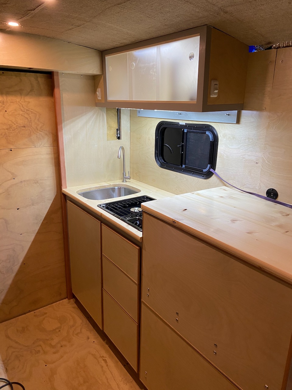

The cabinetry is finally starting to take shape. (Still have knobs, pulls and travel locks to install, however.) The big cabinet will hold a couple of ice chest. Going that route until I have the money to buy a fridge (maybe.)
The big accomplishment is getting the sink installed and the drain and faucet plumbed. No leaks except for the fill port for the fresh water tank where the 1-1/2" hose connects to the fill port at the tank. On my first try, I wrapped the tank's stub with plenty of plastic tape and used 2 hose clamps, but still get a slow drip if I fill the tank completely. Today, I squeezed in a fat bead of silicon and reinstalled the 1-1/2" hose for the fill tank and used the 2 clamps again. I haven't totally filled the tank again, but I'm hoping the silicon will seal the drip. I'm almost certain the leak if coming from the hose connection and not the tank itself.
Any ideas on stopping the leak?

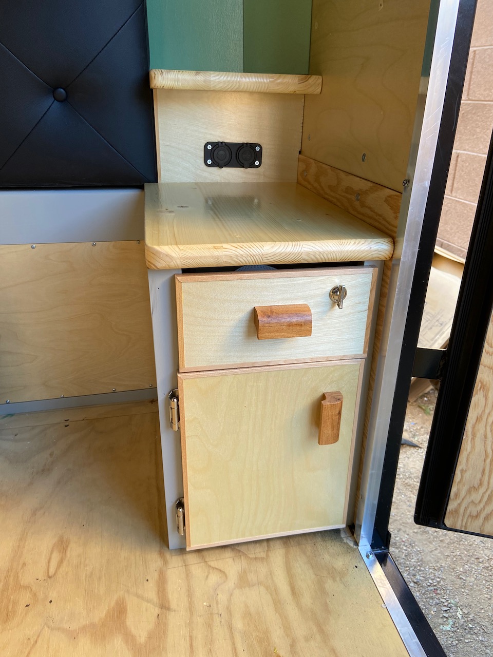

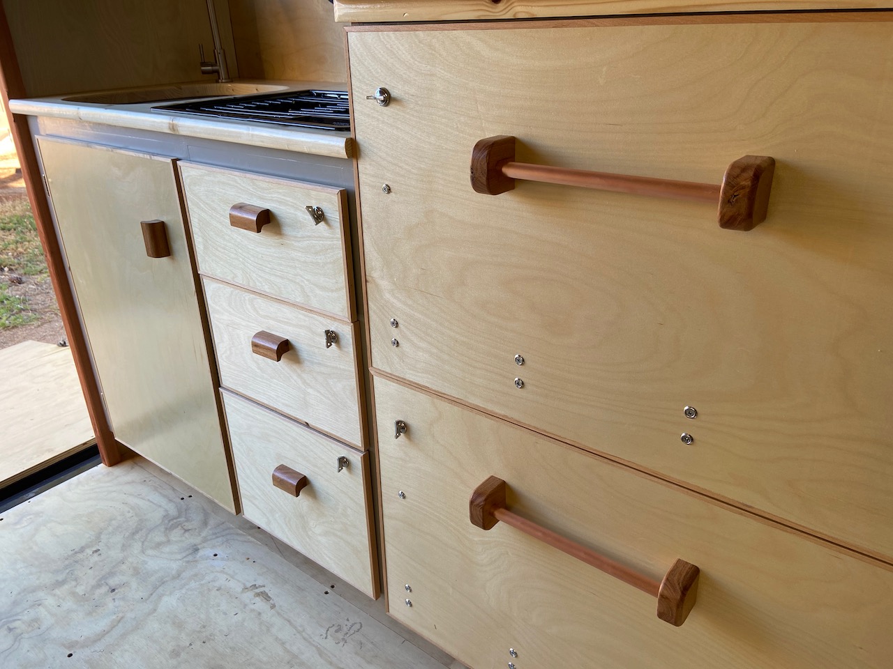

Handles and pulls are made. That's mesquite wood from a tree that fell in the backyard years ago. I saved a straight section of trunk with the idea that one it would make nice drawer pulls.

Drawer pulls and travel locks.
A little utility cabinet for battery, fuse and AC.

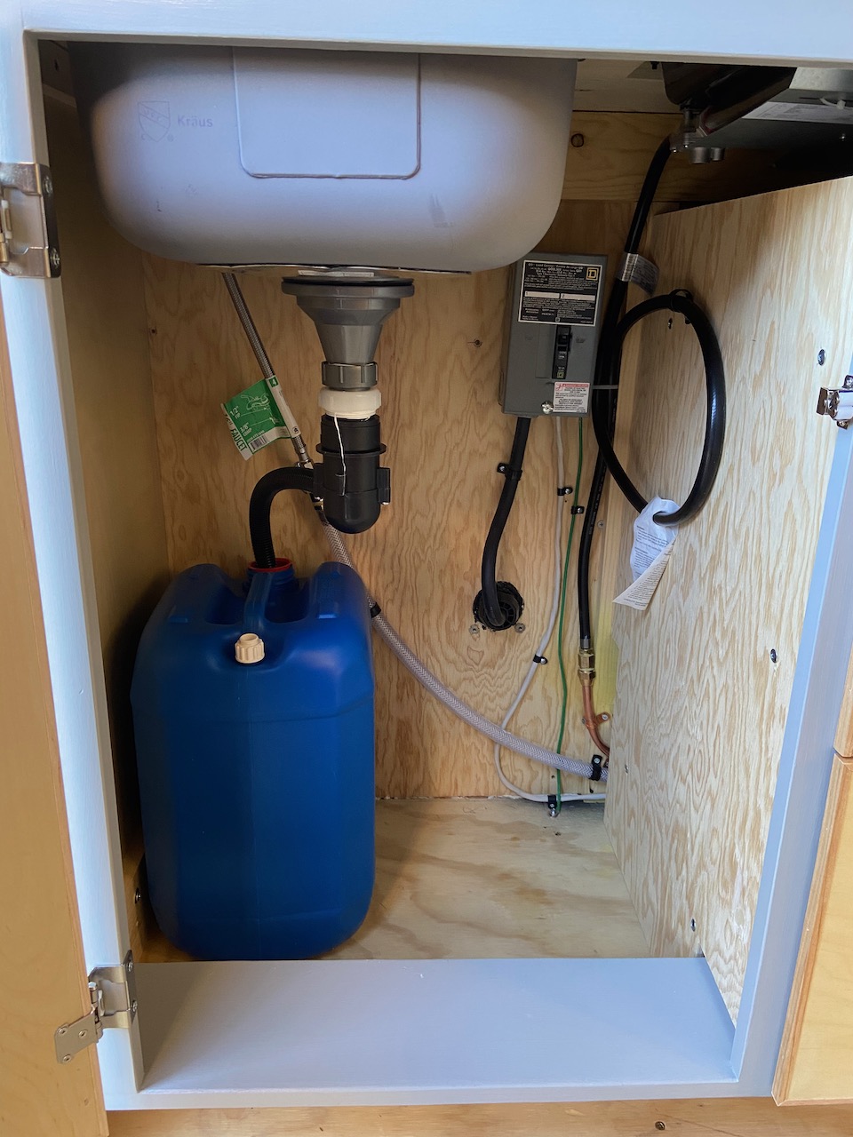

Just a simple system for gray water.

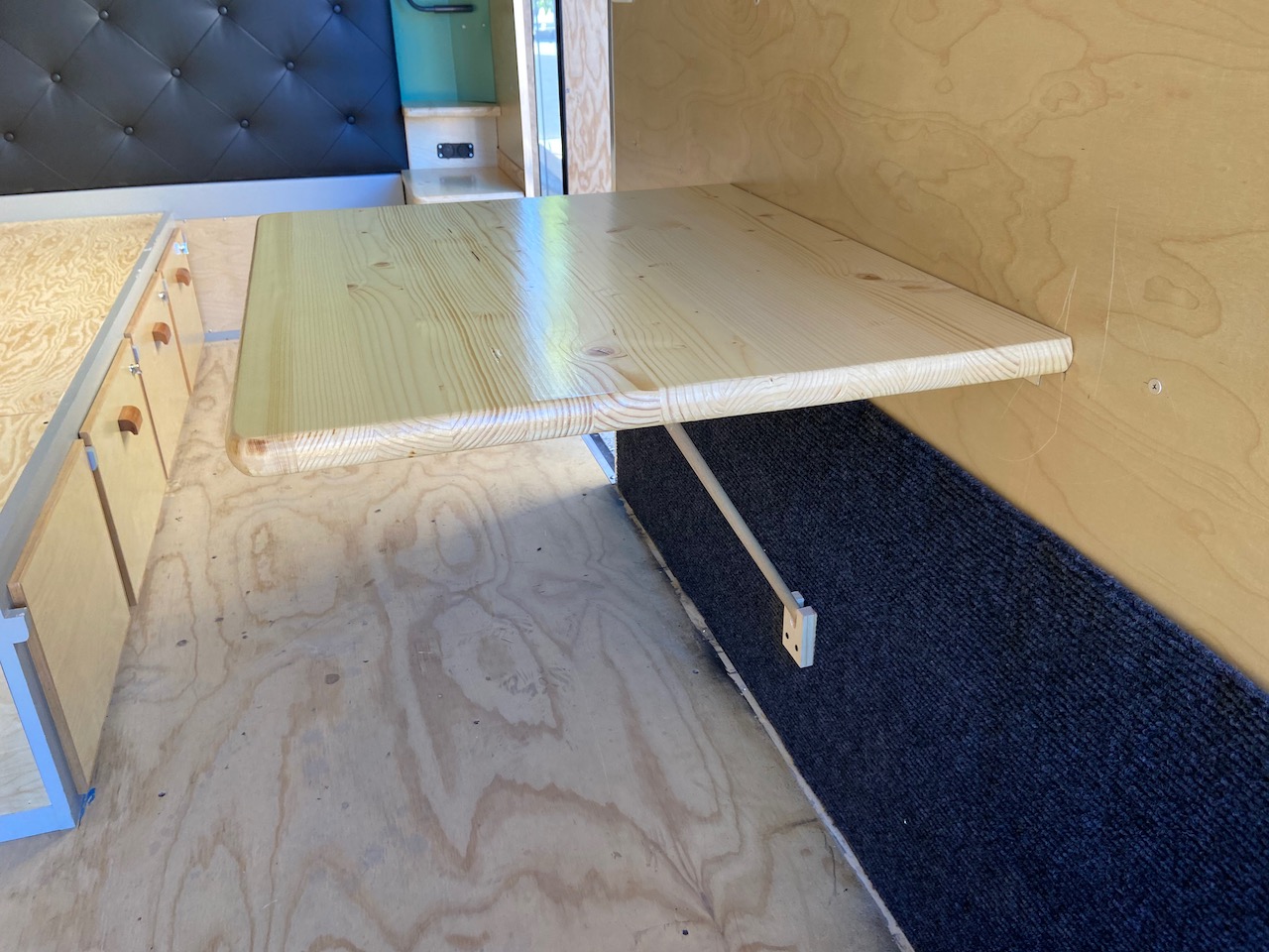

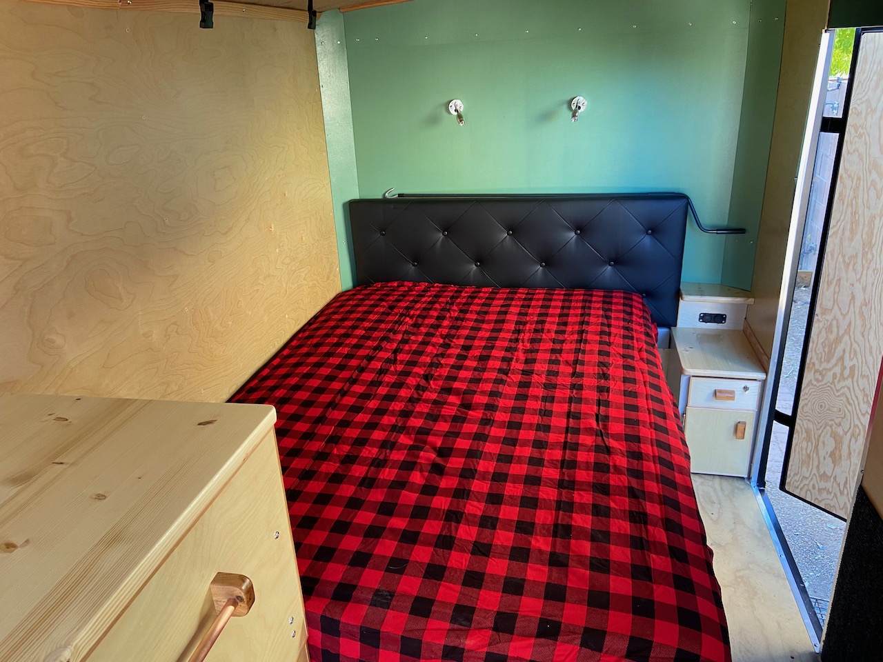

The trailer is NOT finished, yet (are they ever???), but it IS functional. This past couple of weeks, I've installed the bed/mattress, dining table and tongue box that houses the propane tank. That also means that all of the utilities are working, except for one more light that I have to install. I also install a electrical shore connection, circuit breaker, and one GFIC outlet. (That's working fine except for one problem that I'm making a separate post, because I'm not sure why it's a problem.)
So what's left? I have one last cabinet to make. It's a wardrobe cabinet for the back corner. (There will also be a sub-cabinet at the bottom that will hold the porta-potty.) I have to finish the back deck with outdoor carpet, make a screen door for the rear exit, and install the vinyl flooring. However, I'm sure that won't be the end of it, but it'll do for now.
Fred
Bed in nighttime and travel mode. Pretty easy to lift up.
Full size bed folded against driver's side wall. Notice the buckles. Additionally, we have a chaise lounge cushion for the bench.
Flip up table.

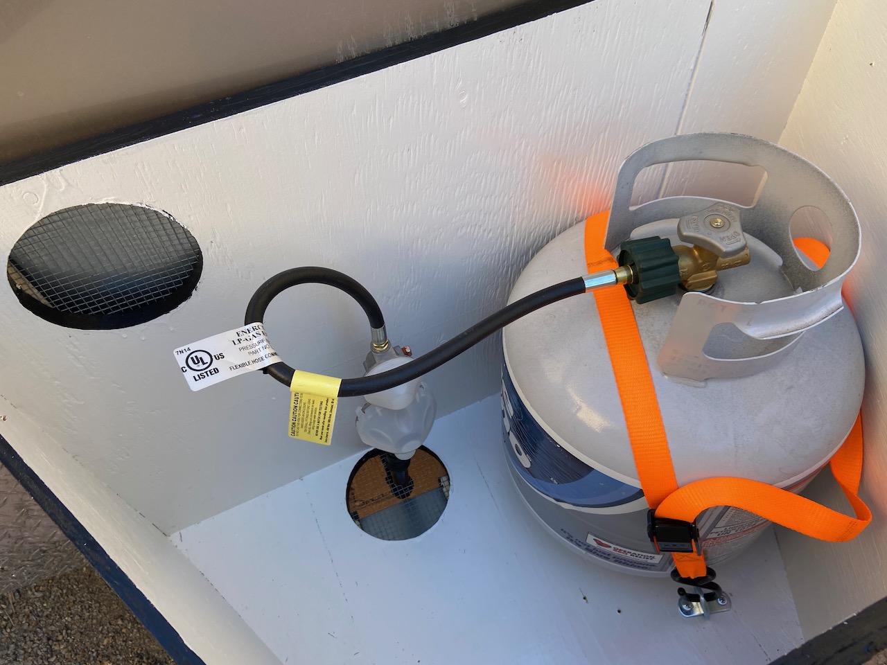

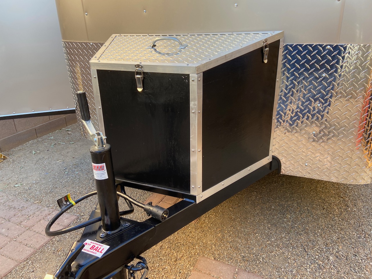

Here's the tongue box. Nothing fancy.
Fred
Tongue box.
Just a propane tank. I made some port holes for ventilation.

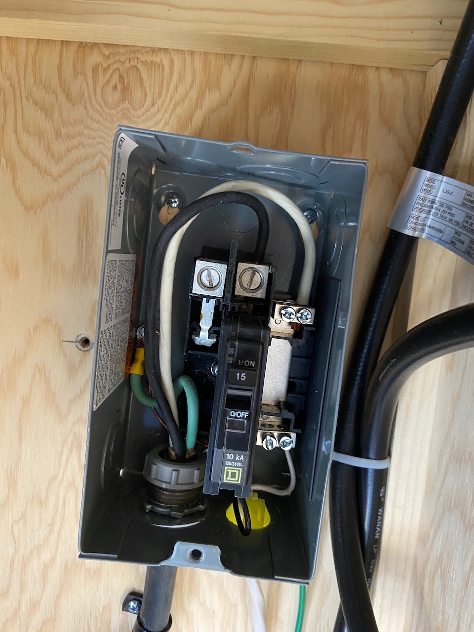

Now for my curious problem... when I hooked up the 7-blade connector to the my truck, the truck's 30A tow-circuit fuse blew. I hooked it a few weeks before after I swapped out the 4-pin factory connector for the 7-blade connector, because I added backup lights. Everything worked fine at that time.
What I did in between was add a 120V shore connection, breaker panel and one GFIC outlet. I also grounded the breaker panel and shore connection to the trailer's frame. The 120V circuit seems fine. My tester shows the correct lights and the GFIC works fine. Of-course the trailer running lights are also grounded to the frame. When I disconnected the 120V ground wire from the frame, I got my running lights back and the truck's 30A tow-circuit is fine. (120V shore connection was DISCONNECTED when I hooked up the trailer to the truck.)
My question is why would grounding the 120V shore connection to trailer's frame blow a fuse in the tow vehicle?
Fred
shore connection breaker panel. The green/ground wire at the bottom of the pic is connected to the trailer frame.

Sounds like power is traveling back to the truck. I always disconnect the 7- plug from the vehicle when parked.
From what I've been told, you dont need the ground to the frame in 110.

Hi, I have an idea that could be causing your electrical problem. The frame should be bonded to the equipment grounding buss in the breaker panel. The ground shouldn't have any current running through it except when you have a fault. I suggest that you check in the breaker panel to see if there is a green screw in the neutral buss, that is the bonding screw to tie the ground and neutral together. In your application they shouldn't be tied together, that is supposed to be done at the service. If the screw is turned in, remove the screw and see if the problem still exists.

This is a follow up, I just got a better look at your breaker setup. I can't see any point for bonding the neutral and ground in your panel. What I said in the other post doesn't apply to what I'm seeing here. Just make sure the neutral isn't bonded to the box. Sorry for confusing the issue.

120 volt shore power was disconnected before I hooked up the trailer to the truck.
Could it have something to do with the GFIC outlet that I installed in the trailer?
I think I'll just pull the ground wire from the breaker box to the frame.
