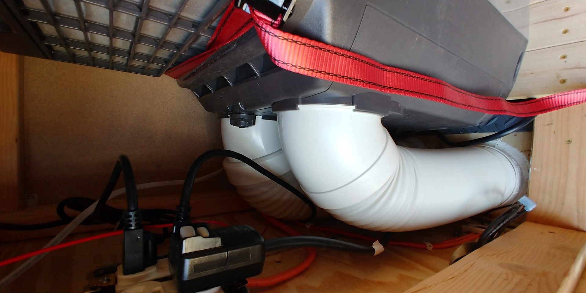

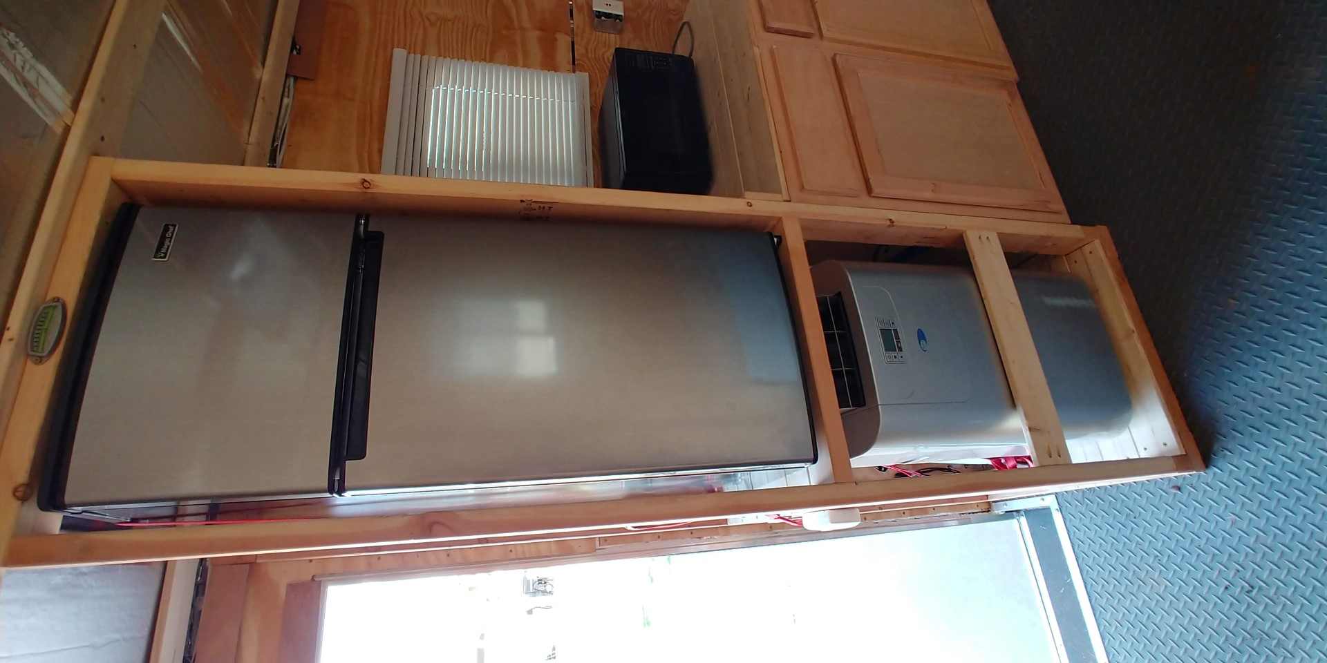

Postby ISOTNT » Sat Mar 20, 2021 8:43 am
Just an update that we took a quick trip with the dirt bikes to try things out a bit and the dual hose AC froze us out. Now, granted it only got up into the 80s outside, but I set the AC to it's lowest setting at 61 and it pulled that CTC right down to a very chilly 61 by the time we got back from a ~2hr ride.
Please forgive the crudity of the install so far, as I just had to get something going for the trip.
Dual Hose AC(Large).jpg (266.09 KiB) Viewed 1041 times

Postby flboy » Sat Mar 20, 2021 2:34 pm
Glad it worked for you. I'd expect the dual hose to preform well. Really is no different than hanging one out the window or building into a cabinet with outside venting. It is the single hose systems that do not work well.
My only problem early on (besides the floorspace it took up wiht hoses and etc.) was that I could not find a dual hose system below 8,000 BTU (10,000 +) seemed most common) and one that would run from Eco Mode on a Honda EU2000i. Other than that... why not. :thumbsup: :thumbsup:

Postby ISOTNT » Sat Mar 20, 2021 3:15 pm
Yeah, I expect that it might not run on a 2000 with compressor surge current along with other draws. I tested with my 3500 and it's just fine and runs at ~750w with compressor on. The 3500 running in eco gives a very small rev when it kicks in, but nothing significant. I agree it does take up a lot of space, which is probably the biggest downside. But, on the bright side, it is much quieter than the roof units I had in my 5er when I had that and can be used as a dehumidifier with permanent drain in the winter months, so we'll see how that goes.
