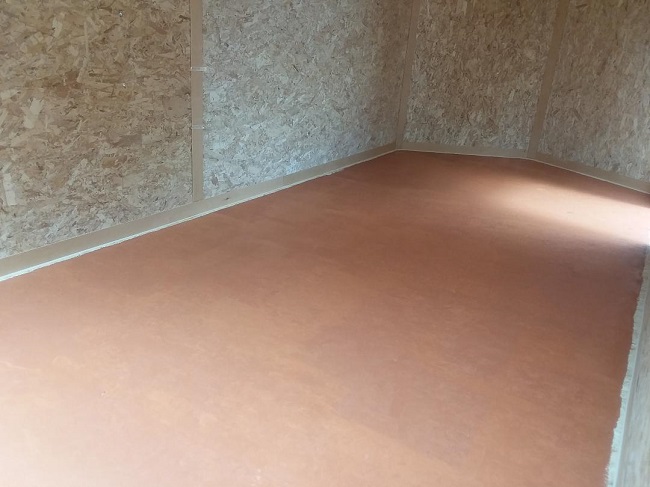

Just today Cindy painted the first coat of porch paint on the floor. Very happy with the Terra Cotta color. Accents some of the wood chips in the OSB walls. Both of us like the random look to the OSB walls. The walls will get a couple coats of honey tint polyurethane. For their final finish. I painted the first coat now to seal the floor. I'm working on a gravel/grass driveway. You can't help tracking in dirt on the raw floor. So this will seal up the floor during construction. Floor will get cleaned and final paint coat when interior construction is finished.

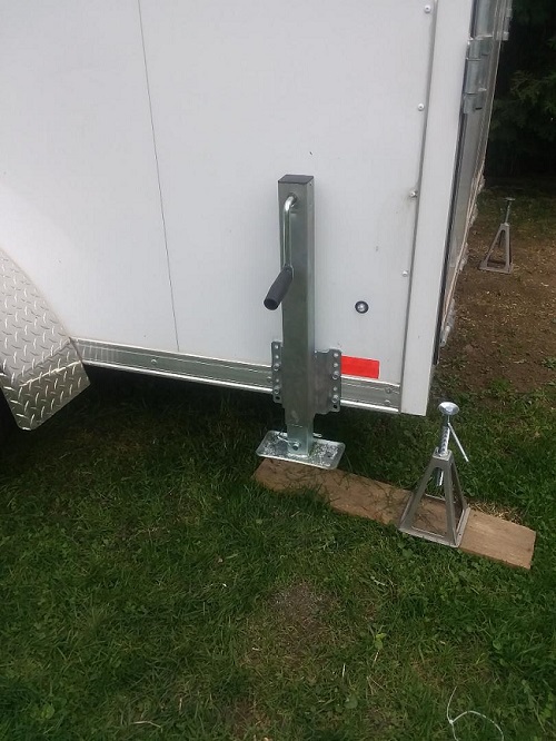

Also mounted 2 @ 2500lb tongue jacks to rear of trailer. They are bolted into frame with 3/8" thread cutting bolts. I will be able to use these to level up the trailer in all but severe cases. If it's too bad I'll pick another spot to camp.

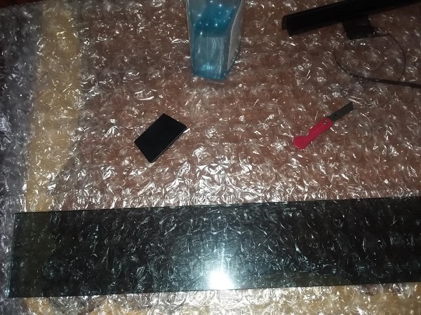

Some limited progress. Weather has been too nice to work. Got some small things done here and there. Removed the wall panels on one side. Looks like I've had some luck with trailer panel fit. Don't see much in the way of gaps. Or exterior panels that have gaps. Laid out where the first window hole will be cut.
Before I could assemble the jalousie window for install, I wanted to tint the panes. So, I've been spending some time there.

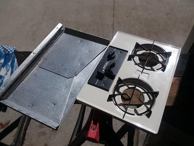

Got some more time in on rust removal on the bed lift parts. Parts arrived to convert the propane stove to use 1lb bottles. I had not yet tested the stove. So I opened it up to change the LP fittings. Found a mouse nest the size of a softball. Cleared the nest. Stove tested fine using the 1lb bottle. So began to clean and disinfect it. Took some doing. Came out looking great.
Tomorrow I'm going to start building the framework to install the first window with. Should be able to finish the rust remove and painting of the last of the bed lift parts too.

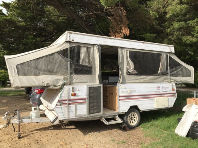

Postby Vnose » Tue Jun 28, 2022 11:58 am
I'll be following your build. Mine is a 6X14 V Nose with a single axel. A king size bed sounds great if you can live with it and as to the elevator rig, you might consider using tracts and wheels from a garage door shop. That can keep the bed from moving in all the wrong directions going up or down.
I'll be rigging up fold down beds on both sides. At my age I have those nightly trips and trying to crawl over someone isn't easy. One RV tip I saw, which makes sense, is not to put your ceiling vent fan directly over your bed, it is possible to wake up and wonder about who wet the bed. :oops:

V nose- Thanks for the input. I'm safe with roof fan location. The trailer rafters are framed for the fan well ahead of the bed. So all is well.
I think I will be good with the stability of the bed as it raises and lowers. I'm using the complete system from a pop up camper. It has 4 telescoping corner posts that locate the bed ( old camper roof) and guide it straight up and down. Pic below
lift posts.jpg (68.53 KiB) Viewed 863 times
So if you imagine all the canvas gone you have 4 posts left. Plus a platform/roof raised in the air. My bed frame platform will be 3 ft shorter (so lighter) than the camper roof was. In addition to the shorter length the bed platform will be made from lighter materials as well. Plus many of the pop up campers used roof top RV style A/C units too. The system lifted that fine as well. So even a foam mattress on the platform should lift just fine.
Next hurdel was getting bed to drop low enough for easy entry exit. I do not want to climb up to get in bed. You will enter exit bed from foot end. So i plan to build some Gondola shaped bed side rails to add to the drop of the mattress. My trailer is a 7' tall model so I will be able to lift bed high enough to have good clearance under raised bed. A butchered photo to show the concept planned.
That's my theory. Sometimes practice/reality varies greatly from theory. I hope not this time.

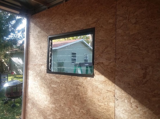

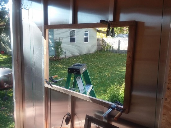

Postby Mr. Lahey » Thu Oct 20, 2022 12:49 pm

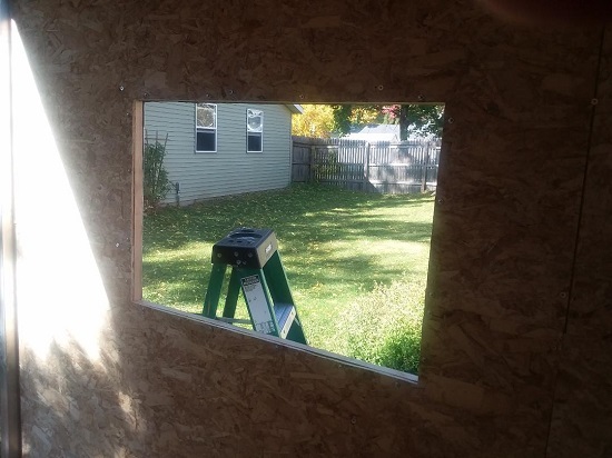

Finally knuckled down and got a window installed. I'm happy with the result. Several more to go. Just not until spring.
Built frame from some recycled pallet oak beams.
My teardrop camper build journal: http://www.tnttt.com/viewtopic.php?f=50&t=64721

Postby hankaye » Fri Oct 21, 2022 6:53 am
Mr. Lahey, Howdy;
Congrats on the install. Appears to be a louvered window. I like them.
Allow you to get some ventilation should it be raining.
:thumbsup: :thumbsup:
