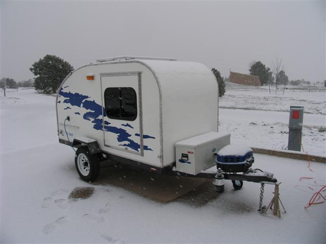

Postby bdosborn » Fri Aug 19, 2022 8:30 am
I think it depends on what kind of weather you plan on camping in. I camped in mildly subzero weather in my Teardrop once. It had 3/4" of side insulation and 1-3/4" in the roof. It got pretty chilly that night, even with a 1500W heater running full blast. On the other hand, I know some California campers that are happy with plywood only walls. My standy has 1-3/4" insulation in the walls and 1-3/4" in the roof. I'm pretty sold on wall insulation after camping in weather where I needed every bit of it.
2009 6.5'X11' TTT - Boxcar

Postby bdosborn » Mon Nov 14, 2022 7:14 pm
3/4" in the wall, 1-1/2" in the roof and it was barely enough in 0F weather. And that's with a 1500W electric heater running almost non-stop.
I'll scrimp on some things but insulation isn't one of them.
