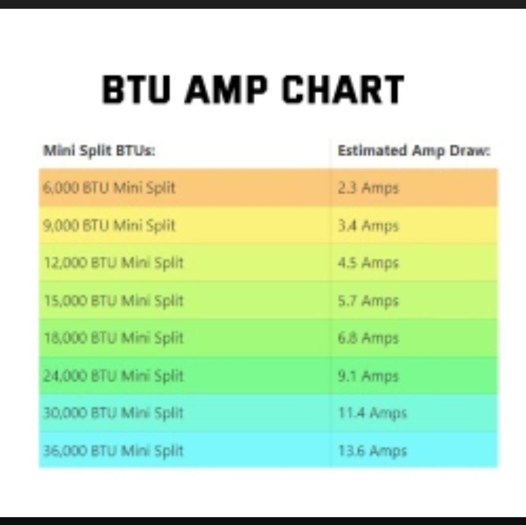

From the research I have found, it seems like you are way off on the amp draw for mini splits. I don't doubt what you say as far as window AC units but it looks like mini splits draw far less than those. Take a look at just one web site I found.
https://learnmetrics.com/how-many-amps-does-a-mini-split-use/
Looking at this, I could easily get away with a 9000btu or even a 12000btu setup without depleting the batteries too quickly. And this is only one of a number of sites that confirm similar results.

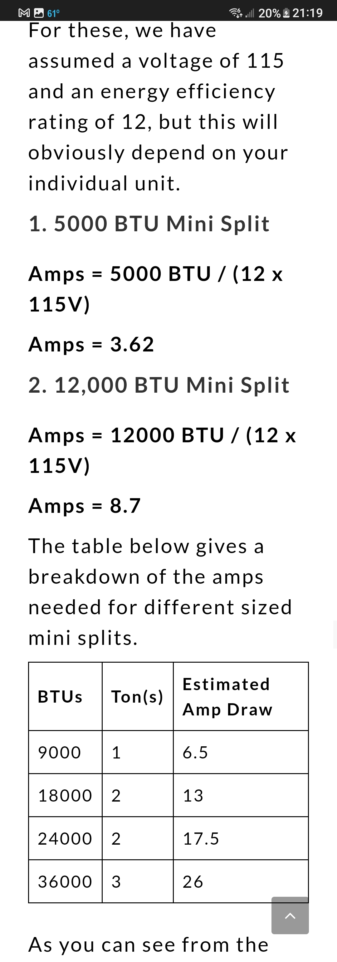

Are all those amp draws based on 220 volts?

Ok, I found this page that specifically gives amp draws in various voltage. Here is what I found for 115v
https://airconditionerlab.com/how-many-amps-does-a-mini-split-use/

Those amp draws stumped me at first too, but I think he's right. I think my 5000btu window shaker (which is plenty for my 6 x 12) pulls just under 40 amps FROM THE BATTERY when running. It's like 400 watts on 120v, but with the 12v math involved, it is near 40a,
I only have 200ah of battery and 400watts of permanently installed panels. I can hold my own if I plug in 200 more watts in good sun, but it is not something I bother doing. If I know I need the genset along, I take it and it just idles along quietly.

mikeyk101 wrote:... featherliteCT1 is ... basically saying that there is a bigger draw when using a mini split than those Window AC units
To clarify, I was not saying that a mini split is less efficient than a window AC. I was just trying to point out that I think you were underestimating the number of amps that are required to run an air conditioner, mini or window, when drawing from a 12v battery utilizing an inverter.
Please keep us updated concerning your planned electrical system. :thumbsup:
