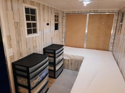

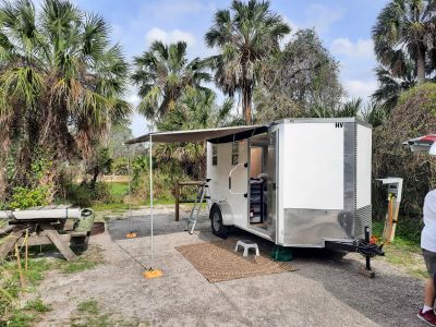

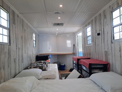

Hello Cargo Trailer Campers,
Here is a brief follow-up to our project. I went with pre-finished wall coverings and ceiling panels. Just didn't want the hassles of painting. Recently installed a grab bar on the outside, a fan kit that turns your own fan into a nifty exhaust/inlet fan (really works well!) We installed a 7X10 Dometic bag awning that was a new old stock from Hanna Trailer Supply. It worked well and withstood a Great Deluge on our last trip. I put a dimmer in for the puck lights, a solar input into the battery to keep it charged during the times we are not using the trailer. A portable 50 watt panel does the trick! I am using a NOCO 10 amp battery charger for my power supply while at the campground for the interior lights and the porch light. It is doing a good job keeping up with power demands, even when using the exhaust fan. The little 3.2 CF single door dorm fridge (from WM) keeps the food cold and even freezes ice when needed! I will attach a few pics (what a pain to down-size them!) so you can see a few of the things we have done. Nothing elaborate for sure, but the goal was to try and keep it simple! I must say though, the 6" foam mattresses are really comfy!! Glad we splurged on a queen size mattress then cut it into 2 comfy mattresses (used an electric carving knife!!).
Enjoy the pics. Go easy on us with your comments, please. Happy Camping!! (BTW, I should have had this at the bottom of my posts...sorry!)

Postby CampingCur » Fri Mar 29, 2024 9:15 pm
The awning is a Trim-Line bag style awning from Dometic. It is the 10' version. Got it on e-bay for 299. (Amazon had the same awning at that price as well). They were closing out this color (Brown Fade). They seem to have sold out this size, but they do have others like 8' for that price. The seller is Hanna Trailer supply. It was new old stock. It was in good shape, still in original box. Shipped free and they got it to me in less than a week! All the legs are now folded inside a boxed aluminum frame. They fold out and you can attach the bottom of the legs either in sockets mounted to the trailer, or simply place them on the ground and pound in a stake in a loop to hold it from flying up. If it is real windy, we also stake it with additional ropes. I need to drill additional holes in the support legs so that the ends can come down even more in a hard rain situation. We had a torrential downpour the first time we used it and I had to push up on the canopy to move the water off. So glad it did not damage the fabric! It is a medium/heavy vinyl.

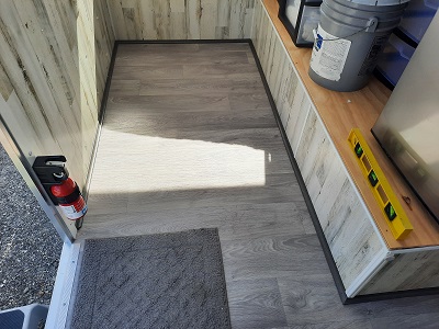

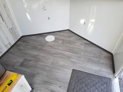

Postby CampingCur » Fri Apr 12, 2024 9:43 am
Here are a couple of pics of the sheet vinyl flooring installed. I made a template (of sorts) from cardboard and laid it out on the vinyl first, with 2 inches over on all edges. That did minimize waste. The portion that I cut off under the longer bed on the side I used under the rear storage area. The scrap pieces were used under the long bed. Very little waste by using it this way. I wanted to have the pattern go the long way but I would have had to order more than I needed. This is HD 10 mil material, sells for 1.33 per square foot (about 12 bucks per yard). Again, feels nice underfoot and seems like it will hold up well. All of our previous pop up campers had vinyl flooring and it held up well with minimal care. I did end up stapling along the outer edges. Then, I used some pre-finished grey trim they were closing out at Lowes for 4 buck for a 8 foot piece. It is cove molding, but it looks fine and covers the edges and the staples. Will test it out next week on a camping trip. Happy Trails to all!
