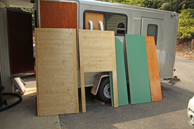

It has been almost a month since I posted updates. But I have been working hard trying to fit in work on the CT and all the other things that life throws at you.
I have just about finished all panels and here are five ready to be mounted inside.
The shower walls with wood trim taped on to see how things go together.
I was able to fabricate a slot for the shower wall to slide over the shower pan riser.
This is the back inside wall.
And the Galley wall from the outside.
The holes are ready for the AC duct work.
Edited to increase size of photos

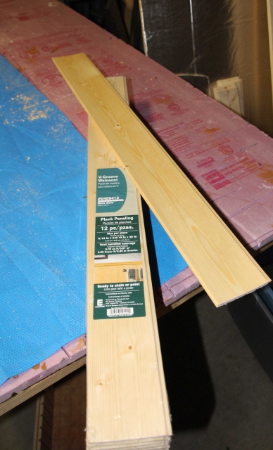

Busy stealing ideas from your build... What is the wood treatment on your back wall? Real wood? Laminate flooring? I am installing a screened, framed in port in my back wall (with a cover of some sort when I want to seal it up... Seems to really let the light/air in.)
Thanks.

Postby lrrowe » Sat Aug 29, 2015 7:47 pm
As others have mentioned before, copying ideas is a great gesture of flattery.
I got the planks from Lowes. They are 32" long which was perfect for me as it left very little waste with my design. They did have 8 foot lengths which I wish I had used on the other wall surfaces seeing how these turned out. They are glued and braid nailed to a 1x3 " skeleton with foam for insulation. There was a little cupping, but not so much as to bother me. It sort of added to the rustic feel or look. I laid all surfaces on the floor with heavy weights on them until the TBII glue dried.
Bob
lrrowe
