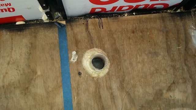

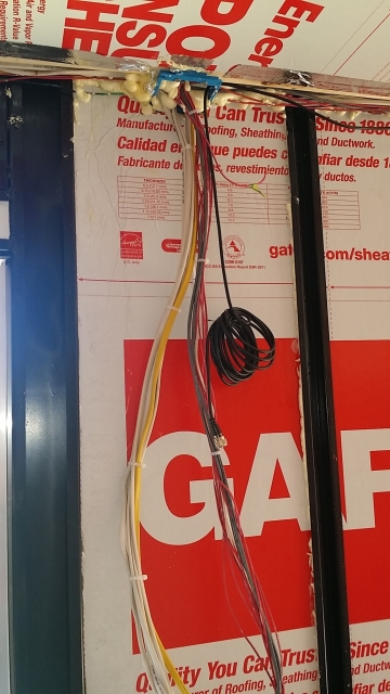

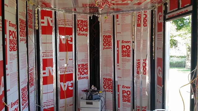

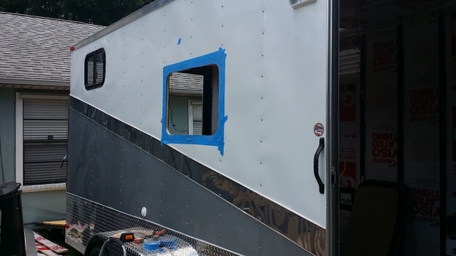

I took time out from finishing taping off and sealing the insulation today to cut the last major holes in the outside. I put this off as I was real nervous about the size and placement. I finally built up the nerve to cut the big hole! Today I installed the Emergency Exit/ Dining Table window. Also put the right side gravity feed water inlet, and the External TV antenna Jack in (now's the time to put the wires in the walls! :-)
You can see in the last picture, I have quite a few wires installed. The bundle on the left is the 110VAC and the Bundle on the right is all the 12VDC and low voltage wires. They are all home run to the place where the electrical cabinet will be and in the walls/ceiling out of sight. The solar will drop in up top and the batteries will be below.
I was going to start paneling tomorrow, but I just realized if I am going to take the floor up to paint the chassis, I need to do that first. Also, while the floor is up, I need to finally bolt in the tanks. I've been putting that one off.

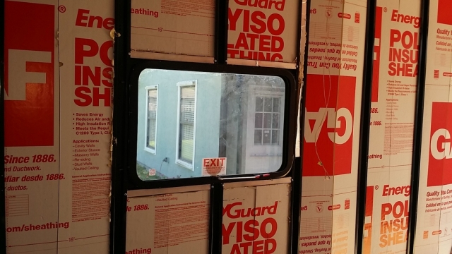

It is really a good idea to have a second way out in case the door get's barricaded, jammed, or something strange like that. I hopefully will be able to find a screen for this window. This was an E-bay auction window ($8.00) and there was no screen. It opens nicely and is also hinged so you can climb out of it.

Postby McDave » Thu Jun 02, 2016 7:44 pm
That emergency egress window is an excellent idea.

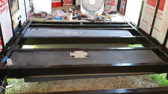

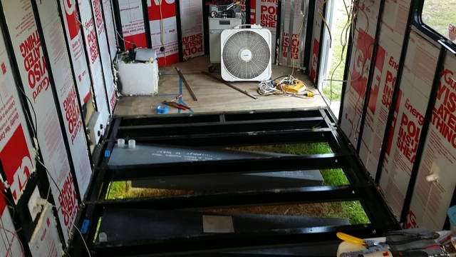

Got the floors over the tanks out tonight. You can see where the tanks will go. I kind of have them set in there. I'll paint up the frame a little better, build the holding brackets and close it back up tomorrow if all goes well. :worship:
I do need to move the vent and intake over on the Gray water tank. I'll just cut off the existing risers , glue over a piece of plastic materiel and the cut new ones. The tanks aren't under pressure so no problem doing that.
You can see the gray water tank right under the outside shower housing which will open up underneath the vanity in the bathroom where hopefully I'll have enough room to connect this all up and make it work. I'll bring the kitchen sink around under the stove and tie into the shower drain.

McDave wrote:That emergency egress window is an excellent idea.
Like I've always said "Safety Third"
McDave
I needed a window there anyhow and I had this from an old E-bay auction win and I never installed it in my old CTC...So here it is. :-) I am trying to find a screen for it. That would be super!

If you got some dimensions I'll keep my eyes open for one. Inside screen?

It is a 30x20 but I am not sure if the screen is special for the emergency exit window versus a normal 30x20. In any case, thanks.

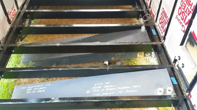

Well the tanks are fastened in. I have some 2" grommets arriving via Amazon tomorrow that I need to install on the grey water tank. I am moving the inlet and vents over. I'll also seal over the two existing holes where I cut the pipe flanges off.
I should be able to close up the floor early tomorrow and start getting the paneling back in. Yay! These tanks took a little longer to install than I expected, but it is my first time and I have no idea what I am doing. :lol:
The tanks all had the "ledge" on the end to hang the tanks. That made it easier to mount. I painted all the hardware up well to help keep the rust away... even though I used stainless hardware. :-)
I added a center brace on a "hanger" this evening after I thought I was done. . I didn't like the way the tanks flexed a bit when full (filled them up to test). Over time, I suppose it would stress the plastic and lead to cracking. It was easy thing to do while the floor is out and cheap insurance.

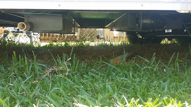

There are the tanks.... all in. :applause: I still have to connect up the external hookups.. but that is the easy part. :) I was noticing how easy it would be to insulate the floor. I may have to glue some styrofoam panels on there before the winter.
A closeup of the blackwater tank vent tube. I'll connect this up to a 45deg. take off to the wall and then up an d out the roof (yes, one more hole I forgot about in the ceiling). I'll cut the hole for the toilet when the walls and etc. are in and I have the exact placement.
