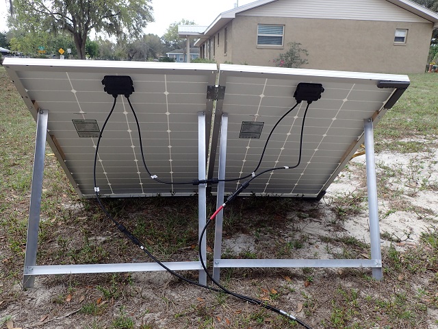

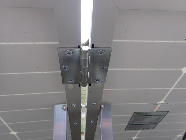

Thanks featherlite for your response. Just finished building and testing a "solar suitcase". Thanks to those on this site that posted about solar. After some YouTube research we chose our components. HQST 100 watt mono-crystalline panels $164 shipped. Rich Solar MPPT, 20 amp controller, $90. Renogy 10AWG Adapter kit,40 ft long $38. I then taped the 2 wires together. If I did this again I would just purchase a 10 AWG extension cord and get connectors separately. These wires will not be out 24 hrs a day in the elements on a roof of the trailer. The extension cord would be much more flexible but would cost more. Surface mount 25 amp circuit breaker $21. Two pin bullet quick connect 10 AWG connector(pack of two) $15. One inch aluminum angle from Home Depot and screws +nuts. Not sure what this cost.

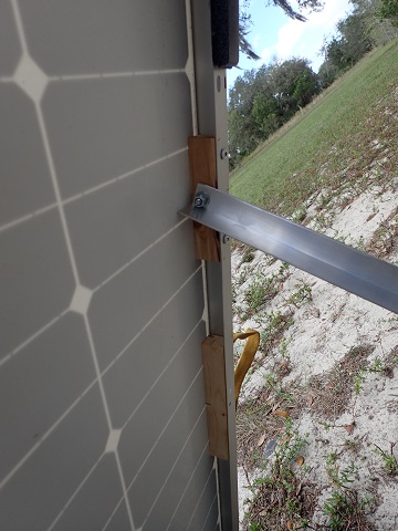

Here are pics of the panels and the adjustable brackets to hold it up. I backed up all the attachments with small blocks of wood to help support and stiffen the panels aluminum.
Close up of Hinge
Close up of Leg attachment. The leg attachment cannot touch the panel as you raise and lower it. You have to attach the leg about 3/16 of an inch above the back of the solar panel.

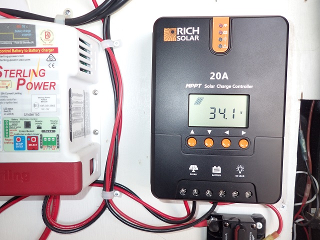

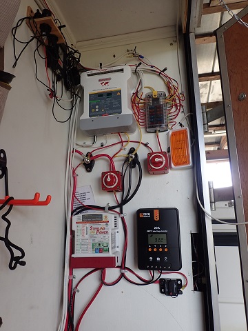

In our trailer we have a utility room in the back 2 feet of the trailer. There is also some storage extending another 2 feet forward past the utility wall under the bed. All our electrical is on the passenger side of the trailer except for the 30 amp hookup to shore power. All positives and negatives are hooked somehow to the two studs located below the battery charger.This is where the Rich Solar 12/24 volt controller is hooked into the electrical system also. There is a 25 amp breaker between the solar controller and the rest of the electrical system located just below the Solar Controller.

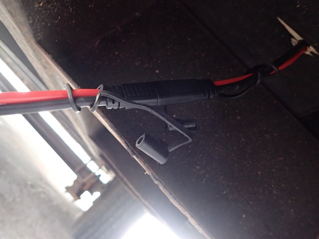

The positive and negative wires run through the bottom of the trailer from the controller input where they terminate in a 10AWG bullet quick connecter. This connector is up inside the floor frame members so we can quickly hook up the solar panels.
The two solar panels are hooked up in series so the voltages are added together. Here is the actual volts on a cool partly sunny day in Florida in February. 34.1 volts at 4 amps.
I am not sure how all this solar stuff works but I do know that with this setup my 450 amphour battery setup will charge from 92 % to 100 % in just over 2 hrs on a sunny day. I know the hook up is correct just not sure of this volt, amps, watts and amphour stuff and exactly how they relate. If I am in left field let me know. My batteries have been fine so far. Thanks for your comments

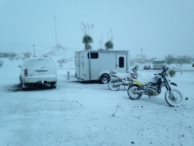

Postby TossingLead » Fri Mar 20, 2020 8:47 am
Big Bend 2015
