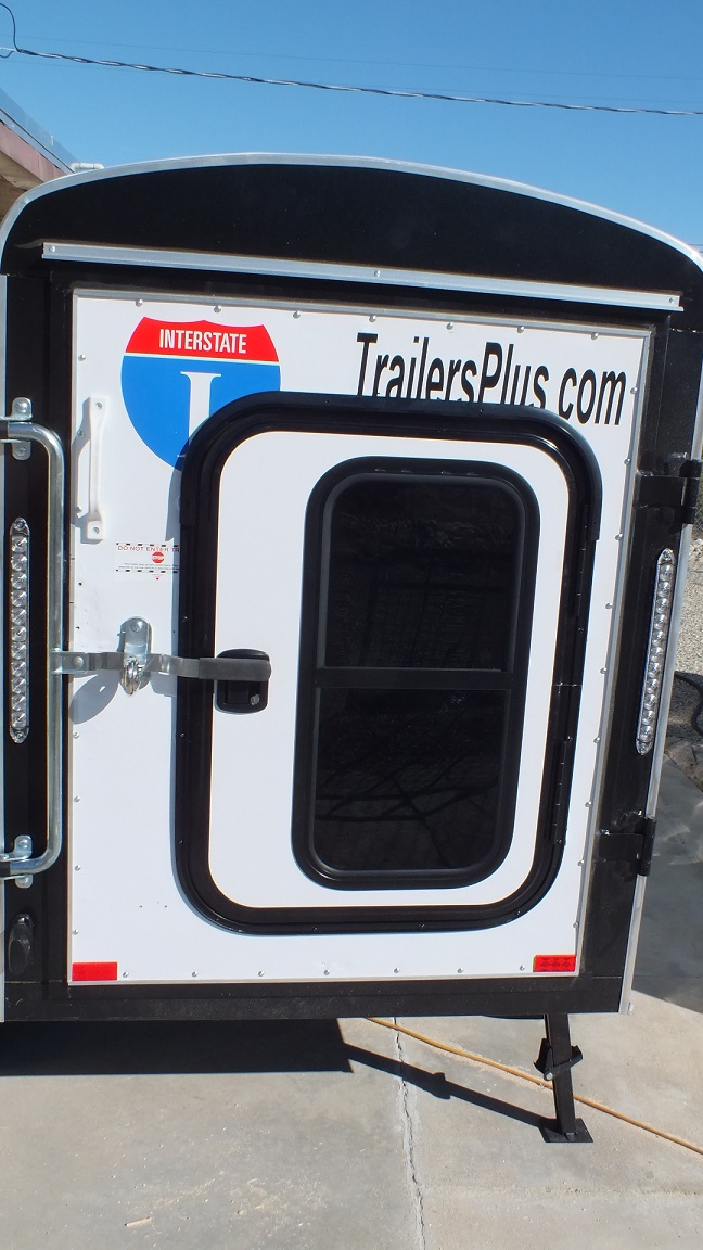

Hank, Today it seems the Gremlins were away. Took me an hour and a half from drilling the start holes for the jigsaw, until the inside trim ring was done.
I still need to install the drip guard. I am assuming I use the Butyl tape to seal the top edge of it. then screw it on until the Butyl tape starts to seep around the edges, like I did on the door.

CaleyAnn, Howdy;
WOW! 8) , :D , :applause: , :thumbsup: , :thumbsup:
Who'd a thunk it ... a door within a door,now I know I've seen something like
that before ... :thinking: , where was it ... :thinking: , oh yea, a way to let
the dog an cat in an out 8) , :lol:
See, you can do this stuff, proud of ya! Yup, with the drip guard, just a bead
to cover the screw holes should be all that's necessary.
If you wish to do away with the Interstate and Dealer's Plus decals you can warm
them up with a hair drier and careful use of a razor scraper. Again, take yer time
and go slowly.

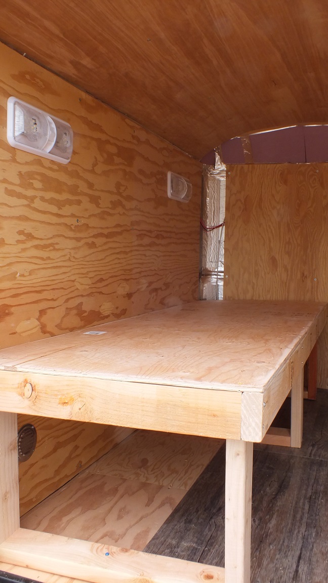

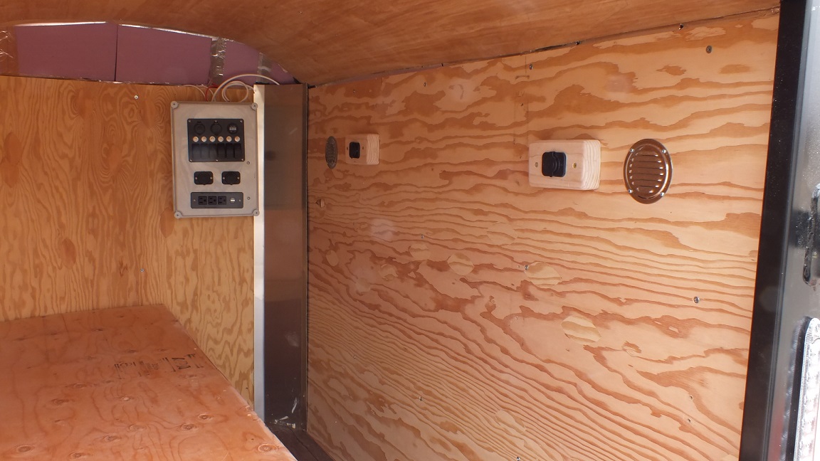

I had a nice day installing the ceiling header ply, the two 12 volt sockets, some floor tiling, and my bed pallet.
The ply header actually ended up being very easy, as it just popped in, resting atop the two wall ply panels. All I had to do was put in about 9 screws, and done.
The 12 volt sockets also went in fairly easily. I ran the wiring to the everything electrical box, but have not finished connecting things inside the box. I still lack a ground cable to the trailer frame.
I also laid down what I had left of linoleum tiles on the trailer floor. Need to get some more to finish things off.
I built the bed framework, and temporarily installed it to make sure I could still close the cargo door, and also be able to get in and out using the teardrop door. All works

Postby hankaye » Thu Mar 08, 2018 12:11 am
CaleyAnn, Howdy;
Well young Lady, lookey at you! Nice square cut ends, all squared off with the ones they're attached to.
Looks like nice 90°angles all sorts of good stuff going on in there.

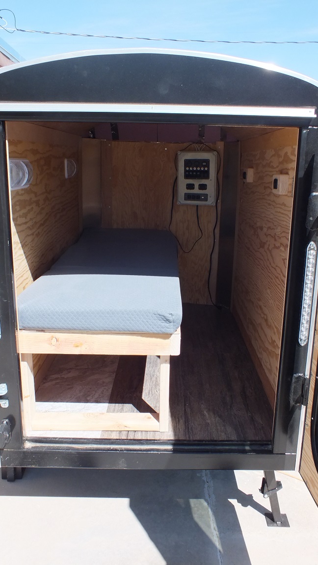

Another few hours of work this morning. Got the forward Trim back in place, with the exception of the top part of the forward bulkhead. That is going to be quite interesting to do.
I finished the electrical as far as I can. I still do not have the big wires 4AWG size so that I can connect the power and ground of the 12 volt system. Still have to figure out just what I need.
Homely Despotty didn't have the tile I used initially on the floor, so I just got what I could afford. The tile colours are mismatched, but then, I am not trying to impress anyone.
I picked up some square steel that is perforated, and some cross tie straps. I am going to bolt these together, and then mount them across the trailer tongue with 5/16 bolts. I'll also brace this platform to the trailer body. I'll then screw some galvanized sheet metal I have to the top of this platform. Next the battery box will be screwed to all of this. This is just a rough idea of what I am going to do, but you get the gist. Once I have this platform and battery box mounted, I can finally purchase my batteries (2 x 6 volt golf cart Duracell), and finally start wiring the power and ground setup, adding the main breaker and emergency cutoff switch.
I still need to find a mounting bracket that will hold a 5 gallon can of gas on one side, and 5 gallons of water on the other above the wheel well. Any ideas in the cans and the mounting brackets? I've looked on Amazon, and just get confused with the variety, and the different sizes. Just can't seem to match the cans and support brackets. They all seem to be different dimensions.
I also need to find a place for the spare trailer tire, bit I am running out of room on the outside of the trailer. The trailer came with a spare tire mount, but it doesn't seem to have a way to lock the tire on, or for that matter, bolt it on.

As you can see, I have a lot of room under the bed platform for storage. I have half a dozen lock top lid containers that will go there, and there should still be room for a few other things.
On the right wall as you are viewing, I will have a couple of fold down tables, so I have a place for a fan, or just a regular work table.
When I am camped for my gold mining trips, I will have an awning covering about half the trailer. Opposite the trailer door on the other side of the awning will be the tent that attaches to the awning. In that will be my kitchen and other things. Those things will just have to be stacked inside the trailer when I am driving from place to place.
To the left side of the awning will be my shower and bathroom tent, which can also attach to the awning.
I'm almost set to do a trial overnight trip.
QUESTION: I have a lot of bare wood. Anyone have a suggestion on something I can paint on it to both enhance the looks, and provide some protection from the heat of the desert, without adding a lot of smell. So many things give off a very bad odour which I really would like to avoid if possible.

Postby Iconfabul8 » Fri Mar 09, 2018 5:43 pm
CaleyAnn wrote:QUESTION: I have a lot of bare wood. Anyone have a suggestion on something I can paint on it to both enhance the looks, and provide some protection from the heat of the desert, without adding a lot of smell. So many things give off a very bad odour which I really would like to avoid if possible.
Peel and stick carpet
