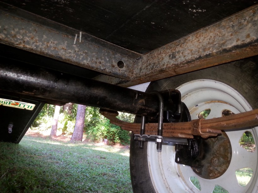

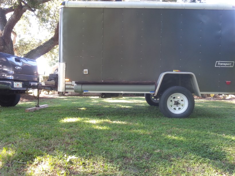

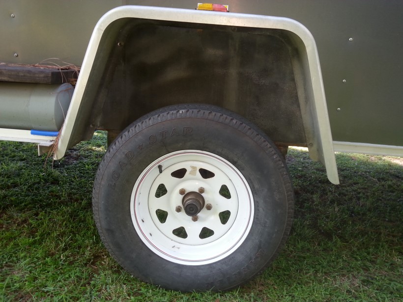

Postby Tommy B » Wed Sep 12, 2018 3:39 pm
OMG, Just saw your post. Too late as it is done. I don't know what to think. Holy Jesus this is high. :shock:
Am I ok Should I reverse this? :frightened: Seriously??

Postby flboy » Wed Sep 12, 2018 3:59 pm
Holy cow... it is high but I kinda like it. Definity better for offroad. He did leave it on top of springs so not as high as I thought it was going to be, so that is better. May have issues with camber bend and wear tires under load, but if no camber bend in your axle, probably fine? I am not an expert so maybe someone else can chime in. I only know what I read and researched before I had mine flipped as I did. I was worried about camber bend being reversed and it being too high and changing tow dynamics too much. My trailer is taller anyhow, so I told them how I wanted it done.
I did get a 4 inches lift for the trailer body out of my "flip"and not change the axle rotation which could affect camber position aand tire wear. That was what I was aiming for.
