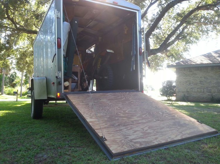

Your ramp angle is going to be steep. With your cables even let it down all the way?

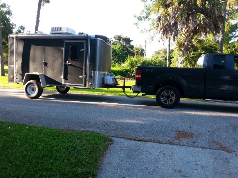

Good Morning all!
After sleeping on it all, I came out this am and after seeing it again, all's I can say is, I love it. Exactly what I wanted. The shop/people who did this are really pros at this and have been around for ever. I have been under that trailer many times and I am 90% sure that axle is just a large straight 3-4 inch pipe. I think that's why they proceeded with the modification. I have done business with them many times and trust them. We shell see.
BUT... although the ramp door does drop fine it is steep and I was watching the cable dance a little loosely as it played out on one side. May have to adjust it?

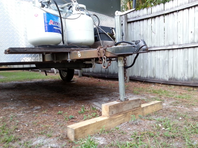

And the jack post will always need a large block underneath when deployed as it will not crank down enough now and I still need to purchase a higher hitch, like 5 inches total. Not sure yet.
I may level it and place the atv and a full tank of water in side and tow it a bit down the interstate to see whats what this weekend. Let you know how it goes.

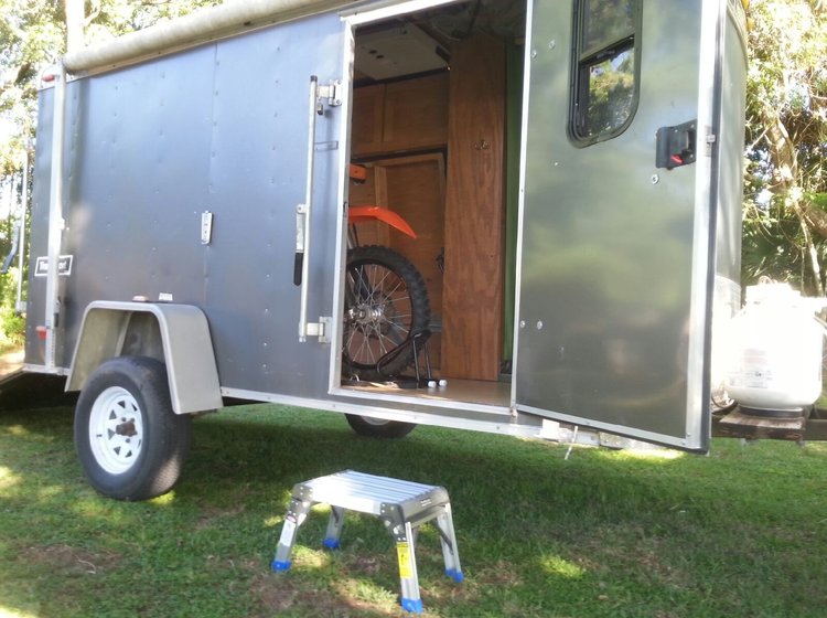

Yes Hank, two stepper for sure. Maybe a portable step latter. Another project for after surgery.

I like the way it looks too. Certainly no clearance issues now.
If your axle has no camber to it, then tire wear should not be a factor. Not sure you can typically see the bend if there were one. The bend is kind of gradual over the entire length as I understand it??
One way to find out... just use it and watch the wear and check them often
Btw.. you probably could pull your CTC right through your front swale when it is dry now without using the driveway. It is a backwoods boondocking machine now! :-)

Here are two more angles.
The step will be interesting to figure out. :thinking:

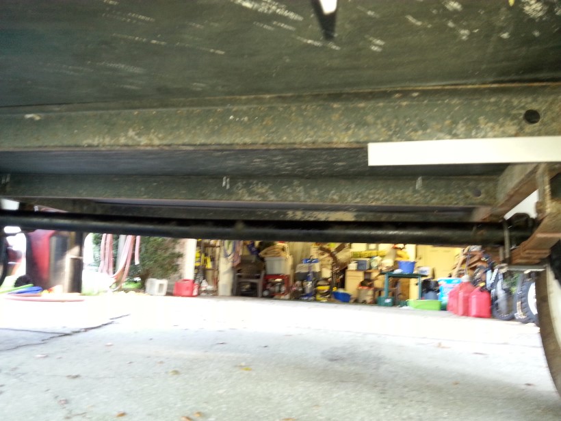

Well I loaded the ATV in plus 20 gallons water up front. Yes it is level and all BUT....
I took a good look at that axle and oh yes there is a very noticeable bow in the down ward way as it is set up now. :oops: I was going to take a run down the interstate for just a few miles but am thinking about it now. A new straight axle with labor would be app. $350 or a little less. But what about the tow in and what not for a after market mod. Would a new set up run true and all? I will call the shop.
Imma take a run up 95 now briefly then check tires. 6 miles or so

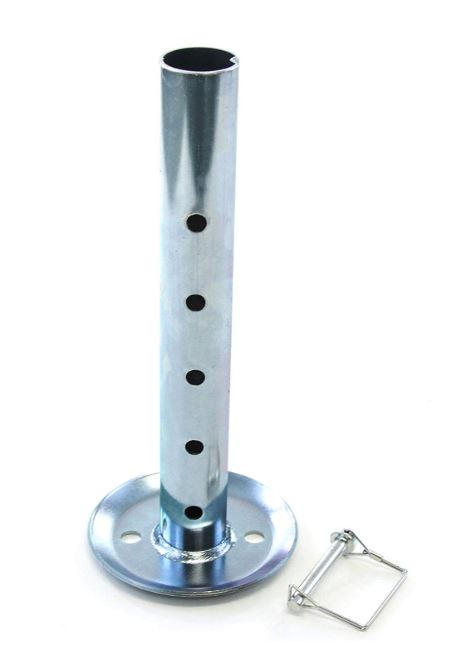

Tommy... you may be in luck... I have some rear stabilizers that are longer I could not use on my first CTC. If they will work for you, they are yours. Also there are some other options I use for my CTC in the front.
They do make extensions for the front jack with a landing pad on the bottom. It would be very easy to modify if longer was needed. Easy fix.
https://www.amazon.com/Red-Hound-Auto-D ... k+drop+leg
BTW... when you were driving off yesterday, you can easily see the "bow legs" on the tires. It is not huge, but noticeable. Will likely be more pronounced with the more weight added.
