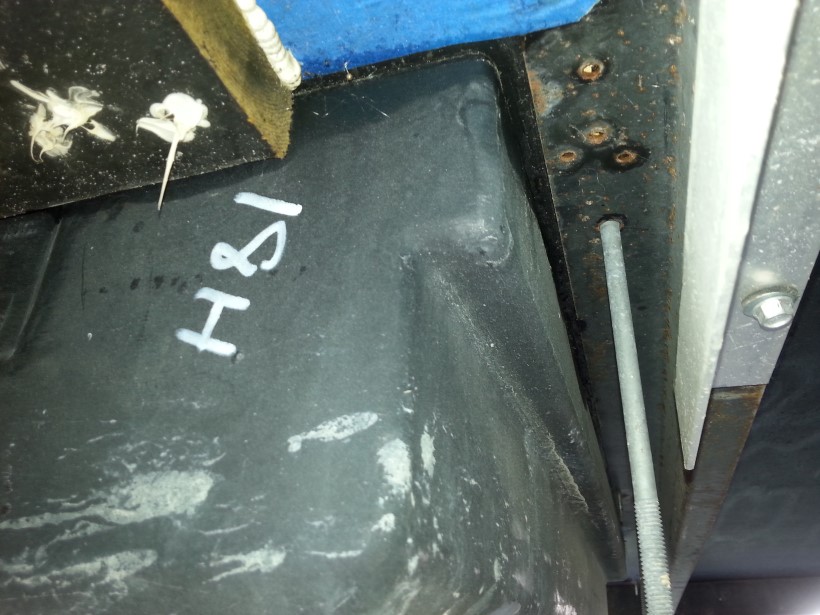

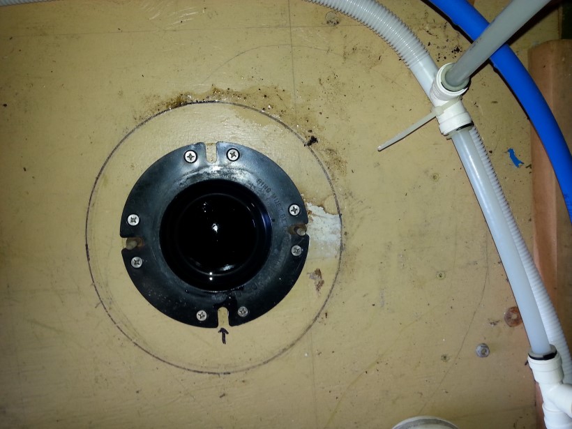

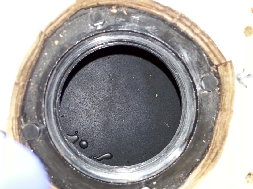

Sooo, as I was flushing out my black tank a pretty good leak developed between the tank top and the bottom of the deck. Not inside thank god. It must be the flange or the tank. Im on it. It is comforting ( believe it or not ) in knowing I built this and I can fix it. But why the failure? I do see evidence there of interior leakage maybe. The white stuff. But the underneath was a shower. :thinking:

Re: HALLMARK 6X12 CONVERSION
Postby McDave » Sat Oct 27, 2018 1:42 pm
Hmmmm,
When you say you were flushing the tank, is that from the dump valve or from the top side? I assume that flange I see there has a tail piece that goes through a grommet in the tank top? Could that piece come loose from the flange and drop into the tank? Does that Dometic use a wax ring or some sort of a rubber gasket?
All questions, no answers today. Sorry..

Postby Tommy B » Sun Oct 28, 2018 3:23 pm
Ah well I thought I posted this but its gone?

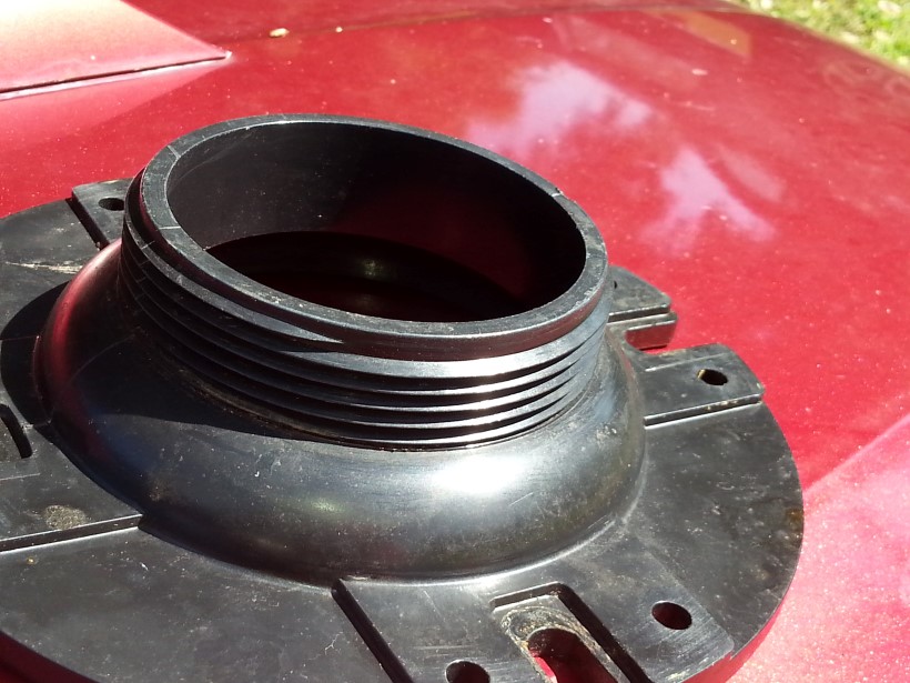

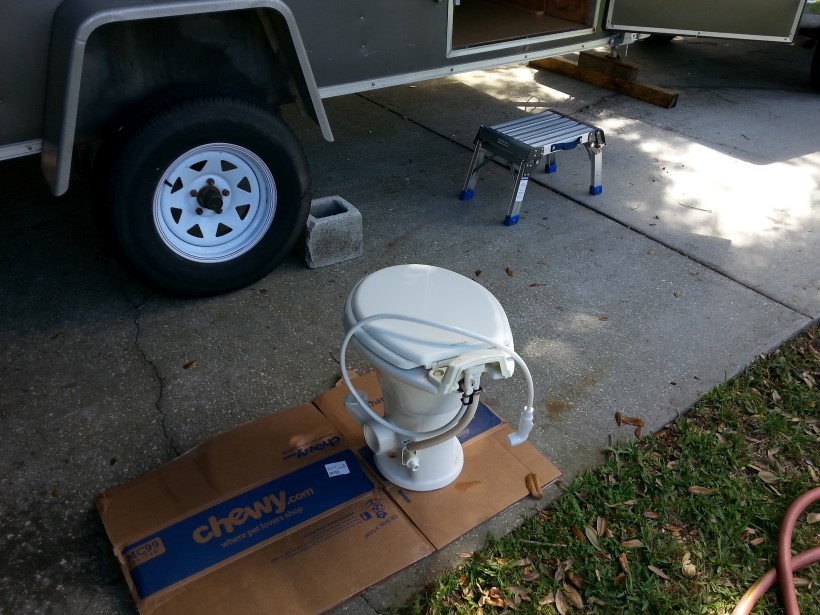

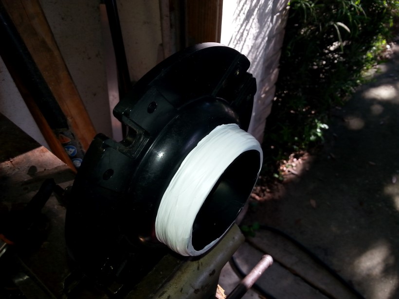

Any who, Bad flange seal to tank. Not enough Teflon tape fail I believe. learn along the way I guess. Don be in touch shortly.
Clean, reapply, tighten, pray. :?

Postby flboy » Sun Oct 28, 2018 3:49 pm
You must have had that tank filled all they way up to the neck to realize a leak there? Would be an odd case to have it that full? Glad you figured that out... but is it possible it was always that way and this is the first time to be so full?
I do not have a threaded input. My bowl flange pushes through a rubber grommet which make the seal.

Postby Tommy B » Mon Oct 29, 2018 7:31 am
flboy wrote:You must have had that tank filled all they way up to the neck to realize a leak there? Would be an odd case to have it that full? Glad you figured that out... but is it possible it was always that way and this is the first time to be so full?
You are correct Don. I just happened to add too much water while I was flushing the tank. At least it was relatively clean water and I found the leak early in the game. Also, I did of course utilize the new dump station and it is really handy. I did learn that I need to place a sand bag over the end of the hose down at the clean out end. I was very proud of the set up and called the wife out to see it in action for the first time. Watch this I said as I pulled the lever. The waste water rushed out and down the hose and then, bamm, hose jumps out of pipe, waste water everywhere but in the pipe. One of those days.

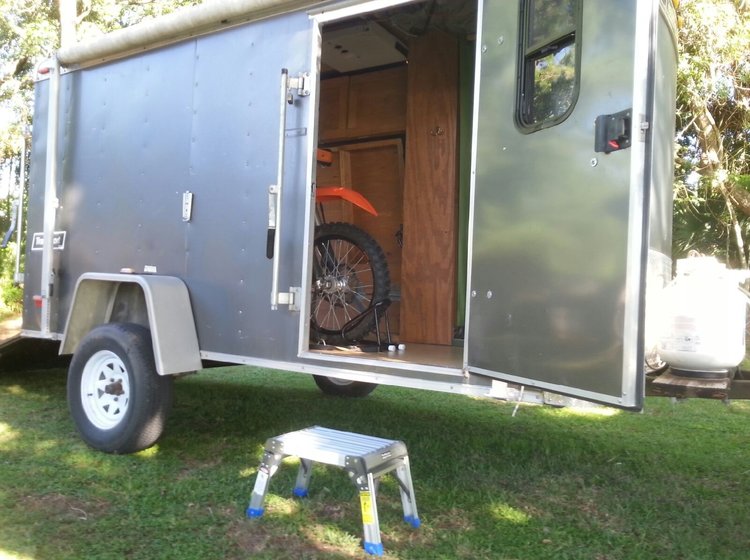

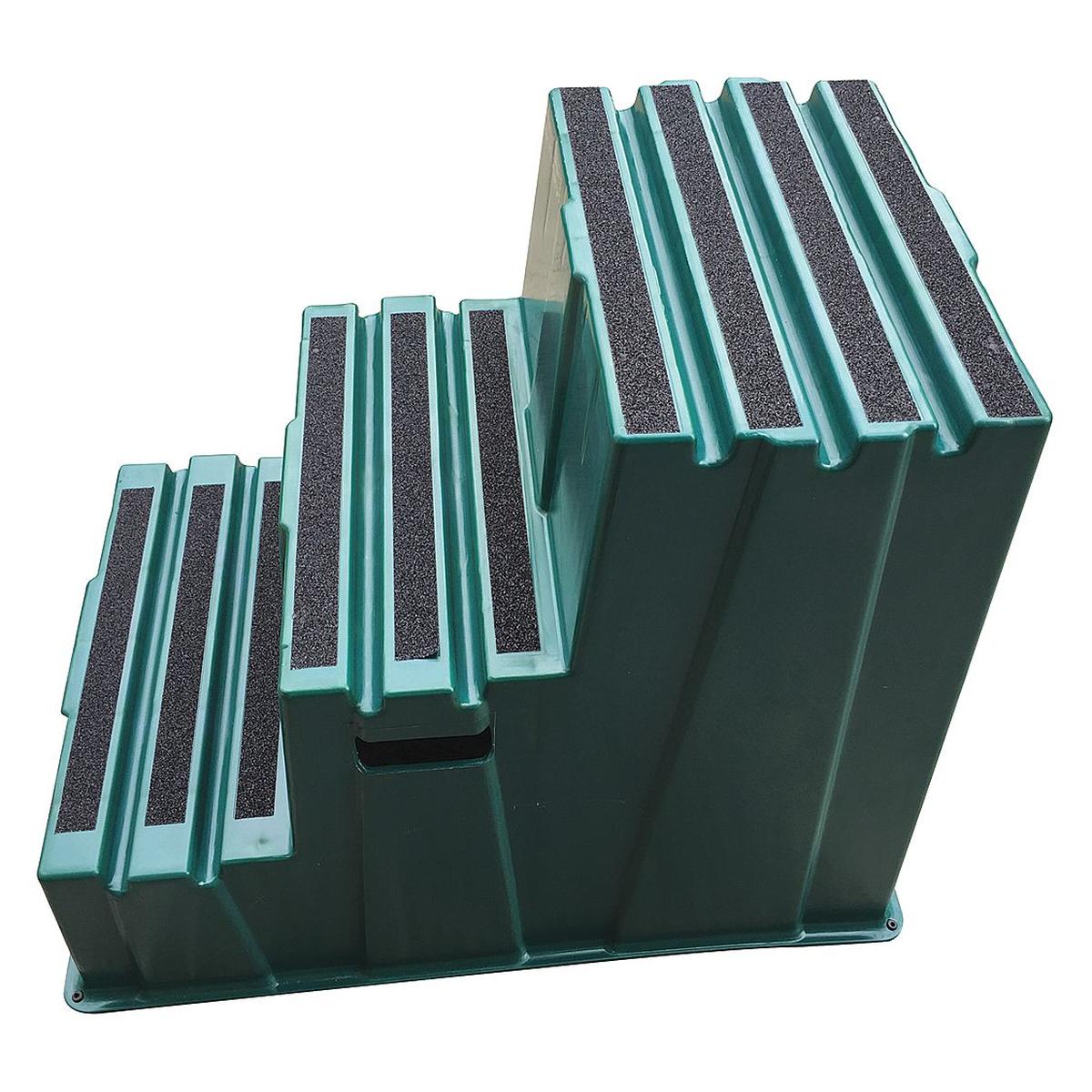

One other major concern is that step now. More than ever.
Box Step: 3 Steps, 500 lb Max Load Capacity, 28 3/4 in Overall Ht, 23 in Base Wd, 35 1/4 in Base Dp, Green
item # 527W642 $151.21 :thinking:
Might do this. Just place in side as I leave. That step will eventually hurt me bad. My knees hurt bad getting in and out as it is but its also a little shaky too with that little stand.
Any one use something like this? Portable.

Postby PiddleFart » Tue Oct 30, 2018 12:18 pm
Hi Tommy, another thing you might want to look at is a hottub step. They are about 28” wide and the treads are about 12” deep. I think mine was about $60 on Amazon. Plastic so you don’t need to worry about moisture and they are very stable.

Postby Tommy B » Tue Oct 30, 2018 12:53 pm
PiddleFart, that name really made me lol! Yes this company does make those also. A two stepper I think. I will take a measurement and see what all fits but one thing is for sure I will get something like today or tomorrow. Thanks! :beer:
