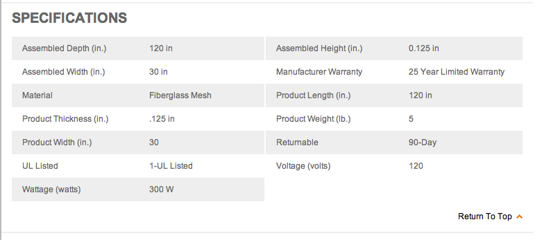

Ok newest crazy plan
I am deconstructing OTTCT to install 2 nd layer insulation on the walls and floors to see what a difference it makes, i'm hoping for 50% cut in heating needs.
Under my bed I will install a floor tile heating matt from Sun touch 30" x 6 ft
I will install this on a 30" x 72" board with tiles that can be lifted out if I don't like it,
or also removed in the summer time when not needed.
I can't find my stupid $159 thermostat, so the hell with it, I will install this on a simple on / off switch,
dimmer or timer model , 20, 60 or 240 minutes. It only used 180 watts or about 540 btu per hour on full power
(( pictured below is the 10 ft long matt - this uses 300 watts))
With my current crappie insulation I am able to heat the trailer with about 500 watts or 1,500 Btu per hour.
Anybody wanna take any bets to see if this will work ? AS 100% of the heat will go up into my bed...
this Is the only place that heat its needed for me. :D :D

Postby OverTheTopCargoTrailer » Sun Dec 30, 2012 7:59 pm
Hi Revorunner
I tested the mat today, works pretty well when laid directly over foam it gets quite hot :D :D
I would guess over 120 deg
If its laid over carpet where the heat can go up and down , then not so well. :x
Only about 80 deg maybe.
