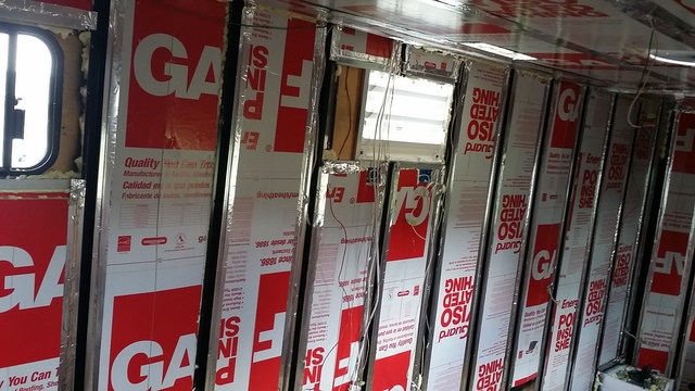

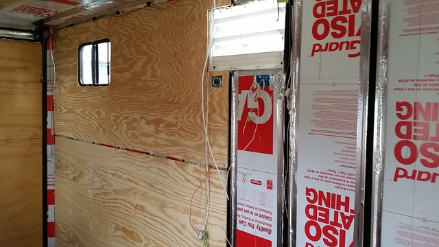

I didn't make a lot of progress today, but I made some. I got the insulation taped off and started the plywood re-installation. I hope to have this done all the way around tomorrow.
With the plywood back in, then I can start the Luan Paneling on the ceiling. After that the floor, then the fun stuff. :-) I wish I had another week off... but I'll just have to make progress when I can.
