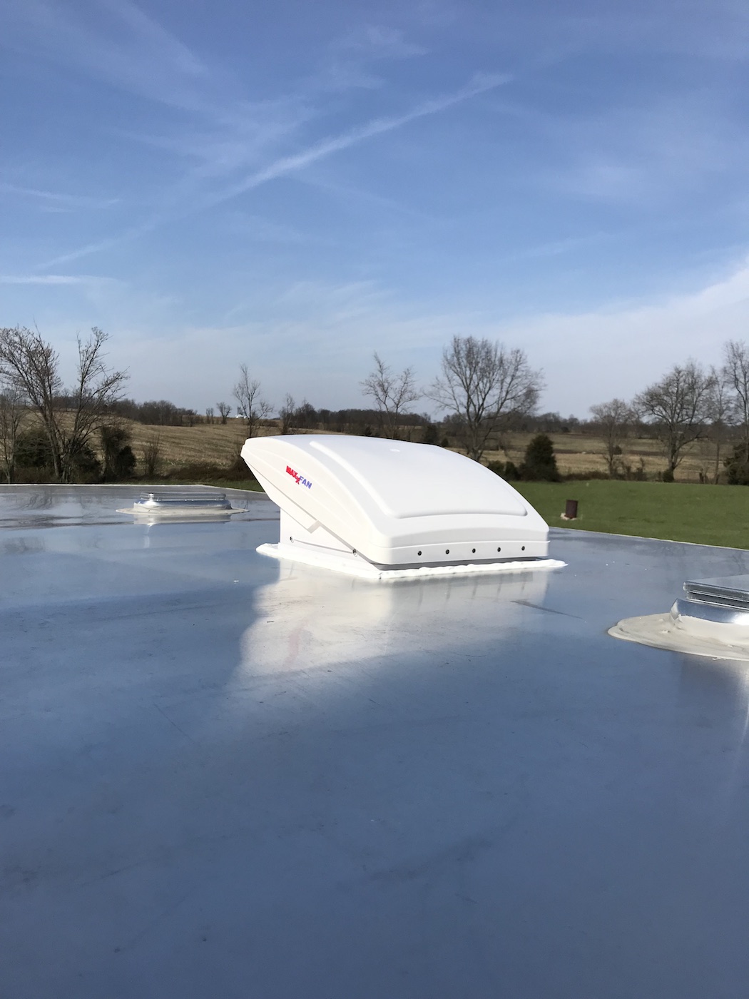

Here is the Maxxfan after installation in the raised position
13 Maxxfan installed raised.JPG (212.16 KiB) Viewed 5659 times

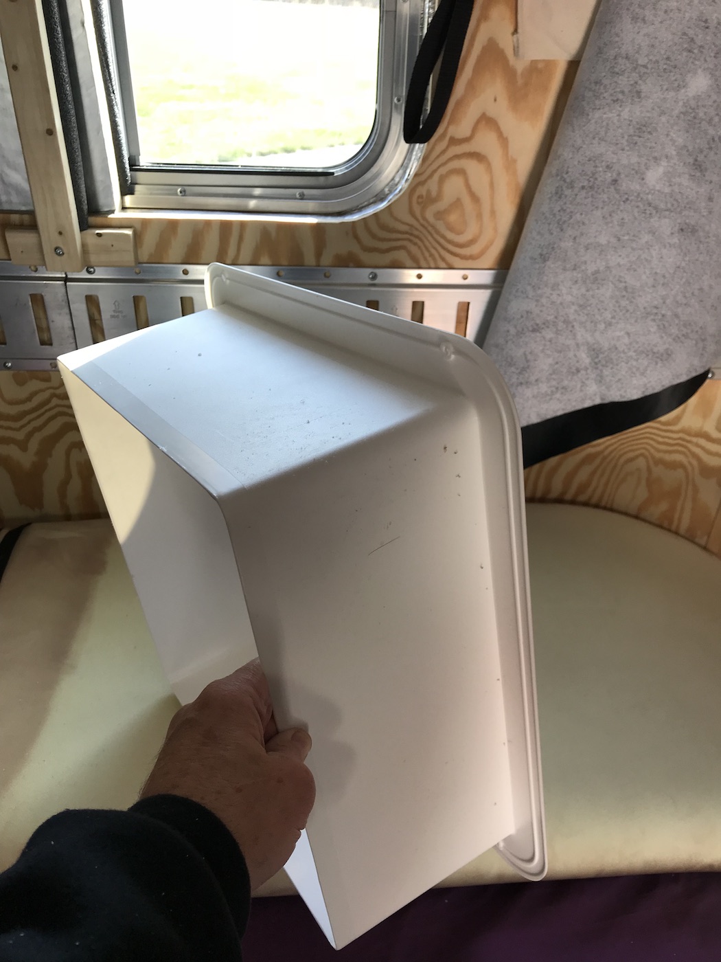

Here is the interior garnish trim ring before I cut it to proper depth to match the depth of the ceiling cut
14 Maxxfan garnish uncut.JPG (245.96 KiB) Viewed 5659 times

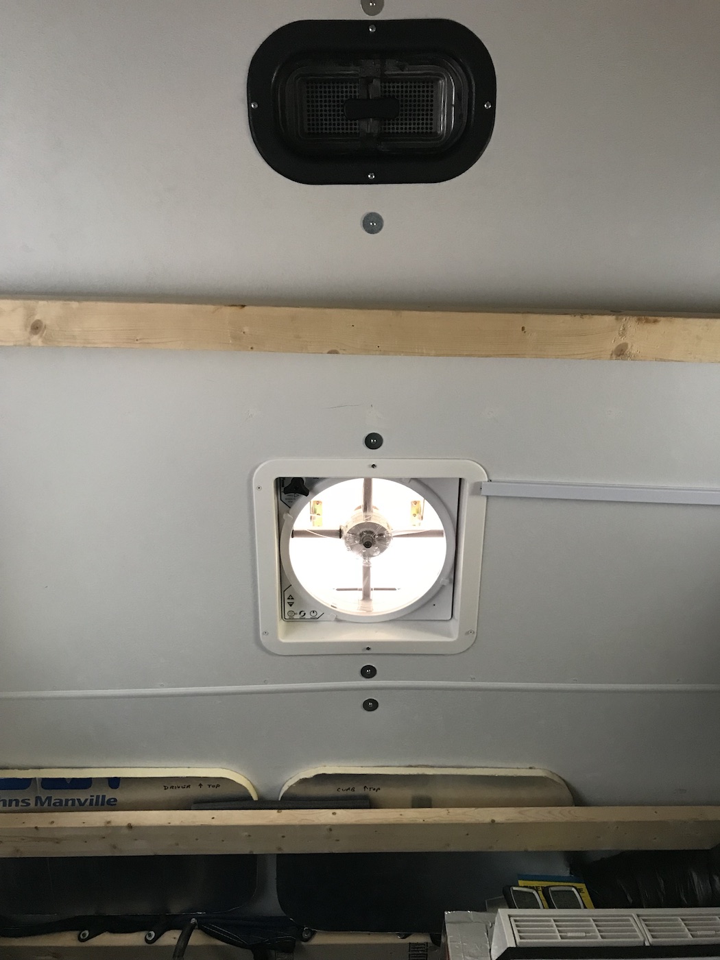

Here is a view from the interior after the Maxxfan was installed and wired up. I bought a white plastic wire raceway from Home Depot for about $10, to conceal the wires crossing the ceiling to the wall cove. The fan has 10 speeds, forward and reverse plus a thermostat with variable set points. This fan is a manual design with no remote (one less electronic device to fail)

I like it! Nice clean installation. It is always a little nerve wracking to cut a hole in a perfectly good trailer, but some things just must be done. That is sure a well insulated ceiling. Was the other vent a factory item? Pretty sexy unit, I thought it was a speaker at first. Nice job Featherlite, she's coming along quite nicely.

Thanks McDave. I fretted about cutting this my first hole but it was actually pretty easy given the fact that the OEM framing created a guide for the jig saw. The other "Salem" vents were factory installed in locations specified by me.
