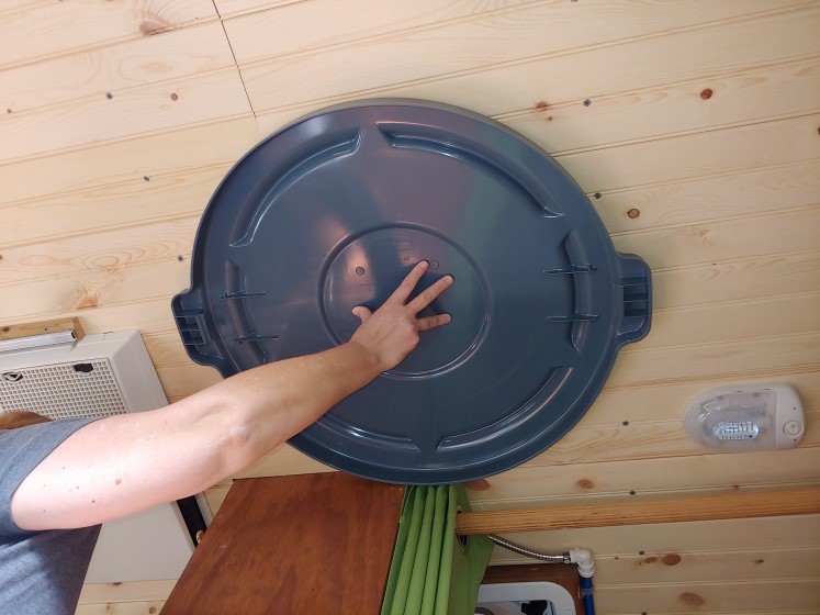

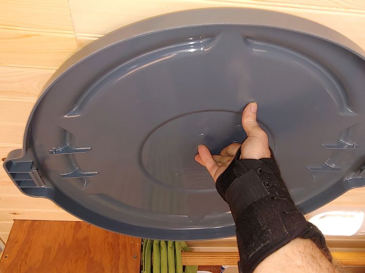

Now, this is what I'd do if using the lid so I didn't gash my head.. Countersink magnet in ceiling and screw washer to lid in appropriate places.
Just need to get right strength magnets. They can be too strong.
Just giving you some ideas.

Tommy, if you can wait until Saturday, will help you countersink and mount magnets and lid. Need to give that wrist a rest.
The CTC looks great!

Hey guys/gals, as I looked at this last night, the Lid spans two ribs at nearly the handles, I think just to the inside by a few inches.I am considering these bar type magnets. I am not sure but I think the groove pieces would go on the ceiling and the magnets on the lid right? Use two or three end to end on each side. I would be curious to see if the maganets on the lid would be strong enough to pull through one inch of pine less the groove pieces. :thinking:

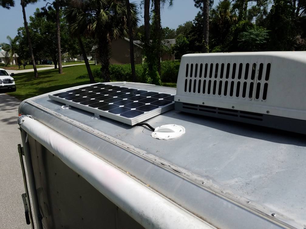

Don If you have any spare time, even a little, I really need to finish fixing that LEAK on the roof. Its fine if I don't tow it anywhere and if the wind doesn't blow in a certain direction, I think! You know the one right? I have let this go far too long and now so much at stake. Thanks. It should only take one hour max. I have plenty of everything.
The leak happened at that wire cover from the solar panel. It leaked cause the black plastic wire wrap that is split down the center acted like a straw when the black eceltrical tape sun rotted an alowed lakage. I removed all the selve leveling caulk and black wrap before I relized what was what. It stoped the leak but well know what?

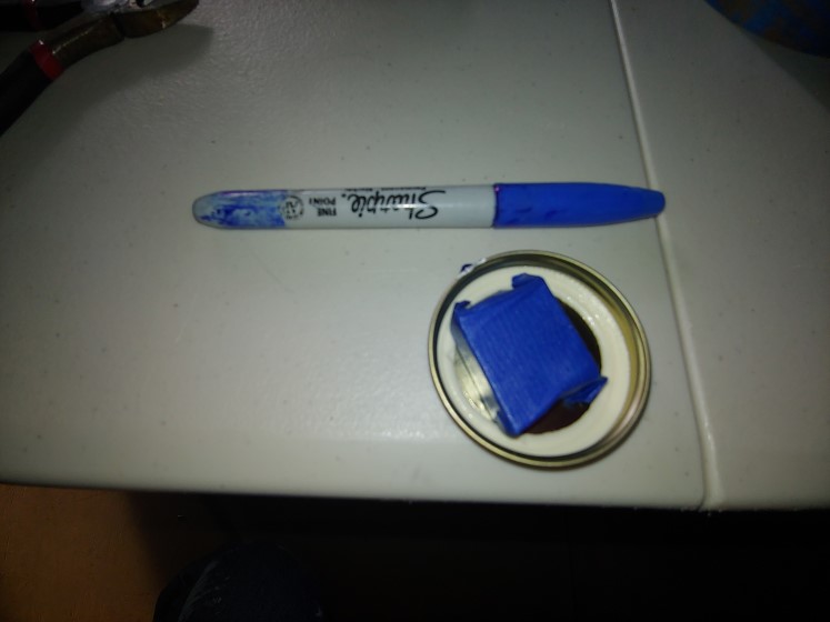

Postby Tommy B » Wed Oct 02, 2019 4:04 pm

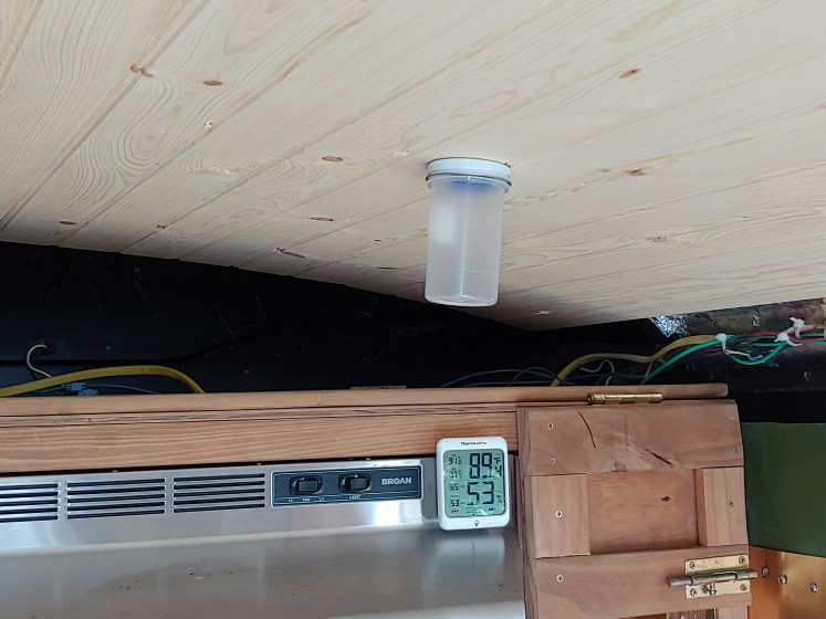

Ok, home from work. Quick experiment. This is a small piece of a magnet from a large bar. It is wrapped in painters tape and placed in an unused urine container for storage. It easily attaches to the roof through the ONE inch pine Even more so to a screw head that is screwed in to the overhead rib. :D
I will use big bars or double up. The bars will go right on top of each handle and there thickness will make up for the gap between the handle and the ceiling. Like it was custom made.
And it will right there, exactly.

So I was looking at your latest post pics and I noticed the thermometer/hygrometer in the background. Those numbers don't look so good if am reading them correctly. 89f @ 53% sounds like Santa Fe in the summer. If those are the numbers for inside with the A/C on we have a problem. :NC Assuming the A/C worked properly prior to this last project (T&G ceiling and insulation), Then something has changed. One definite change is the insulating and how much heat is being radiated/transmitted into the cabin. Also the T&G does have some insulating properties BUT, and its a big but... all that lumber is loaded with moisture and will be until the ambient humidity has dropped for some time. Dry pine is like a sponge and until it is acclimated and sealed it can be very hydro-dynamic. You may have already noticed things shifting or shrinking or swelling or twisting and that may change daily depending on conditions. But once the heat and humidity drop for "winter" in your area you will see it has stabilized and then the A/C should be able to remove more of the moisture at which time sealing your ceiling would make sense. But first and foremost make sure that you have fixed the leak from the roof and that the insulation did not become saturated anywhere. If it has it may be impossible to "draw it out" via the A/C and you must open her up and remove and replace wet stuff with dry stuff, allow ceiling to dry out, then seal the ceiling. Sounds bad but you gotta know if that is the case, hopefully not. Now, as far as A/C performance, couple things to check. Is the compressor running when you are asking for cold air? You should be able to hear it. If the comp. cycles off is it due to the control being satisfied (reached set temp) or is it short cycling and the thermal overload protector shutting it down prior to the control being satisfied? If it is the latter, we need to know why. Condenser coil clogged, evap. coil icing up, drain clogged, start/run capacitor issues, incorrect voltage to unit or a worn compressor that draws too much current, etc. etc.. It is also possible that the control is cycling too soon due to the moisture being removed from the ceiling right where the cold air is discharged and the control senses temp. So you may want to try this for a few days, A/C on high cool, temp set to normal medium setting 70-72f, ducts pointing down away from ceiling and all doors, windows and vents closed. Allow the A/C to treat the same air for a while and see what happens with the temp/humidity. Then you should be able to tell if A/C has an actual problem or not. If the compressor cycles off before 70-72f is achieved wait a few minutes then turn the control to a lower temp. If the compressor starts again that tells us the control is being fooled or is faulty, but the cooling system is OK. Also, be sure that the inside A/C cover and the boot that comes from the evap. are installed correctly since the depth of the ceiling has changed. If that boot has come off or was damaged the A/C wont be able to do anything right.
Just take it one step at a time and let me know what you find and we'll get you back on the air in no time.

Mcdave, those numbers are just as I opened her up after comming home fromm work, with the AC off and CT locked up. Right before the ceiling job it would go to 105 temp, 45 humidity. I have not seen it get past 98/45 in storaage since the ceiling job. BUT, there is a real problem NOW, as the humidity will not go below 72 aas IM sure you know. Just info and thank you very much for you insight. And also when you first mentioned magnet, it did get me to look that way again, thanks.

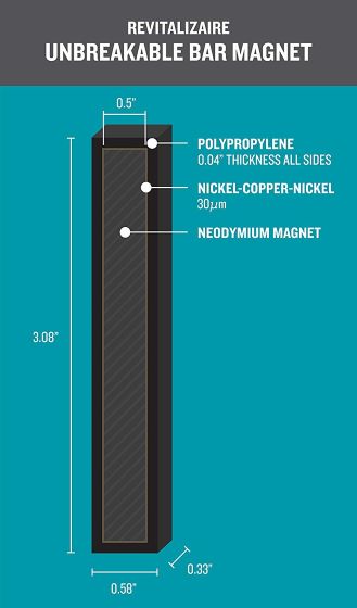

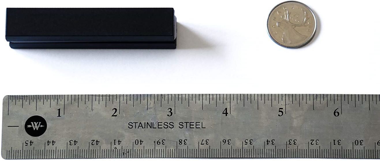

I am ordering these. They seem so perfect for many reasons, but will they be strong enough?
Unbreakable Plastic-Coated N52 Neodymium Bar Magnets, Waterproof, 3 x 1/2 x 1/4 Inch. 2-Pack. Revitalizaire Strong Permanent NdFeB Rare Earth Magnets Coated with Hard Black Polypropylene
Will order 2 sets $21.00 a set
