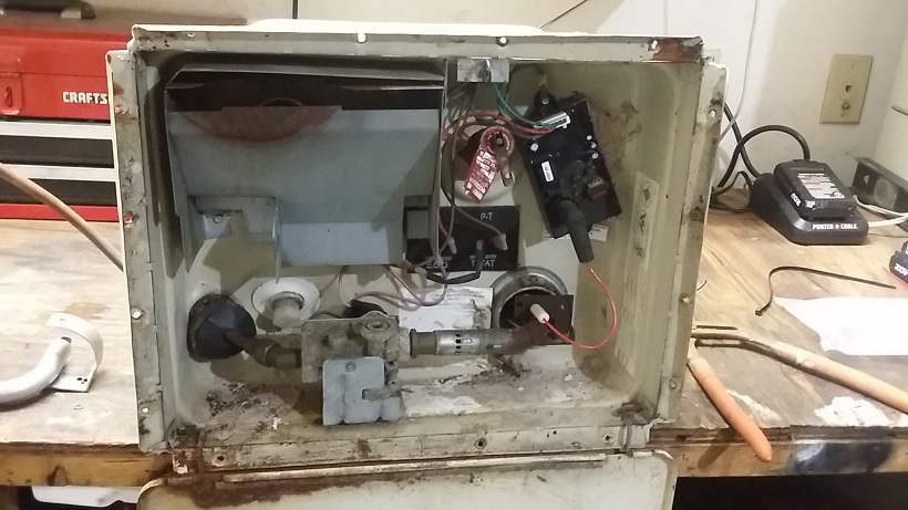

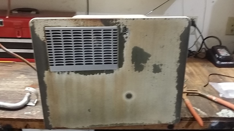

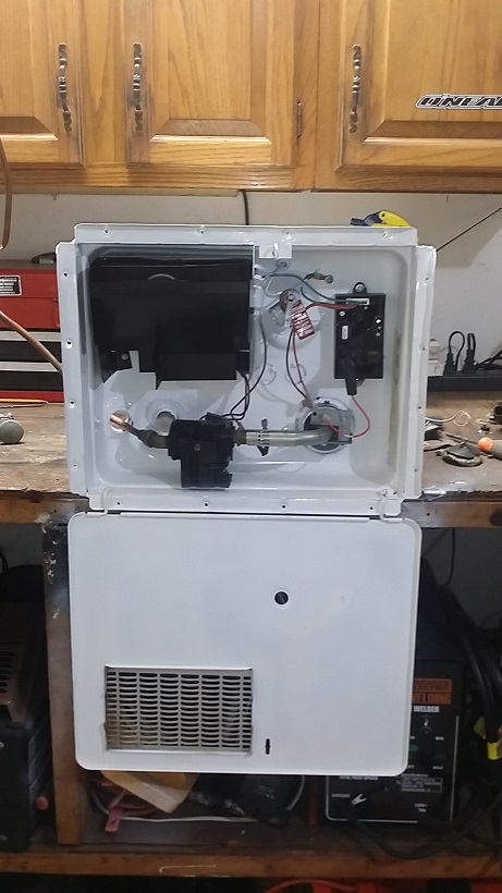

Hi McDave. I did not tear it apart yet. I guess I can cut open the tank to see where it failed inside the flame tube.. but water was running out it so there must be a crack or a hole that developed. This is an Atwood LP heater that is way older that 20 years... probably pushing 30 years. I pulled it from an old camper I was getting parts off of (1990 something Elkhorn truck camper). I refurbished it and the aluminum tank looked good from the outside. I think it is Suburban that uses steel tanks and glass lines them. NOt sure if Atwood lines the inside of the aluminum tanks.
I am willing to bet it just corroded out inside the flame tube. It had nasty water and etc. in it when I first got it... Sometimes free is not the best deal. I put some work into it and about $50.00 in parts. I don't really count the repair I had to do later because of the wasps... that would have happened even to a new water heater and I would have had to fix that too. I also spent about $60.00 (or thereabouts) on an electric conversion kit ... So about $110 in it. I am going to take out that kit... maybe somebody can use it. I'll also save the control circuit, thermostats, Igniter and even the regulator. It is all good but the tank itself.. I am buying an Atwood that has a factory installed electric option... but all the other parts will work as backup if ever needed.
Before :
After:
Don (Flboy)
