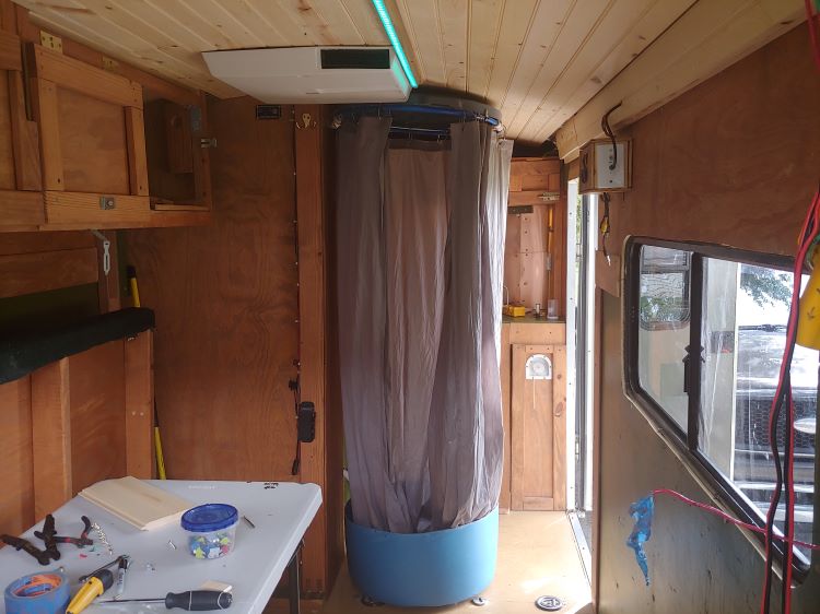

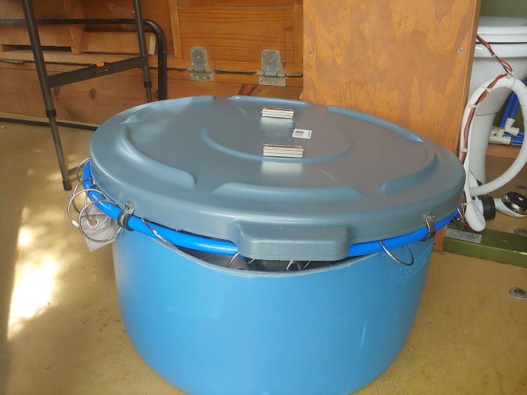

Oh man I'm done for a bit, but the shower is up magnetically. I will beef it up some when the other magnets arrive. Its ok sturdy now but I should be able to pull a left handed chin up come Wednesday.

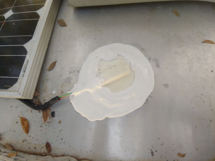

Tommy, did you get the Dicor self leveling sealer on the Solar Cable cover today? How does is look? Should be good with no leaks now.

I had to stack those magnets for strength. It seemed they might be too week by themselves but when stacked they got noticeably stronger so rather then spread them out it went that way. Just two points of contact. It really is strong and will not come down unless pulled. It can and will be tweaked some but man its simple and practical. Love it.

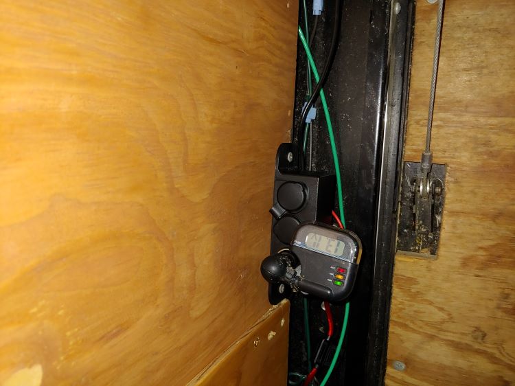

I wired in a new DC three outlet box in the back there. The TV and Dometic cooler will plug in there and maybe a fan if needed.

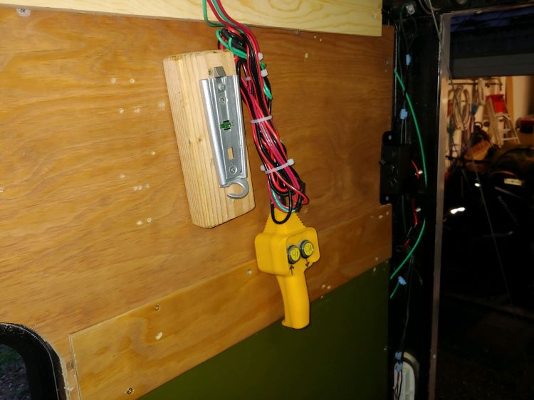

That winch controller. Left a ton of wire coiled as I will tweak it location some, is it still necessary? I trimmed off 20 pounds or so when I cut the bed down and have not tried to lift it when fully made so I will wait a bit. I really relied on it post surgery on the hand and still probably will need it. Right now its an eye sore.

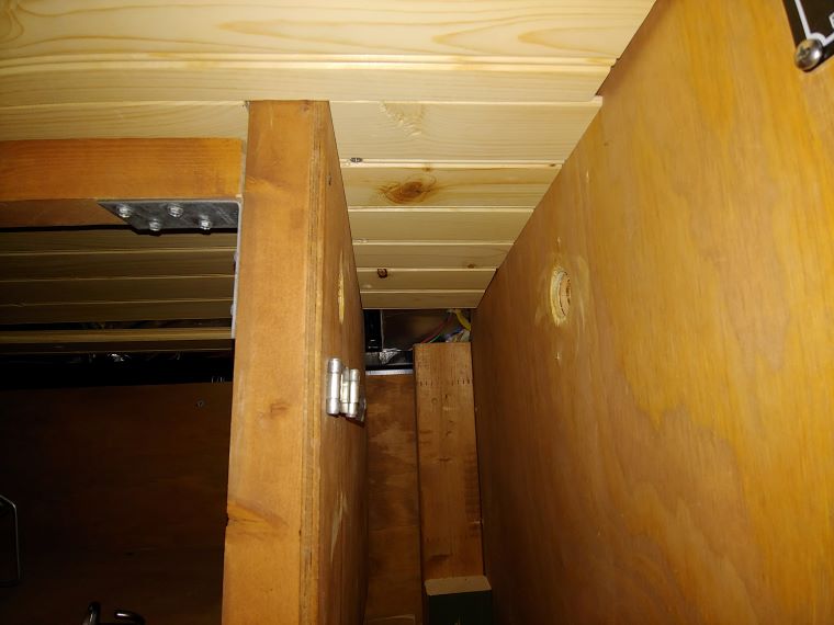

still chipin away but nearly done, it is going quick.

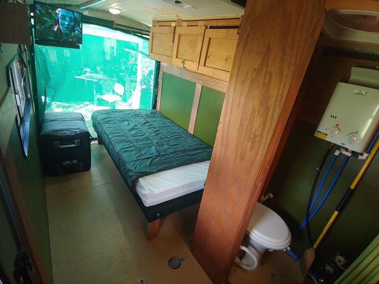

the micro closet. I will install bar tomorrow. The third cabinet door is trimmed up and will be installed tomorrow as well.
Now very soon I will go camping. :D
Im not sure what to do with this coil area, but that rear ramp/back wall has got my attention bigly. This weekend I will put something down. :thinking:

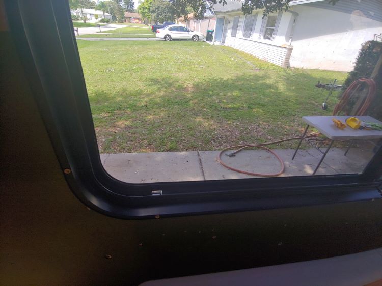

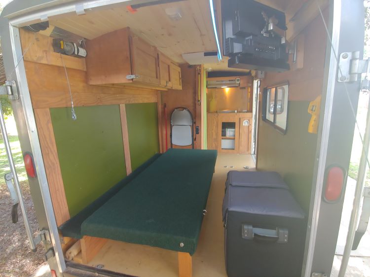

Quickly, the las t pic, Major leak but IS fixed now. The drainage path was not adequate and I modified it and it flows fine now. Must camp soon. Solo but better then nolo! 8)
Donnie all is really fine now brother, I still must apply Dicor to exterior solor panel wire inlet but I will do it tomarrow.
Lastly I will install a foldable shelve in front of the new AWESOME window.

Tommy, Looks great! Huge improvements! Was the leak from where the skin overlap is where we caulked last weekend or was the window just not draining? Glad you fixed it. Sorry I ran out of time this weekend. I am rewiring some lights and etc. at my daughter's house next door and then trying to get my CTC ready for Biketoberfest next weekend. Not enough time in the day I tell you.
I leave next Thursday for Daytona and staying three nights. Then the following Thursday I fly out to Chengdu, China for work and then come back Nov. 2. We need to plan the camp trips for November and December... trying to do one a month.
BTW... I looked at my CTC.. I had no skin overlap anywhere I cut in a hole. Just dumb luck I suppose, but live an learn. If I ever cut in another window and there is overlapping skin, need to head it off with dicor tape in the seam before the window goes in.

the LAST must do is figure the shower head attachment and when I figure it out I will post as others may benefit. It must be under the lid, not attached to the lid, and be stable. I think more magnets.
