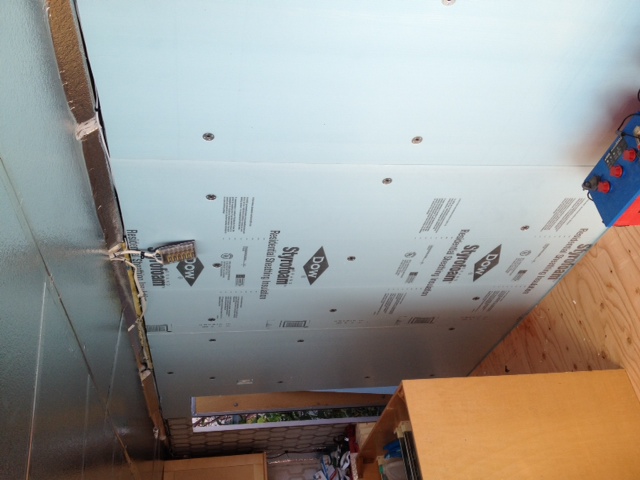

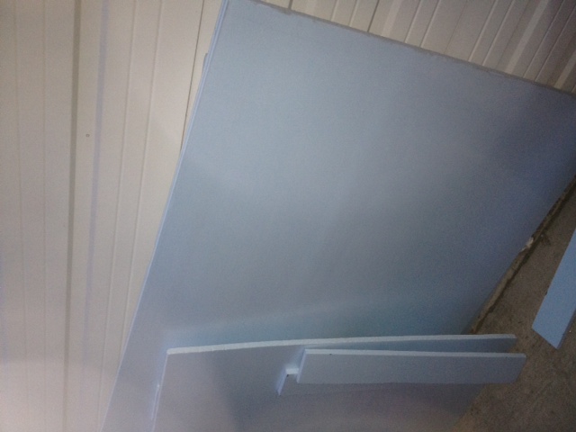

Here we go , I have decided to remove all the cabinets and install a 2nd layer of insulation on the floor, walls & ceiling. The first is just not working to my satisfaction because the metal ribs under the plywood transfer too much heat or cold. IMHO the foam inside the walls is not worth bubkus ! :x :x
With the old insulation I was picking up approx 10 deg over the exterior temperature. With this new lawyer I'm hopeful that I will be able to pick up 25-30 deg. My design goal is to be able to camp out in 25 deg F and be able to maintain 50 deg F inside without any additional heating other then ambient heat from my body, tv, fridge & inverter.
Currently also the 5,000 Btu ac is barely keeping up with the cooling load in full sun at 95 deg exterior temp, :? this upgrade should also have the same effect as upgrading to 8,000 Btu estimated, but for the exact same power of 500 watts.
In the next few days I will test the insulation and will see how it goes, I still have a small section of about 20-30 sq ft to install, hopefully tomorrow.
The foam board is from Dow Corning and has a R4 value for 3/4" thickness. Cost is around $15 per 4 x 8' sheet. Worst case I will have to install another layer - but may wait to do that in my next trailer.

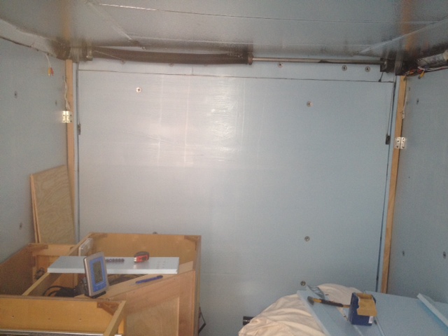

Insulation update. This morning 5 am I checked the internet 39 deg ....
I ran out to the trailer & checked the inside temperature also 38.8 deg S*****T DID the insulation fail ?
I wanted to kill myself...
as I went back inside I noticed frozen water in my yard, YAHOO SUCCESS :D :D
The real temp was 31 outside and 39 inside trailer - with nobody or anything inside.
Right now it's 38 inside trailer and 45 outside. But the cargo door & other spots are not done yet.
Will update more latter after some more testing.
I can already see if there were 2 layers of 100% - total of R8 everywhere , you can heat with a match & cool with a ice cube.
5,000 btu a/c with 100 deg exterior sun would still kick ass :-))

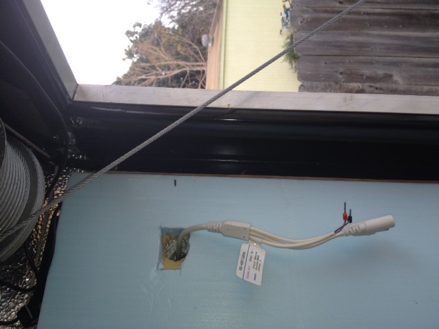

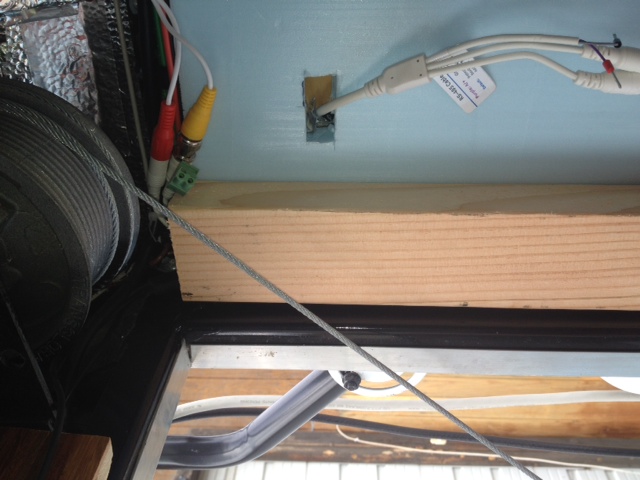

Here is the corner post that is a big hole, I installed a 2" x 3" and will put the smurf board around it like sheetrock
photo 2-6.JPG (102.53 KiB) Viewed 3127 times
Just a few strips left to go & the rear cargo door will be supper sealed,
click on picture to get bigger view
