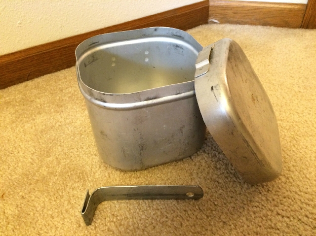

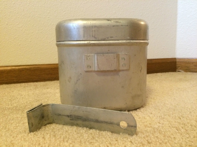

Postby Rainier70 » Thu Jan 08, 2015 1:39 pm
Here is a picture of the square Coleman "vintage" cook set that I use on top of my Nuway Stove. It fits perfectly.
These pictures are from an ebay auction. Mine I have had since it was new (I too am "vintage") and it is in a much more USED condition! :shock: :oops:
