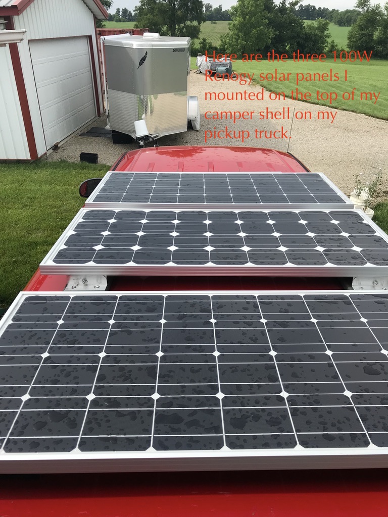

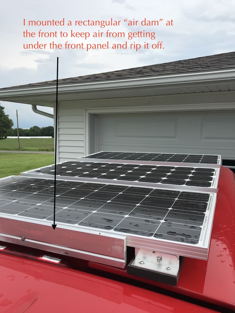

Postby featherliteCT1 » Mon Jun 17, 2019 7:53 pm
190617 1 Panels North.jpg (269.81 KiB) Viewed 5000 times
190617 2 Panel Air Dam.jpg (211.45 KiB) Viewed 5000 times
190617 3 Panel Brackets.jpg (167.13 KiB) Viewed 5000 times
featherliteCT1

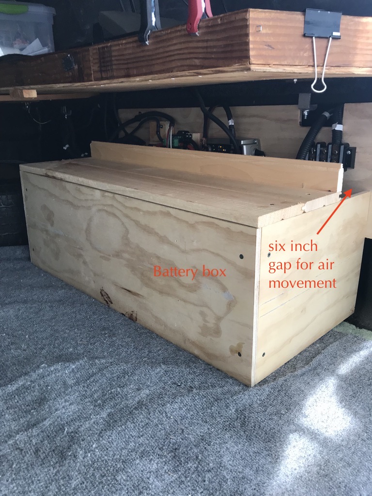

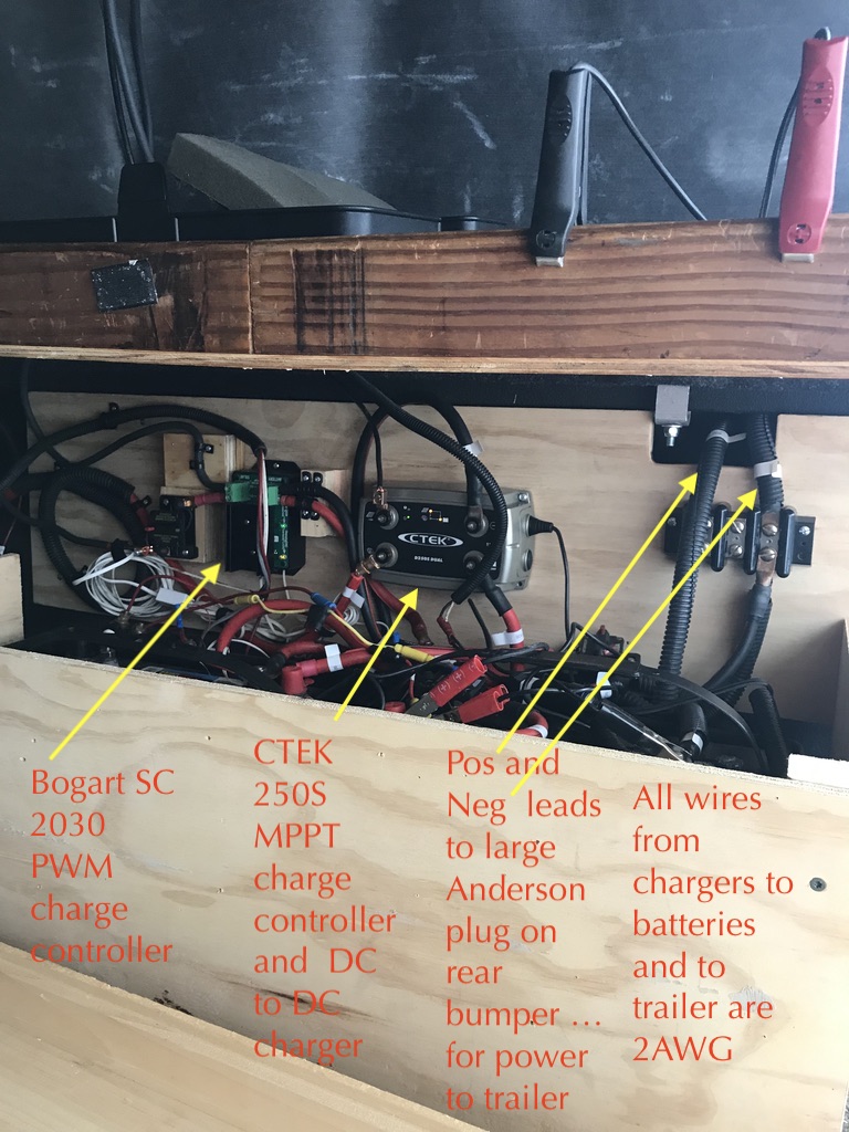

Postby featherliteCT1 » Mon Jun 17, 2019 7:56 pm
190617 7 Wire Box Closed.jpg (202.08 KiB) Viewed 5027 times
190617 8 Battery Box Open.jpg (238.38 KiB) Viewed 5027 times
190617 9 Battery Box Closed.jpg (252.3 KiB) Viewed 5027 times

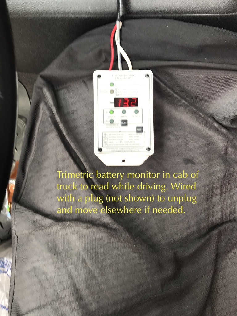

Postby featherliteCT1 » Mon Jun 17, 2019 7:58 pm
190617 10 Battery Box Slats Cleats.jpg (217.19 KiB) Viewed 5026 times
190617 11 Trimetric 2030.jpg (272.53 KiB) Viewed 5026 times

Postby Rainier70 » Mon Jun 17, 2019 9:11 pm
Interesting. This is the first install I have seen on the tow vehicle rather than on the trailer.
I think I would put the rear most panel on a tilting rack and drive with it at an angle so that it bumped the air flow up over your CT. You'd probably have to clean the bugs off pretty regular though! Maybe add a removable plexiglass cover over it to protect it if you tilted it.
Rainier70
Posts: 1083
Images: 244
Location: Southeast Idaho
Re: 7x16x6.5 Featherlite Build
Postby featherliteCT1 » Tue Jun 18, 2019 6:59 pm
Rainier70 wrote:Interesting. This is the first install I have seen on the tow vehicle rather than on the trailer.
I camp overnight in my truck more often than in the trailer and so I need the batteries to power my devices when I do not have the trailer. Also, my trailer is stored under roof more often than not in which case my solar panels would not be holding my batteries in float during storage. On the other hand, my truck is in the sun many hours during the day.
You have an interesting idea. My trailer is 3 feet taller than my truck. I wonder if tilting the rear panel would provide sufficient air flow over the top of the trailer to make a difference in fuel mileage.
featherliteCT1
Posts: 1168
Location: Southern Indiana
Postby hankaye » Tue Jun 18, 2019 7:09 pm
featherliteCT1, Howdy;
Best to raise it some, take it for a drive and check the "bug line". When
you have it right you shouldn't see a "bug line" on the front of your CT.
Of course when not pulling the CT you'll want it to lay flat so something
that is repeatable and adjustable would work best.
hank
