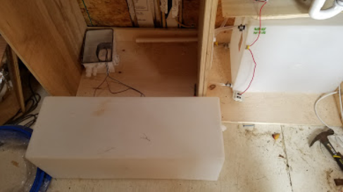

So putting the gray tank under the kitchen counter is a no go. Unless I cut a square between the cabinets, which may work. But it would still be close if I cut the hole.
Back to figuring out how to place this sump pump.

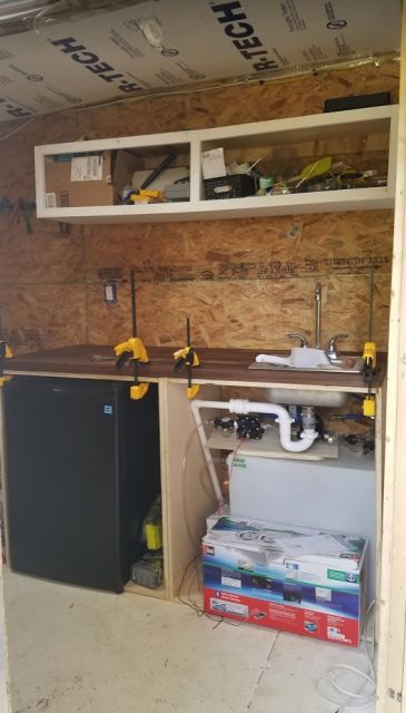

After some thought, I decided to put the sump pump under the cabinet where the sink is. It'll be tight, but this will give me the space I need for the fridge. This is one con of putting the tanks inside the trailer, you lose valuable space. If I were to do it again, I would get the longer slimmer tanks and put them between one of the studs like everyone else does on the floor and somewhat under the trailer.
I took the trailer for about a 20 mile trip today to get her moving (Been months since I moved her). Ironically, I feel she handles better now with weight on her. I went up many hills and valleys, and she handles well. When I got back and looked in the trailer, everything still in place!!!
So here is a pic of the kitchen with the fridge in place and the two kitchen cabinets installed. I felt a little bummed about the face plate since I spent a lot of time on them, and they just didn't come together as I hoped. I'll use filler and some more paint to make them look finished once I figure out what the wall will be.

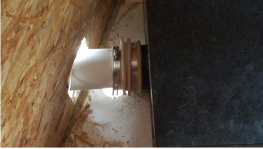

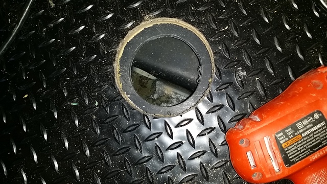

I figured out quickly that I would lose my pocket door if I wanted the black tank outlet to 90 degree out the bottom. I wasn't thrilled with the idea, but I felt my only choice was to go straight out.

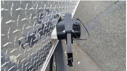

Inside view of black tank outlet. I'll have to patch up my previous hole. I also have a hard time cutting circles. I don't want to buy a rotozip, but my jigsaw and circle drill bit things don't seem to cut it.

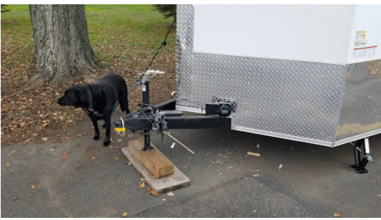

Outside view featuring my pooch.
Side view. I figure I could use a box to 'cover' it if I want in the future. I also don't see the need to tie it down as much. Seems pretty solid once I make everything permanent. May just use some of that metal bracket stuff.

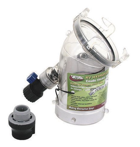

A thought on your black water outlet. If you will not also drain gray water from the same connection which typically flushes and cleans the real nasty junk out of the slinky hose, you may consider putting a fresh water hose connection somehwere on the output before the slinky hose connection so it can be flushed. I think they make a device that will go between the slinky hose and the twist on connector. Otherwise you really will have a "stinky slinky" :-)
This is what I am referring to:

What flboy showed works great if you are flushing out the tank. Better yet for a straight drop commode
for building up some volume of water to flush out the 'slinkey' is one of these;
https://www.pplmotorhomes.com/parts/ele ... rs_89-8428
You can use it to flush out the tank, keeping the dump valve closed, then open it after the tank is almost

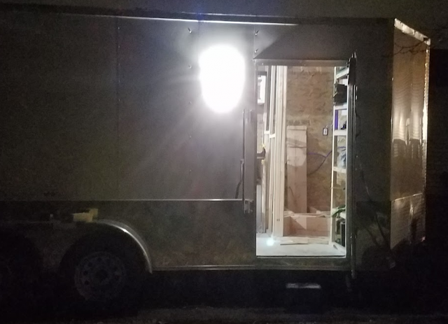

The darkness outside the trailer is really bad at night. So I wired up one of the exterior lights real quick. Makes a huge difference.

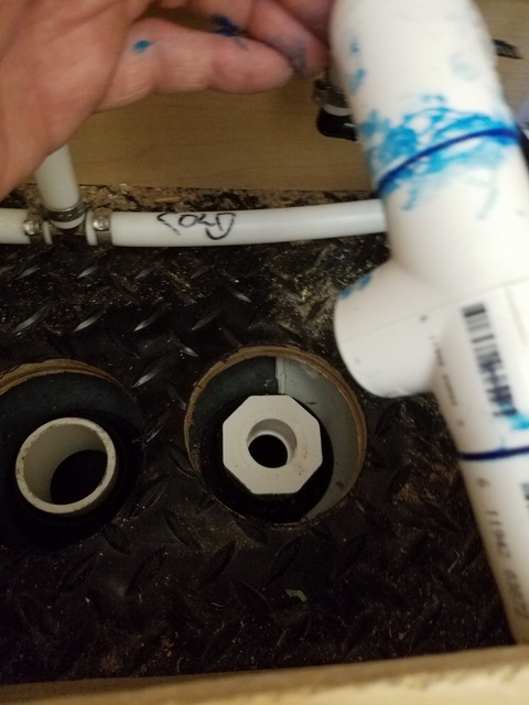

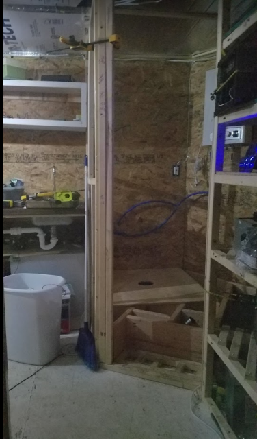

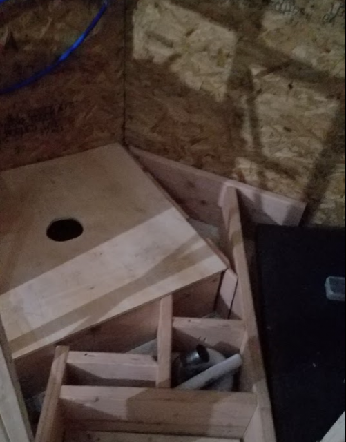

I have been steadily making progress, but haven't found the time to post. I underestimated the effort to do the plumbing and making the whole system work. I am getting closer, and have 'tested' the shower and sink drain and they seem to drain well. I hope to have the bathroom done this upcoming week and the gray tank operational.

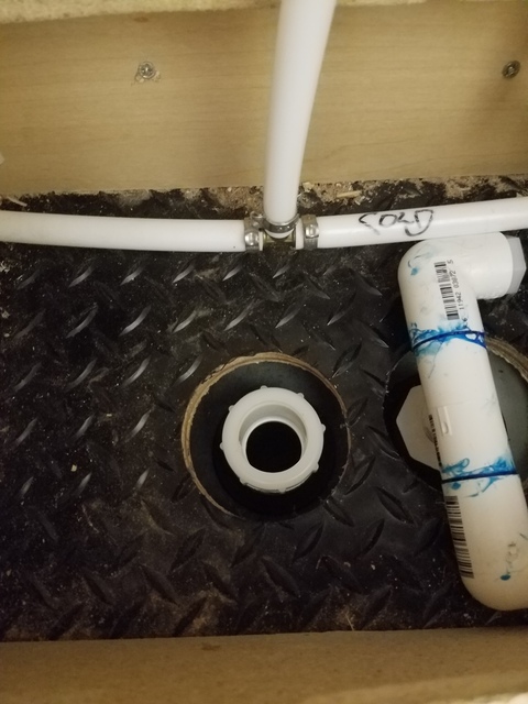

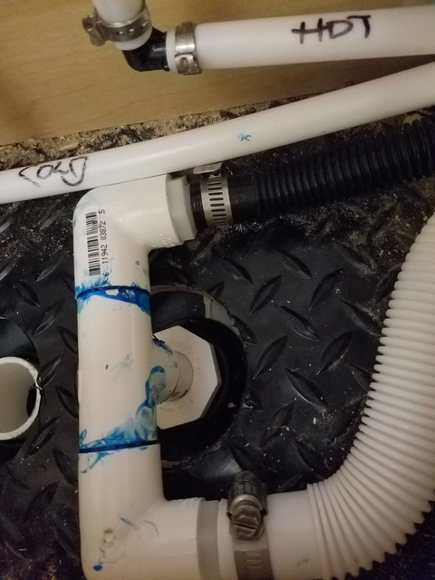

Here is a close up of what the shower drain turned out to be. It took some time to line up the main outlet and cut the wholes in the already built frame.
Different shot of the shower plumbing

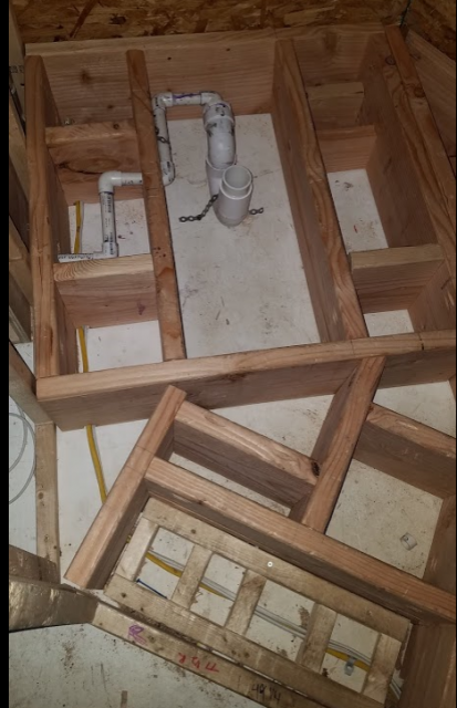

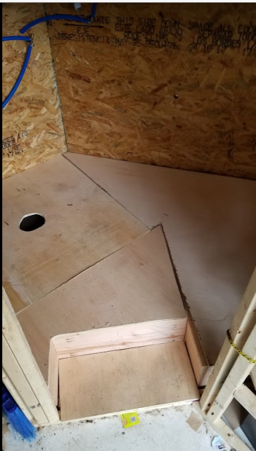

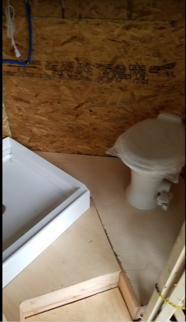

Shower floor framing finally done and screwed down into place. Plywood floor cut into place.

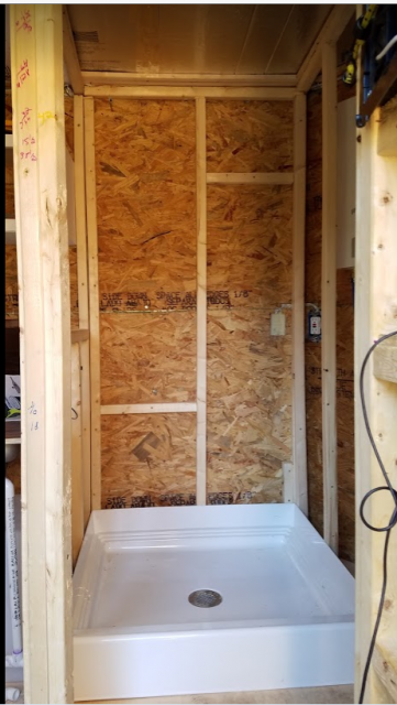

You can see the space I'm dealing with in the bathroom. Not very much. I was considering a sink, but may leave that for a future project. May just leave the water plumbing in place for now.
You can see here that I framed in the shower. I'm still deciding on how to lay the board. I was going to run underlayment (1/8 thick) and then FRP on top of that. But I wonder if I even need the underlayment?

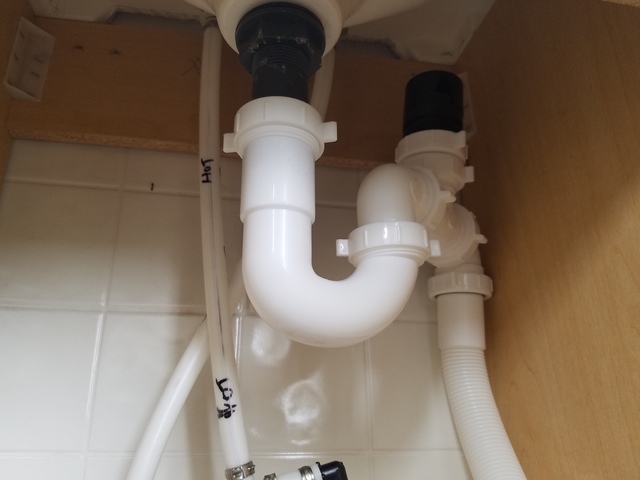

Here is what the under the kitchen plumbing ended up being. I noticed many people just drain their sink and shower directly to the ground, so I gave myself the option to do so as well. Either drain to the ground or go to the gray tank. The main downside of my under sink setup is that it takes up so much valuable space. On my next go, I would do this differently to get that space back.

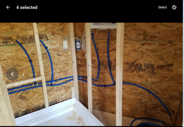

Plumbing ran in walls for cold water and hot water.

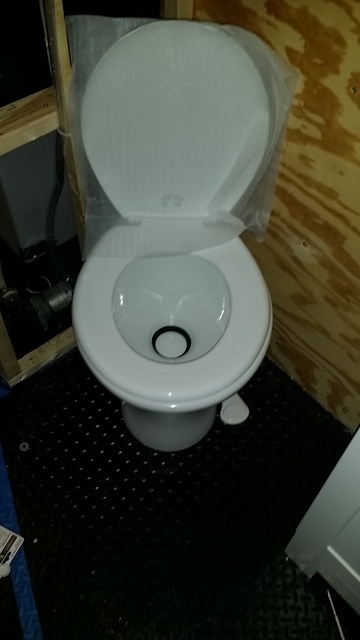

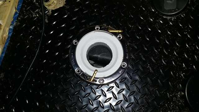

A random question, how are you all attaching your black tank vent pipe to your black tank? Just using the pvc plumbing cement? Also, Do you use glue under the toilet flange that connects to the black tank? And do you just cut a hole in the black tank and pop that flange in?

Postby flboy » Sun Nov 26, 2017 7:39 am
Jr9744, Yes, most RV's will empty tanks from one hose via two blade valves; however, there is no rule that I am aware of. You could drain your black water and then move the hose over to another outlet and then flush with the gray water. Just need to be careful or it could be messy.

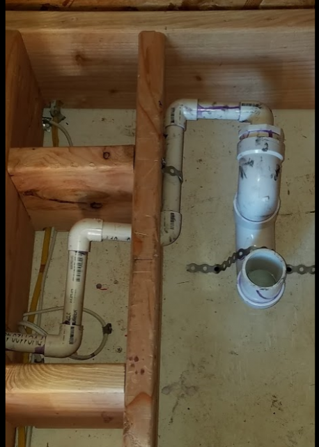

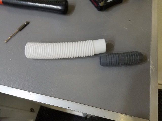

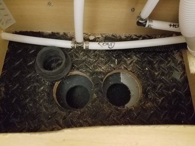

I attached some pics below to give you some ideas and it may help you recover some space under the sink since the flex hose can be creatively routed. I struggled with the PVC pipe for a while then decided to go with flex hose which easily bends around corners and I can fish it under my shower and etc... I used the flex hose after the traps to run the drain lines under the shower pedestal, around corners and at odd angles under cabinets and then joined them at the gray water input I drilled in the floor. It seems to work very well after I got the venting correct.
Note, you may want to put in an air admittance valve after your sink trap. When you empty your tank, the vacuum may pull the water from your trap and then you will have gasses possibly back up into the camper. Also, your pipes will "gurgle" and drain slowly as they try to get air to replace the water draining down the pipes (may also pull water out of your traps). Think of it like the vent on your gas can when you are pouring it. Without that vent, gas comes out slowly then gasps for air . You can see the little black vents I have in the pipes right after after the traps (downstream).
The Vanity trap and vent.
This is a close up of the hose and what I joined them with. I think the white flex hose comes in 6' sections with the non-flex pieces are every foot so you can trim the hose and still seal it off with a hose clamp on a fitting.
I used a rubber flex joint since the black water tank already had a vent flange .... however, in the absence of that and if you have to cut your own vent holes, just use the rubber grommets to stick the PVC pipes into. It will seal well. It is not under any pressure in the tanks so a good rubber press fit is good enough for the vents. I did my gray water inlets and vent this way also. On the black water tank, I used a 3" grommet that the toilet flange pressed into. No Glue.
My tanks are under the floor, but you can see the 2" rubber grommet off to the side in one picture... then I presses the 2" PVC into the grommets and they seal off. Once the PVC is in, you can connect up any way you want.
Black water connection. 3" Grommet not shown... but same as the 2" grommet.
Toilet flange presses into rubber grommet. Make sure to have the sizes correct. It should be a snug fit.
