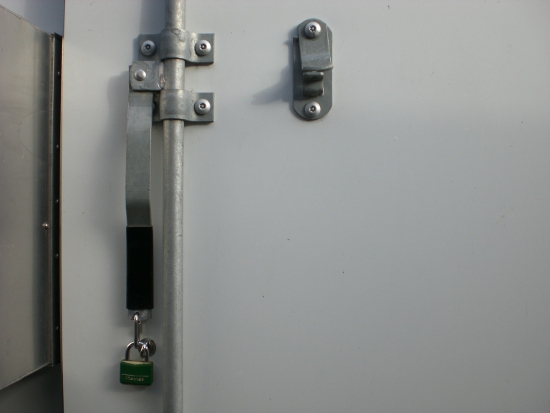

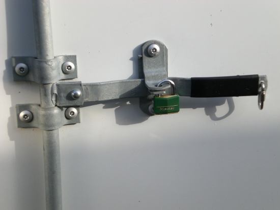

Here's my fix for the issue of possibly being locked in your own trailer. With the handle locked open, it can't happen.
1. Locked closed, but note cut-away rubber handle tip and hole drilled for SS carabeaner
2. Locked open with SS eyebolt and carabeaner

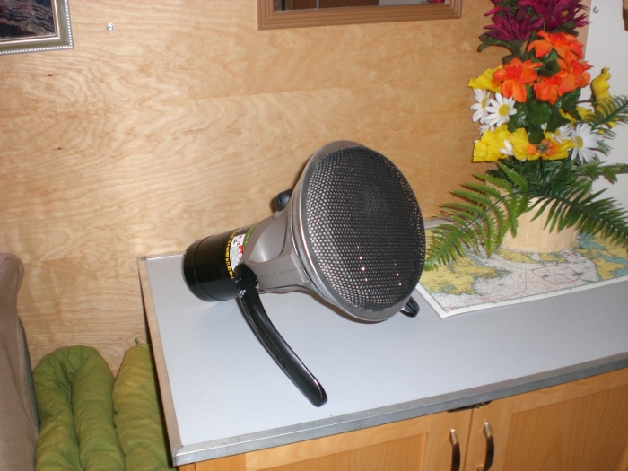

Coleman BLACK CAT HEATER (platinum catalyst)
Our cargo comrade Gonefishin was right! These heaters work great and give off no fumes. I put my nose right above the thing turned to high and could smell nothing. It takes up very little space too!...and definitely beats installing a wood stove. Highly recommended.
I got the basic model without the small fan...on sale for $55 ($79.95 retail) at Fred Meyer's right after Xmas.
