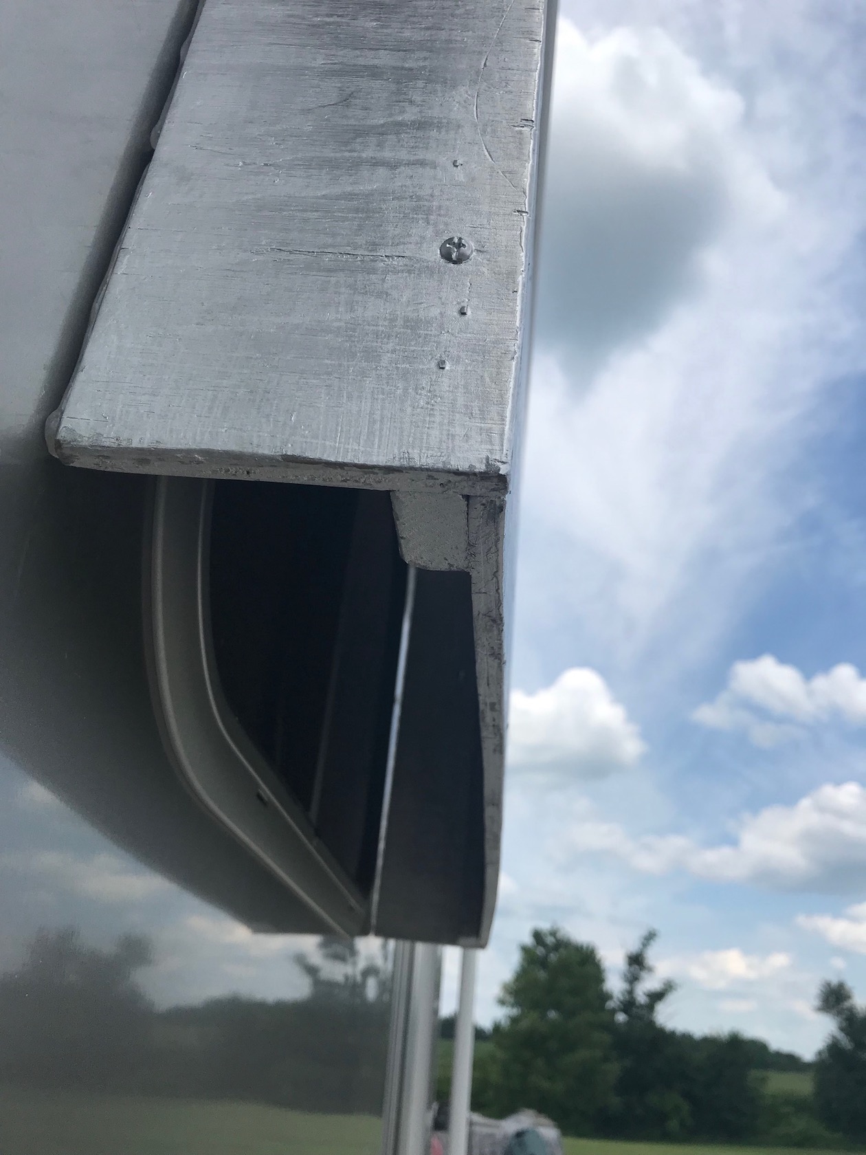

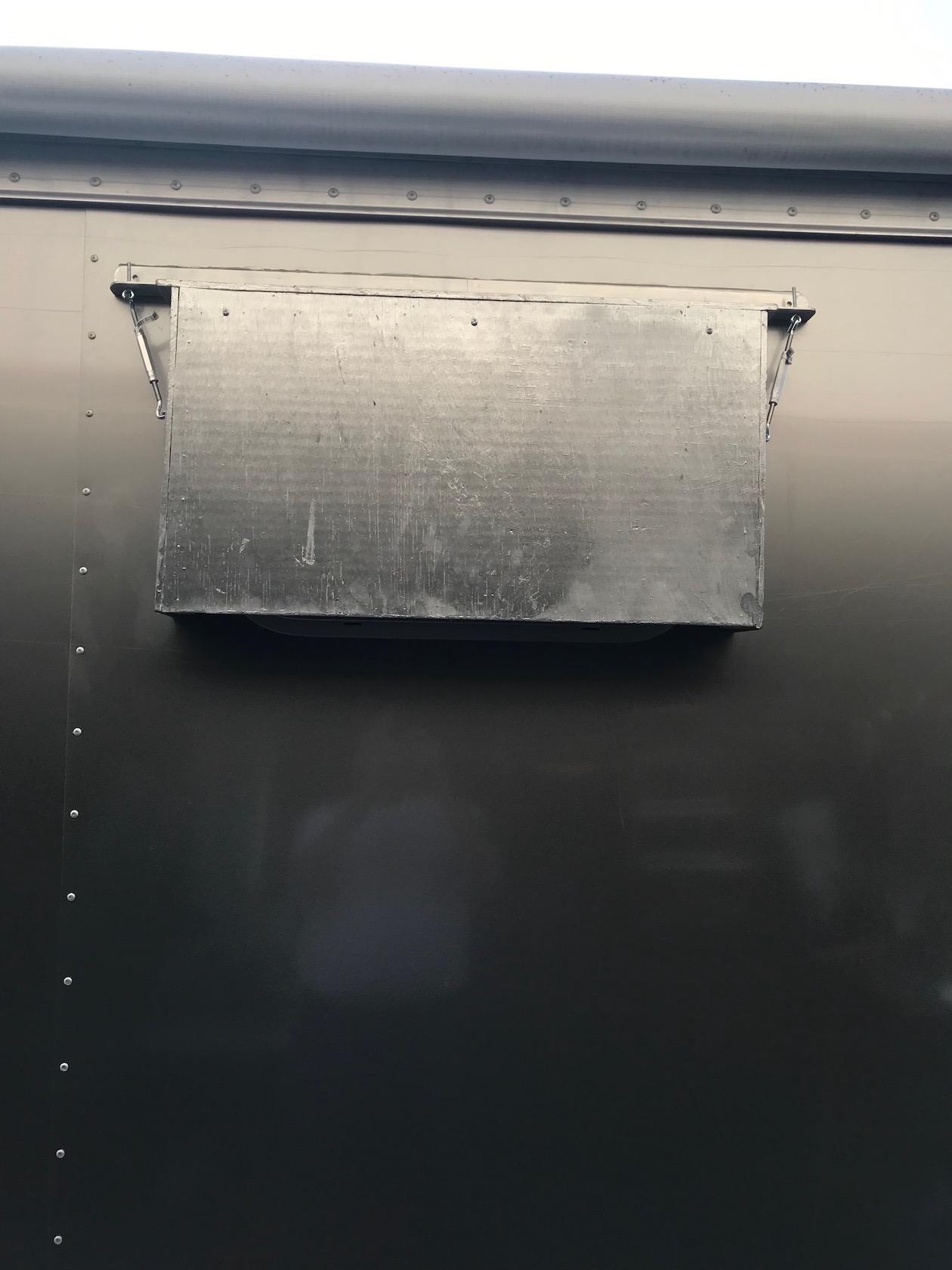

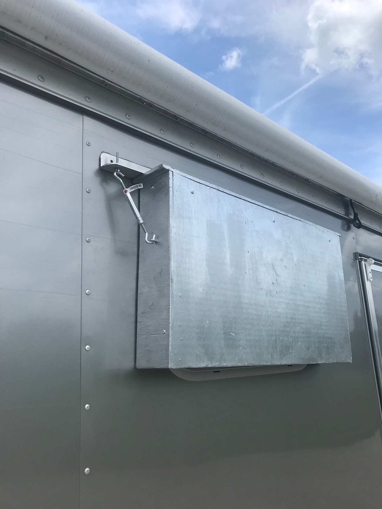

When it rains I cannot open my slider windows so I fabricated two rain covers out of scrap 1/4” plywood as prototypes to see if they will keep the rain out while still allowing sufficient air intake. The opening at the bottom of each cover is 4”x ”28”= 112 sq. inches of opening.
I slapped on some oil based paint I had laying around to make the covers halfway presentable and to protect the wood.
I attached an aluminum angle above each window with 3m VHB tape so that the angle is removable without marring the skin of the trailer. I laid a bead of silicone caulk at the top seam where the angle meets the skin hoping to prevent water from possibly degrading the VHB tape.
I attached an eyehook at each end of the angles and on each side of the covers.
I laid a bead of clear silicone caulk around the edges of the covers that make contact with the skin to prevent marring the skin.
A turnbuckle hooked to each end of the cover and to each end of the angle holds the box up tight under the angle or alternatively, allows creation of a slope to shed water to the front or rear of the trailer, depending upon wind direction.
It is supposed to rain tonight with 20pmh winds so I might sleep in the trailer tonight to test how these covers work.
I used 6 screws to make each cover which will enable me to take the covers apart and store them flat. I suspect it will only take about 5 minutes to assemble and install, likewise to remove and disassemble, give or take a minute or two.
I am hoping that my Maxx Air fan will exhaust out strong enough to prevent rain from entering through that roof vent.
Below are pics.

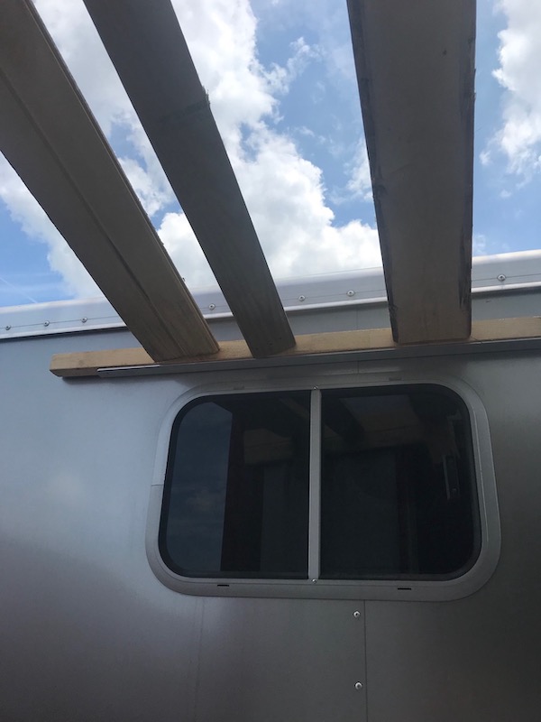

Postby featherliteCT1 » Mon Jul 29, 2019 2:45 pm
Here is a pic showing where I wedged some wood braces up against the angle to put pressure on the VHB tape to increase adhesion as the tape cured. I parked my trailer close to my barn so I could use the barn wall as a base to push from. The skin was fairly hot so I think it will adhere well enough for the intended use.

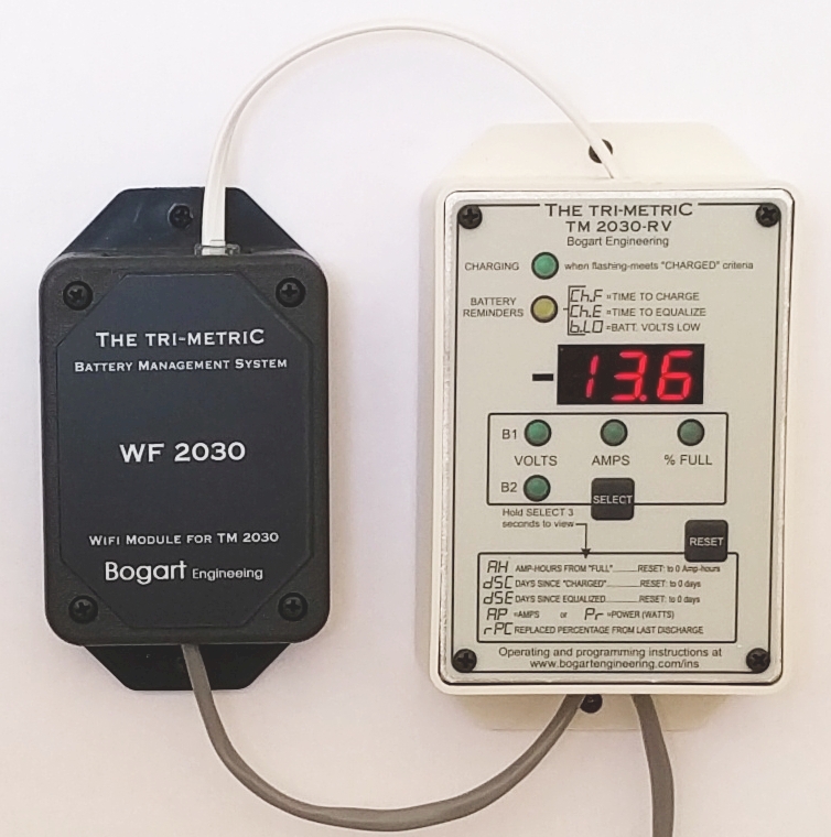

I just purchased and installed the new Bogart WF 2030 wifi unit that transmits data from my TM 2030 battery meter and my SC 2030 charge controller. Now I can read all battery data and reset any of the charge parameters remotely. I can do so on my phone or laptop or any other device with a web browser.
The WF 2030 is the black unit.
200209 WF2030 TM2030.jpg (330.48 KiB) Viewed 4482 times

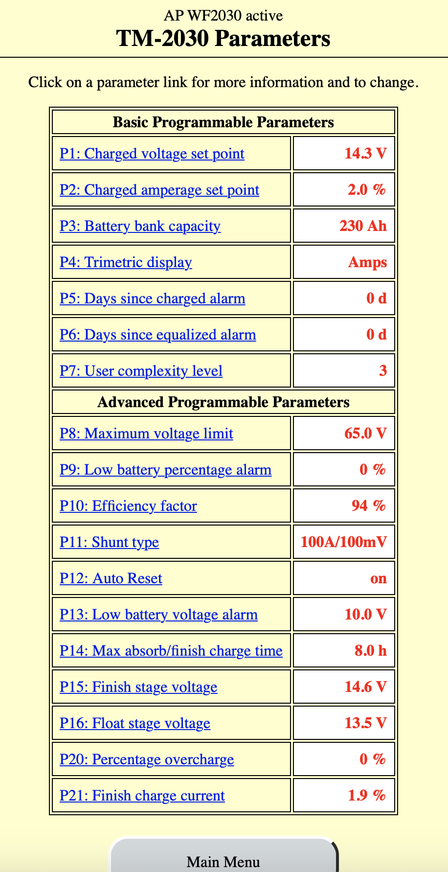

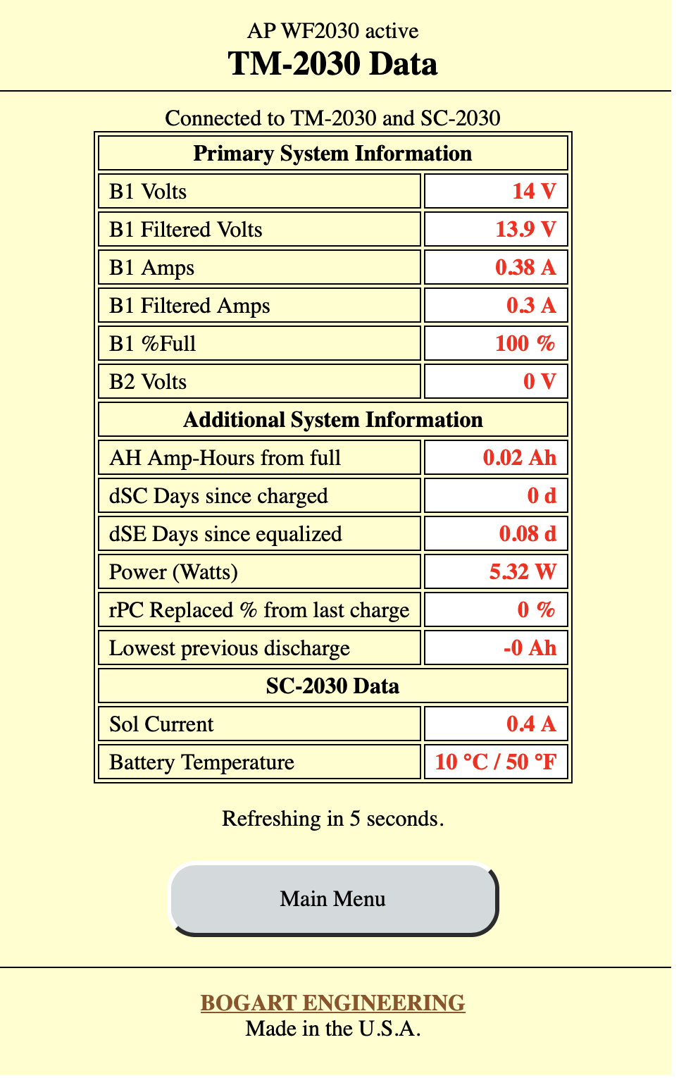

Below are two screen shots from my phone. One screen shot shows current data, the other screen shot shows all my charge parameters,
For me, this is the cat’s meow.
WF 2030 unit cost $99 and was simple to install.

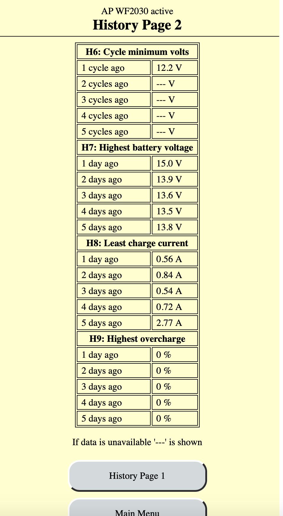

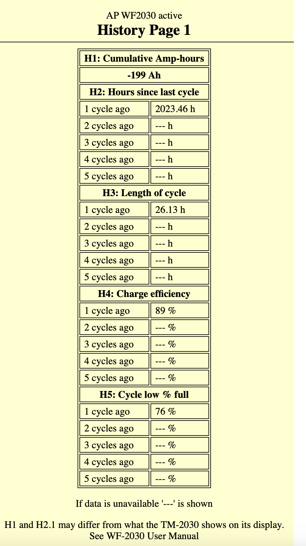

Below are two two screen shots showing History data (I just reset all history data so no prior history data available except for today’s data).

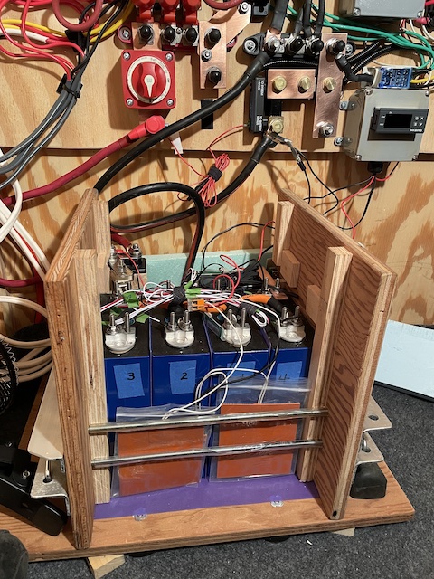

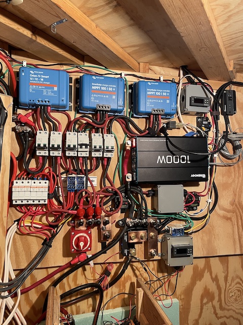

Postby featherliteCT1 » Mon Apr 24, 2023 12:31 pm
I removed my 12v 235A lead acid battery and the Bogart charging system and installed a 280A Lifepo4 battery I built, along with some Victron charging components.
I have a string of three (3) 100 watt 12v panels mounted on the roof of my truck plus a second string of three (3) 100 watt 12v panels mounted on the roof of the trailer. Each string is wired in parallel and then the two strings are combined in parallel inside the trailer. Thus, I have six (6) roof panels. Each panel is protected with a 10A Din rail mounted fuse inside the trailer.
I have a string of four (4) mobile 100 watt 12v panels, ground mounted, that I can place up to 90 feet away from the trailer, via a two pair 6 AWG wire. The panels can be wired 2P or 2S2P, to harvest sun when the truck and trailer are in the shade. The ground panels are not separately fused inside the trailer. I over paneled my system to hedge against several continuous days without sufficient sun.
Each roof panel is protected by a 10A inline fuse at the pos MC4 pigtail at the panel. I do not think these fuses are helpful but I installed them anyways because I already had them in stock. Each roof panel is installed with a separate two pair 10AWG wire running from each panel into the inside of the trailer, whereat each pos wire connects to its own Din rail mounted fuse before being combined in parallel for entry into the mated MPPT charger.
There is a Victron:
1. 12v Dc to DC charger, maximum output 18 amps, hooked up to the truck alternator.
2. A 100/50 MPPT charger fed by both strings of roof panels, with switches to feed the charger by either or both of the strings as necessary.
3. A second 100/50 MPPT charger fed by the ground panels.
4. A 500A Smart shunt
5. A Smart temperature sensor.
6. Not shown is a Victron IP22 smart 120v AC charger which charges the battery with 30 or 15 amp hours, depending upon which setting is chosen.
The Victron equipment is smart blue tooth equipment paired together so that I can see data on my iPhone.
I have two (2) Bee Hive heaters, 12v 12 watts each, controlled by an Ink Bird thermostatic controller to heat the battery when necessary. Wired in parallel and in series causes the heating pads to heat up to temperatures of 170 F and 95F, respectively. I suspect that 95F will be sufficient but time will tell, depending upon how cold ambient is.
The 12v battery is wired 4S and is protected by an Overkill Solar 120A 12v BMS.
The wiring shown in the photo, running to and from the chargers, is 6AWG welding cable. The wires to the inverter are 2/0. There is a 2AWG wire grounding the system to the frame of the trailer.
There is a 100A MRBF fuse mounted right on the positive battery post, and three (3) 60A MRBF fuses on the pos bus bar related to each charger.
The Din rail mounted breakers below the Victron equipment are rated at 63A but I only use them as infrequent switches. My testing discloses that I can only run about 40 Amps through each breaker because more amps causes the breakers to heat up excessively ... the downside of a 12v DC system.
The 1000 watt inverter is controlled by a second Ink Bird thermostatic controller connected to a relay to turn the inverter on and off in order to cycle a 120v AC freezer I installed, with the freezer set up to cycle like a refrigerator. I have a spare inverter in case the repeated cycling on and off of the inverter will cause the inverter to fail. I successfully used my lead acid batteries cycling the inverter on and off for two years without incident. I fear the low impedance of the Lifepo4 battery may slam the inverter with too much start up current and ruin the inverter. We shall see. If so, I will use a different kind of Ink Bird temperature controller that will be powered directly by the inverter, with the inverter turned on at all times and no cycling.
A 12v diesel heater is also powered by the battery but not depicted in the photos.
I am in the process of rigging up an insulated box to envelop the battery while the Bee Hive heaters are heating up the battery.
