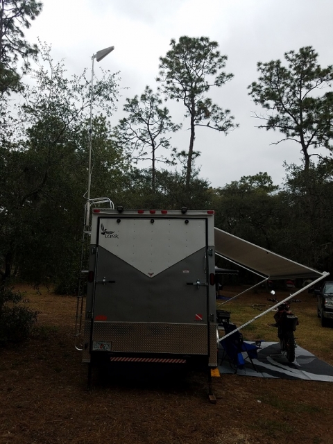

Postby Iconfabul8 » Sun Jul 15, 2018 5:38 pm
Ramp looks great! Mine is still bare wood, maybe that will be the next on my 2Bdun list.
Tell us about that thing against the spare tire. It appears to be a directional antenna of some sort (tv, wifi, cell, or ham?)
I am currently in the market for a wifi extender for the CT. Been looking at starting with these and maybe go to an outside
antenna if the stick on the window method doesn't work. They do however seem to get some pretty good reviews.
https://www.ebay.com/itm/110483822799
https://www.ebay.com/itm/380511450305
https://www.ebay.com/itm/110952351863
Iconfabul8
Posts: 624
Images: 14
Joined: Sat Apr 30, 2016 6:15 am
Location: Southern Utah
Re: 7'*18' V-Nose Cargo Trailer Toy Hauler Conversion
Postby flboy » Sun Jul 15, 2018 8:23 pm
Hi Iconfabul8. That is my High Gain Directional I use with my SureCall Fusion 4G Cell Phone Booster. Typically, if I can get a weak 3G signal outside with my phone, I can use that and have a full strength 4G LTE signal inside the camper. You have to have something to amplify. This antenna has 12db of gain in forward direction (each 3db doubles signal strength) . I just point it ( I have an App) in the direction of the nearest tower and let it do its thing. It works with all North American Carriers. I can stream Netflix with full bars in my camper with only a weak signal outside. Typically, you need something to help unless you are real close to a tower given the aluminum shields all the signals from your cell phone when you are inside anyhow. This setup allows me to operate in the fringes as well. Here is a pic of it deployed when camping in ONF. There have been times where my phone could not detect a signal, and I still was able to pull it in with the directional. It has gain in both directions (transmit and receive) and the inside unit repeats and amplifies way beyond what a cell phone has the capability to do.
In an urban setting, I have an omnidirectional which I do not need to point. It has lower gain, so in the really fringe areas, I need the extra gain and use the directional.
For a WiFi range extender, definitely get something with an outside antenna. The aluminum skin on a trailer kills/shields the rf signal. If you get anything, it is coming through a window or top vent cover which may not be the ideal angle or etc. for line of sight. I have a WiFi range extender, however, so far, I have never been in a spot that had WiFi available where I could not get my 4G LTE signal which always turns out faster.
