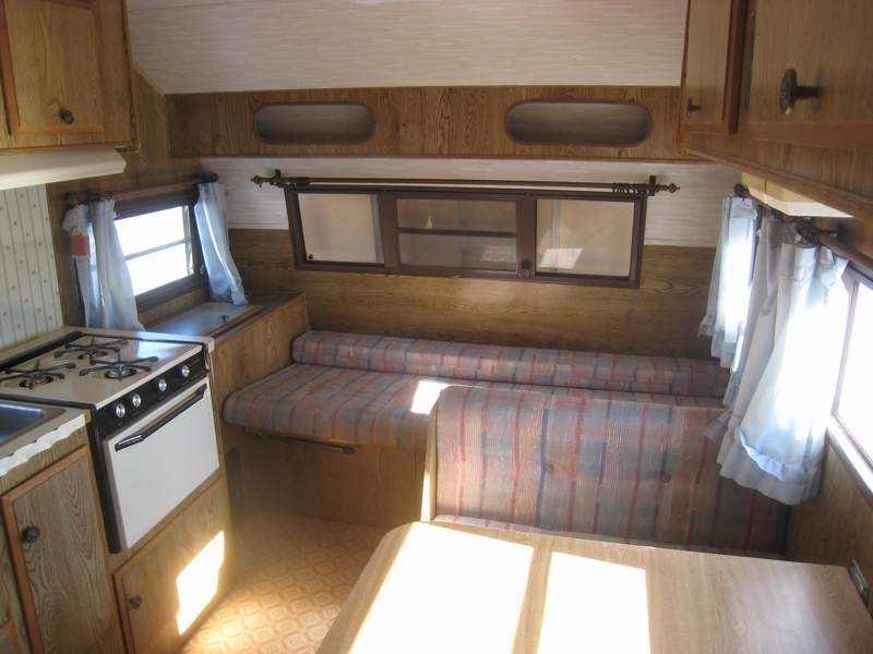

You asked me a while back for some Interior pix, for layout ideas, of a pal's 14' Wilderness TT. I bought my own TT this week instead! My layout is pretty much a mirror image, front-to-back, of his. Not having the front slant over the Couch/Bed as I do, his has a limited-weight, fold down upper Bunk instead.
Should be fun cuz I can concentrate on upgrades and Geek Tweaks instead of ground-up building that I don't have time for just now. We sho collected 'stuff' that can be used in the Trailer. I've got spare Propane Tanks; Deep Cycles; Hoses; you name it. See the Post under 'General Discussion'.
I REALLY like starting with un-modded Factory condition because I like to 'hide' changes whenever possible. About all the Wiring and Plumbing is accessible and on the Sink Side, so that makes life much easier. Just let the 'magic' happen invisibly, be it A-V or energy-related, etc.. There's nice Luan under the 'OK' color Contact Paper, or I might someday stick on some neat, real, ultra-thin Wood made for re-skinning Doors. First, some overdue Camping fun, as you mention above, w/documenting pix to follow.

Checked the "General Discussion Forum" and read your post re: the 14" Wilderness TT and hope you will post more here or on the GD forum. I hope to follow it closely. Looks like a whole lot of fun! :D Please also post more pics of your TT interior. In terms of a TT I am looking to go smaller than my Jayco 16.5 if possible so any thoughts, help, or info you can provide would be appreciated.

As did my pal who got a nice '88 15' Wilderness, I looked at a ton of stuff on line, and some real junkers in person. One promising unit near our W. CO House had a Ceiling I couldn't stand up straight in, never mind the dropped A/C Vent. Say what??? The good/bad news is that the smaller Trailers are around, but a lil hard to come by. I wanted single axle, and a layout that worked for the 2 of us. I know that Dry Weight is fantasy, but this unit rates at 2,600 lbs.
Great Thoughts are to bag the Dinette in favor of using either some real campy old TV Trays from the Mom-in-Law. Or, having used them more than I can recall, I might make some simplified Airplane Trays. Simply putting the Table up made a huge visual impact on space. Since the Passenger-side Axle box makes it impossible to seat 4 at the Dinette anyway, I plan to flip half the Dinette 90 degrees to hug the wall just inside the Door, and remove the other half. This leaves room to convert the Gaucho Couch to a ~5'6" wide, near-full length pseudo-Queen Bed that will just clear the Oven Door. When plugged in, a Microwave and Dish Network Receiver can tuck in by the Ceiling, right of the Stovetop. They'll be a place to sit on the remaining Dinette Seat half inside if someone wants to sleep in.
I've got a handy Gaucho 'model' to kinda follow in my '31 Avion with a simple pull forward bottom on routed side rails. K.I.S.S., lightweight 1x? construction will be the rule. A 'Pro' Neighbor can do Cushions on good Sleeping Foam.
There's nice room on the Tongue for a double Battery Box, and for the 30 lb. Propane Bottle included. I've got a spare 40 lb'er around from House Construction. There's also plenty of room inside for 'toys' and necessary Gas Detectors, etc..
Quickie upgrades already include a Propane Gauge; new Safety Chains; and a Breakaway Switch. The Chains were really undersized from the Factory, and there never was a Breakaway Switch. Weird, but easily solved. The new A/C and unused 3kW Generator in the package closed me!
