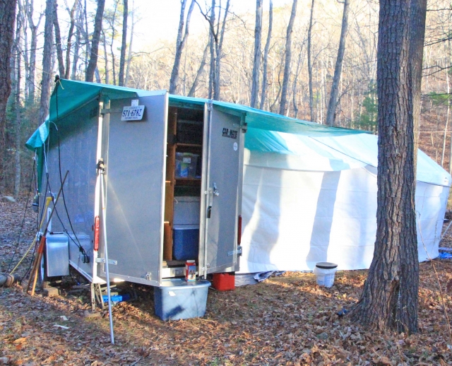

Camp Setup

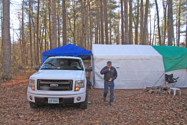

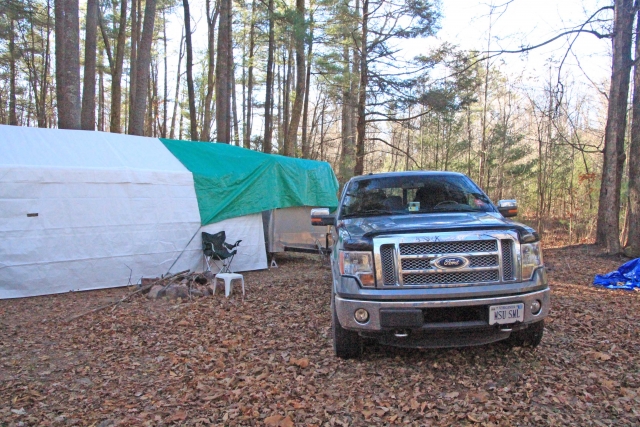

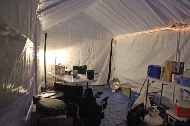

My hunting friend and I set up our normal hunt camp this year in the George Washington National Forest in the western part of Virginia.

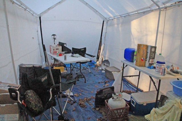

It consisted of a typical 10'x20' vinyl portable garage with my CT at one end and my friend's Truck at the other end with a 12'x12' canopy at the other end. Then we use the 10x20 canopy as our cooking and eating area.
Our drive down the National Forest roads.
Camp Setup

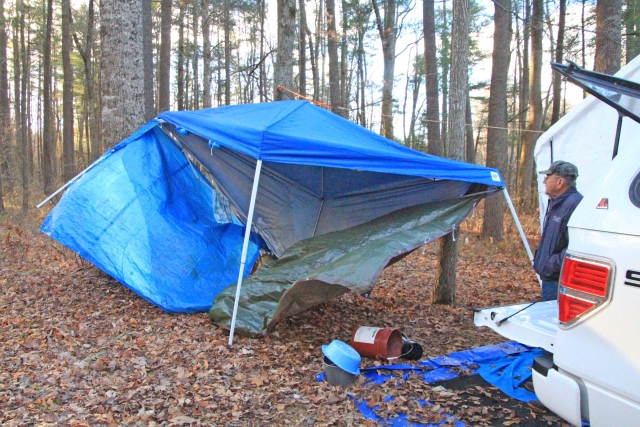

It started to rain right off and sure put a damper in our plans. But we tried to hang in there until the wind came in 20-40 mph bursts.
The canopy went flying in the night and put a nasty scratch on my friend's truck.
When the forecast was for 50 mph winds, we gave up and pulled stakes.

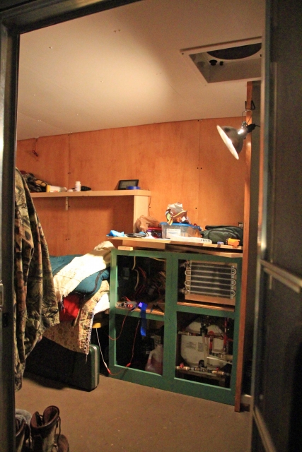

Water Heater heating system.
My hot water system worked very well; circulating hot water from the water heater thru tubes in the floor and thru the transmission cooler with a 12V PC type fan.
It got so warm that I had to throw covers off of me during the night.
But I did learn more about this heating system.
Pros:
Warmth with no CO2 issues.
Easy to use.
If you already have the water heater, it is relatively low cost.
Quite effective with more capacity then used.
20 lb propane tank lasted almost a week...but not a final review as temps were mild in a way, never getting lower then 32 F degrees at night.
Cons:
Radiant tubes in floor only effective if you leave the system running all the time. No antifreeze can be used as they use potable water.
And one cannot leave water in them if heater is not in use. Storage becomes a task to blow the water out before storage. It is not therefore "ready to go" on a short notice basis. So my final take on is that radiant tubing heat is not practical for extended usage unless one keeps the potable water circulating all through the cold season. At least I tried.
Cannot go away and leave camper for trips in freezing weather unless you are sure that the propane will not be exhausted during your being away. Otherwise the water could freeze once the internal temp goes below 32 degrees F. I do realize that it would take quite a bit of time for the internal temperature to drop to these levels if everything in the trailer is in the 60 plus F degrees range.

About your heating set-up, is there a way that you can heat the water
and have a closed-loop circulation system? If so then you can add anti-freeze to it

Before you give up on the radiant tube idea, you may want to consider using a heat exchanger. That way you can fill the heat system with anti-freeze and not have to worry about draining, blow outs etc. This is just an example, but I'd just bet it would work .

Good suggestion. I am familiar with heat exchangers as I have one in my home system which I built. Actually while it works great at home, I never gave it much thought for the CT. I will not give up on it, but will put it on hold til after I get all the other items on my list complete. And it just might be adding another level of complexity taking me away of my new found objective of trying to do things more simply. Anyways as suggested above, I will not discard the idea.
