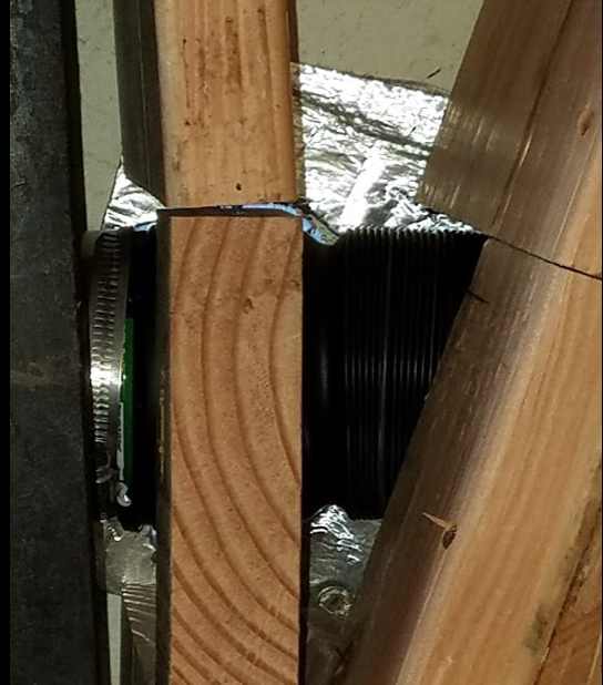

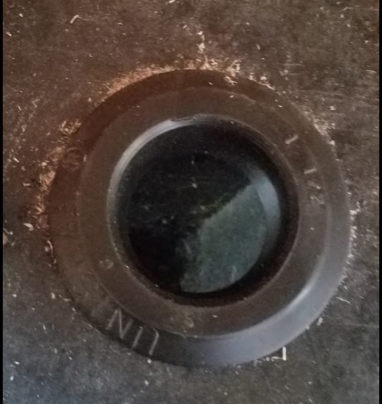

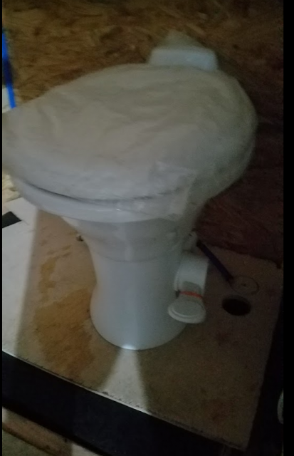

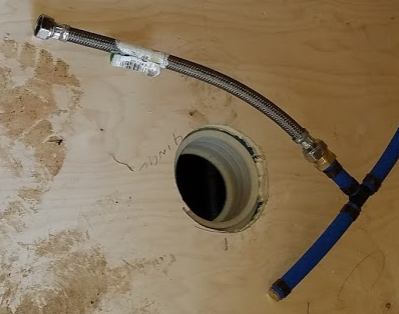

So I'm trying to get this toilet installed. Cutting the holes and inserting the grommets were way easier than I pictured in my mind. I did go to HF and pick up a new set of hole cutters.
First Grommet
Second Grommet
And then this

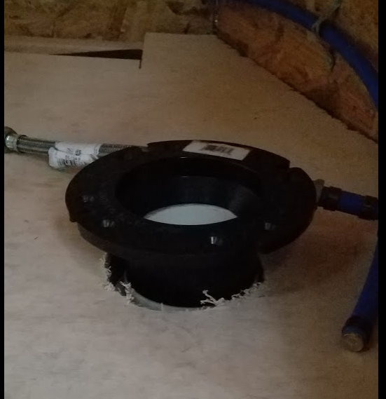

The 'flange' won't lay flat on my existing floor with the grommet and pipe attached. I'm going to do some research, but what am I missing? Did I buy the wrong grommet for the toilet? :x

What is the White Pipe for? My flange was sized to go into the grommet directly? Do you have the correct sized Flange or grommet (depending how you look at it) ? The flanges come with different end pipe diameters and mine went right into the grommet.
What diameter is the grommet? They need to be matched up in any case with the flange. You need a grommet for that air tight seal and no stinky leaking to the outside.
Following is what my grommet and flange looked like. They go together. No intermediate pipe... but I can see how that would work if it was cut right.

I had a piece of 3" pipe glued to the flange then pushed through the floor and into the grommet. About 1 1/2" into the tank, then screwed the flange to the base/floor.
McDave
That grommet looks it has a stop at bottom. Mine did not and the flange did not have a neck that went through floor, so just the pipe went through floor.

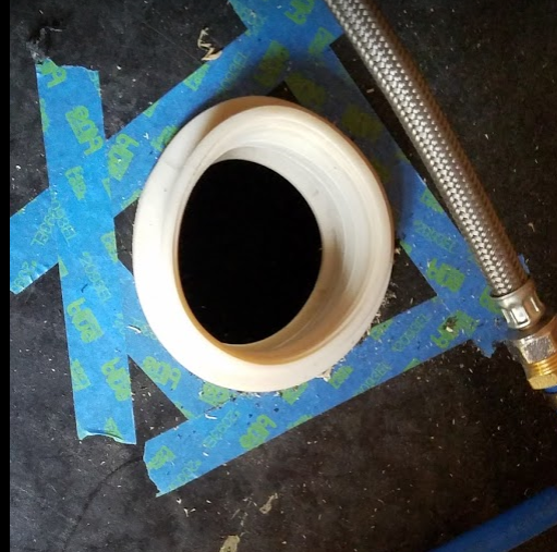

@flboy Is that a standard dometic 3" flange? If it is, where did you get your grommet from. My grommet is just the wrong size for my flange based off what you guys are saying. This is the flange have: https://www.amazon.com/gp/product/B002PURO6Q/ref=oh_aui_detailpage_o07_s01?ie=UTF8&psc=1
@McDave My grommet is not the right size for my flange. I expected it to work the way yours did, but my grommet stops my flange from going any further at a certain point.
I read that some people just glue the flange to the tank with marine adhesive. I see they sell this at HD. I was also thinking about using plumbers putty and just tightening it down good.
After I took off all the stuff, it fits well just in the hole. You can't see it, but it's loosely bolted in.
I'll wait to see what flboy says, but if I can't get the grommet quickly, I may just glue it or use plumbers putty and see what happens.

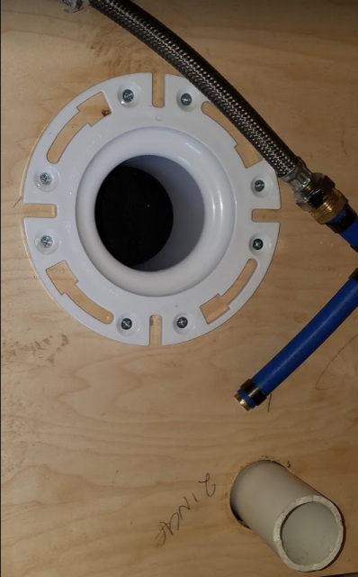

Thanks for all the information guys!!! I took flboy's advice and took my grommet and flange down to HD to see what I could figure out. I ended up finding a flange that went right through the grommet with no need for the pvc.
I am getting so close to getting my 'core' systems done that I can taste it!!!
Here is the new flange I bought that actually goes through the grommet
Grommet in place. I also changed to 3/4 inch wood for the floor. It feels much stronger. I'll have to add 1/4 inch to the rest of the floor.
Flange and floor in place

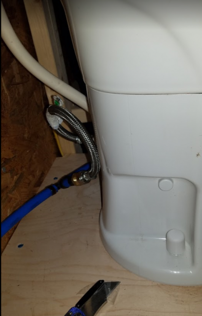

Toilet Installed!!
Behind the toilet
I also changed the drain outlet to use some flexible black drainage pipe. I got rid of the grommet and the pvc I had before.
The only thing now left for plumbing is installing the gray tank.

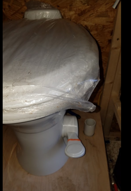

It felt so good to flush that toilet and fill the bowl with water. I think I filled it and emptied it about 5 or 6 times.

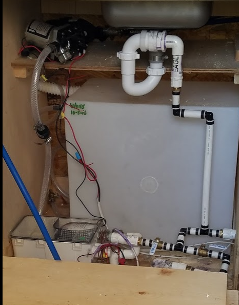

I don't think I posted this, but you can see what under sink ended up being. I changed to 3/4 pex for the drains. Used better vinyl hosing for the water pump and moved the one way filter before the water pump.
