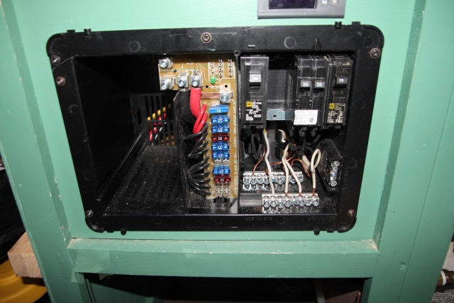

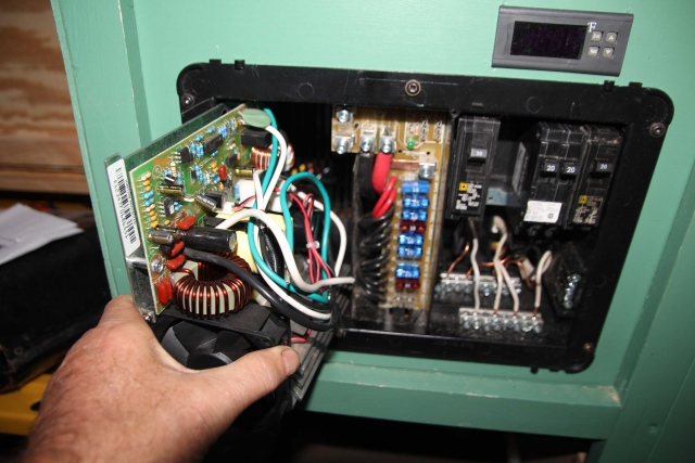

I installed the replacement charger assembly yesterday and it still did not work. So after a lot of scratching of my head, I tried to follow the AC input circuit to see if there was really current getting to the assembly. And there was not.
Opening
Replacement Power Assy
What I did notice is I could not figure out where the "120V Hot Buss" on the lower right section got it's Postive feed from. It did not make sense. So on a whim, I connected the Black Wire from the Assy. to a new breaker and viola, there was power. Now I was totally dumbfounded. It worked last fall, it worked at a TJ event last March, so why did it now work now without the added breaker to the hot buss?
I am wondering now if the first unit was defective or not. But I am not going back to test it. I will just return it to the factory. Does anyone have any thoughts?

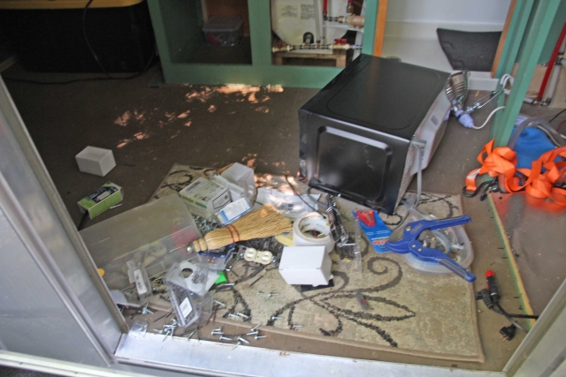

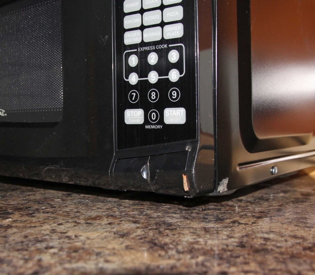

And just the humor of it, here is an image which shows why you never leave your hardware and brand new, never used microwave on your counter top while you move your trailer around (and have to go up a steep hill). Everything goes on the floor and the microwave goes to the dump. Cannot even get the door to open.
