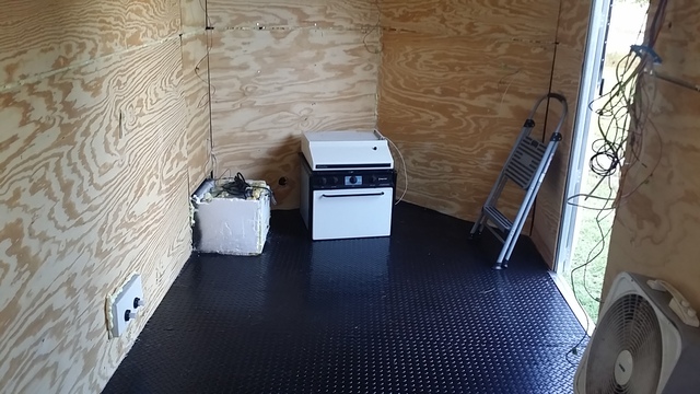

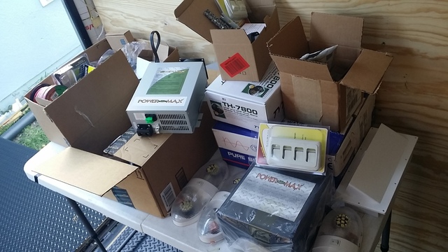

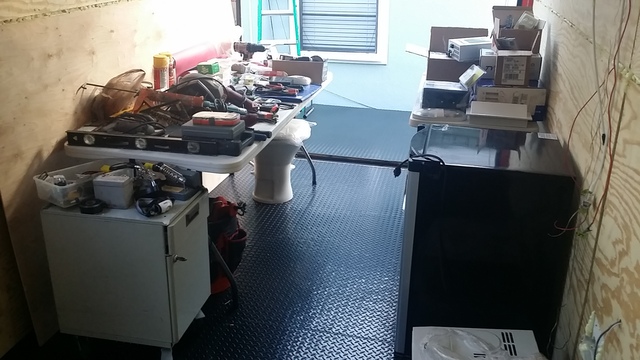

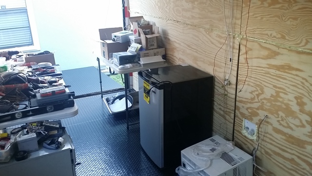

I took most of the stuff for the build out of my storage shed this evening and put it in the back of the trailer and organized my tools. I needed the AC and Fridge in there as I start to frame on the side and work my way around the front. The back part of the trailer won't see any action until I start paneling and building the loft bed... so it is a good place for it right now where I can access things and measure as I build.
The Fridge and AC.
All the fun stuff to install.
The Stove/Oven and hood setting up front out of the way. The stove/oven will be built into the counter right over the water heater and share a common wall with the shower.

Postby hankaye » Mon Jun 27, 2016 7:54 pm
flboy, Howdy;
Coin mat looks good! Really, an oven??? Must eat a lot of pizza when you're camping ...
A lot of the RVers that I know use a 9" X 9" X 3/8" stone (HD or Lowes), to even out
the heating.
Well, you are proving the old adage, that things are easier the second time 'round.
You've definitely got some organization going on there.
