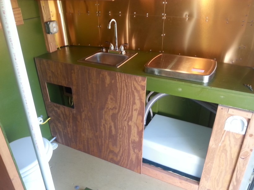

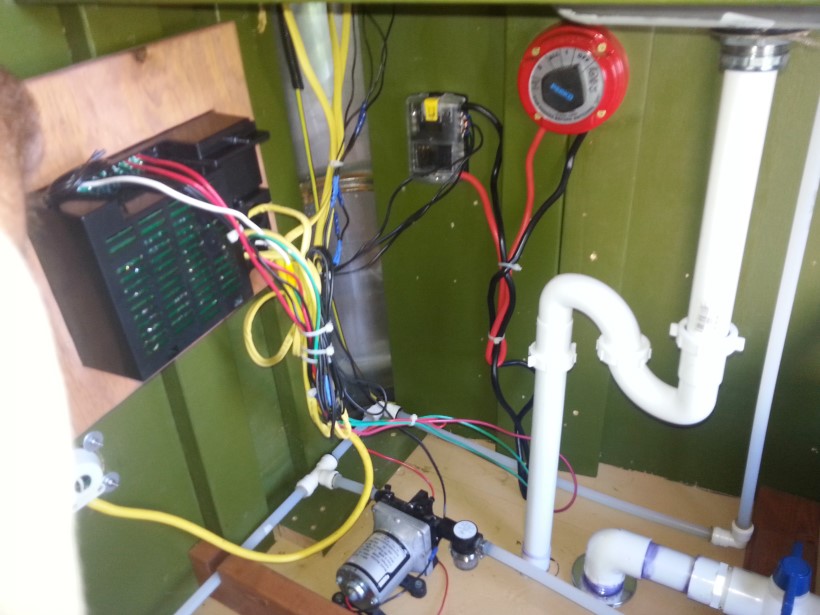

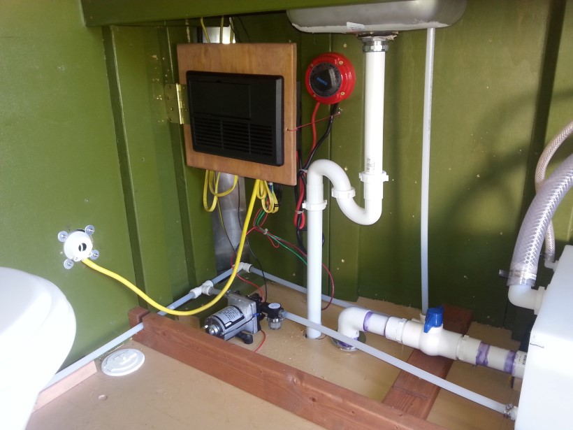

Ok That's it for the electrical. Tidied every thing up a bit. Big yellow wire acts as harness support and provides stability to it all. Just worked out that way.
So I really needed that DC buss after all. :thumbsup:
So only now do I feel pretty good about it all as the lights are bright and the water pump works 100% of the time. Even if you do the river dance in there. :)
I'm going to take a much needed financial break from it all as well as a week to figure out a few more things.
Need to fish and boat some to decompress.

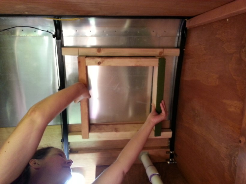

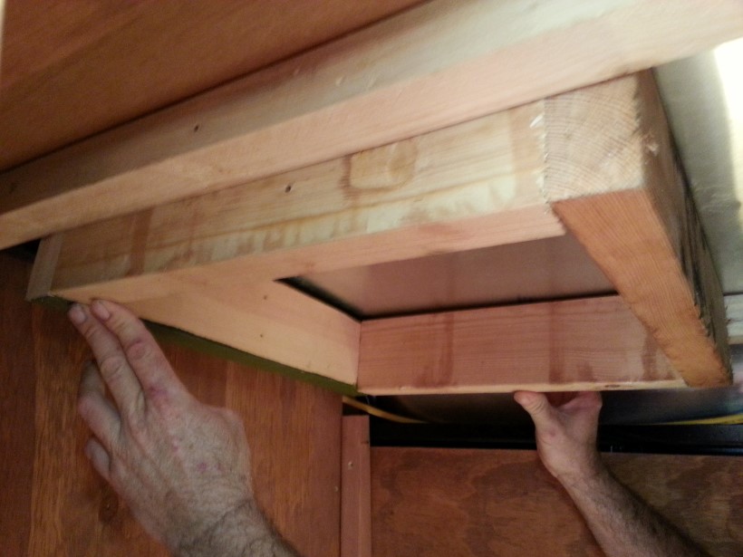

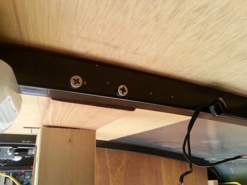

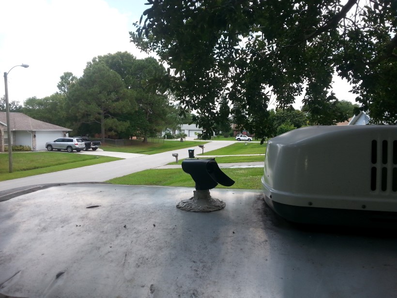

So I would like to maybe install that vent with fan in the ceiling.
question #1. They range from 45-140 dollars depending on brand. Maxx-Air looks the best. Manual crank with cover. $133.00 or so
Hengs is $40.00 dollars but what does that get you?
question #2. From what I can tell they all will fit in a 14x14 hole. Can I just cut that in my roof and then putty/screw/silicone in place? Is it so heavy that I need a square frame/bracket underneath for support? I envision this sagging a bit but have no idea.
Tommy B
Posts: 891
Joined: Sun May 08, 2016 4:37 am
Re: HALLMARK 6X12 CONVERSION
Postby Tommy B » Mon Jul 18, 2016 9:49 am
It appears from a video that there is a robust wood frame for support that the fan screws into. Makes sense but I will have to measure and see if it will fit here. I have that wood strip running front to back that may hinder things and then there is a riveted seem that also runs front to back. Cant cut that and don't know what that thin wood strip is hiding. :thinking: :thinking:
Needs to go to the right of the 2x4 and between those two metal roof supports but not too close to that seem. Is his possible? :thinking:
The MaxxFan installs into a standard RV roof opening of 14 by 14 inches.
To determine if your roof opening is correctly sized, simply remove the interior ceiling garnish trim ring of
your existing roof vent and measure the ceiling opening or verify the opening is large enough by sliding the
MaxxFan interior Garnish trim ring into the opening.
The MaxxFan is designed for a minimum roof thickness of 2 inches to a maximum of 6 1/2 inches. If your
roof thickness is less than 2 inches, build additional thickness at the ceiling opening using wood or other
suitable material.
The MaxxFan requires a minimum 12 Volt DC, 5 amp service. Confirm that the circuit you intend to use will
accommodate the additional load. Use the proper gauge stranded wire for electrical connections.
Hmmmm, found that tidbit. Not sure about this now. :thinking:

Postby Tommy B » Mon Jul 18, 2016 2:11 pm
Will that slight slope mess things up even if I do construct a frame? It will not be centered either and I'm not sure about this at all. I will wait for some advice here or just pass on the fan all together. Not sure about cutting such a big hole in the roof. :thinking:

Postby McDave » Mon Jul 18, 2016 3:18 pm
Hey Tommy,
I'm not sure about all the fans, but the one I put in wasn't much heavier that your normal vent. The wood frame serves two purposes. 1) something for the screws from the roof side to bite into and 2) act as a spacer to resemble the roof spars and keep everything even when you put the lower trim ring on. As far as weight, its not really much more than a couple pounds. I cut hole 14x14, butyl tape, screw it down, then the lap sealant. Easy peasy, Lemon squeazy. I told you about the Heng"s combo fan/light/vent I installed and I must say it works good for my purpose which is to exhaust bathroom of steam and other "gasses". You also get the light from the "skylight" and at night the lights work fine. My only complaint so far is the quality of the lid or "skylight". It is so thin and brittle that I cracked it while I was installing it. :x I used some super glue inside and out and so far no leaks, but damn...

Postby Tommy B » Mon Jul 18, 2016 7:30 pm
Helloo Mvdave.
Good to see you survived the mayhem of bear tooth.
I could not let it rest and did this with scrap after work. just a mock up again. Yes I should be able to do this.
Still :thinking: :thinking:
Postby Tommy B » Tue Jul 19, 2016 4:52 am
Ok its the next morning.
yup. that's going to be it. I will remake the box fresh stained 2x4. I will reuse the 2x2 rails, just stain. Anchor to frame with L brackets.
It protrudes a lot but my head does not hit the box. It will not be pretty but I will see what I can do. Hope it doesn't suck up my wife's hair.
Yes Mcdave I did read about the fragility of the Hengs lid. It was recommended to go Maxx-Air but what a price diff. However any leak is critical. Maxx-Air for me.
