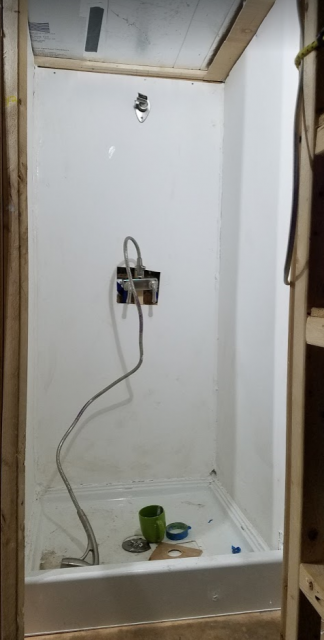

I don't think I posted this, but here is what the shower looked like for the trip. I'm not to sold on the shower handles yet. They seem to leak and it comes from inside the handles.

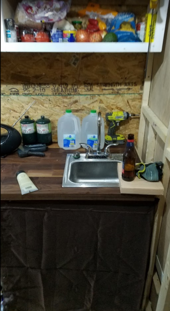

Kitchen ready pre-trip

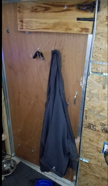

I had to add an extra latch to the bottom of the door to stop the 'draft' of cold air coming in. It really did its' job. I also added some hooks and a handle to close the door. Once it's finished, i'll put some nice hooks on the door.

- Shower draining issues. I'm not sure if this was due to 'frozen' pipes or just poor drainage, but my shower doesn't drain well.

About your "leaky" shower fittings. The ones made for RVs and some of the household
ones have a drip feature designed into them so that they dribble when you turn off the
flow at the shower head and also when you turn off the water so that the hose can drain.
hank
hankaye
Posts: 2567
Location: S.W. New Mexico
Re: 7x7x16 V Nose Cargo Trailer Conversion, First Build
Postby jr9744 » Tue Dec 26, 2017 10:44 am
hankaye wrote:jr9744, Howdy;
hank
Mines are dribbling where the handles are to turn on and off the water. In fairness, I'm not using the washer and tightner thing they gave Me, but space is tight. It's also all plastic. I may replace it, any suggestions?
Sent from my SM-G935U using Tapatalk
7x7x16 V Nose Travel Trailer, First Build...In Progress
http://www.tnttt.com/viewtopic.php?f=42&t=68569
jr9744
Posts: 165
Images: 311
Joined: Mon May 08, 2017 3:15 pm
Postby hankaye » Tue Dec 26, 2017 4:17 pm
jr9744, Howdy;
jr9744 wrote:jr9744
That dribbler valve is where the hose connects to the faucet housing, if that helpa any.
Sorry, should have mentioned that first time 'round.
hank
