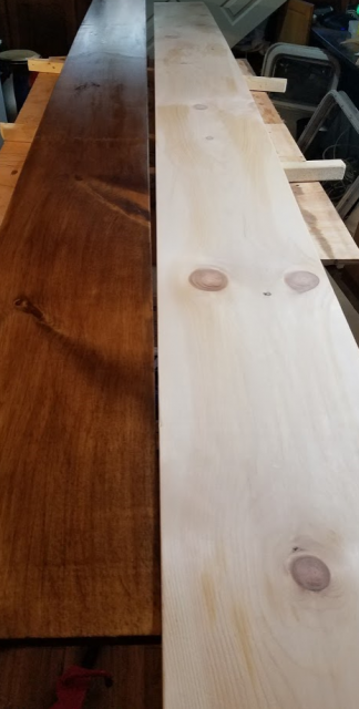

[quote="jr9744"]Allright, so testing the shower is on hold because we are at about 20 degrees today. I plan to buy some more 'rv' antifreeze just to do some testing. Now the tanks are empty since my trip.
Since I now know that I can stick to state parks for the time being and be able to shower and use the toilet there, I'm focusing on the floor, floor insulation, and fixing the pin holes I put in my roof with the solar panels.

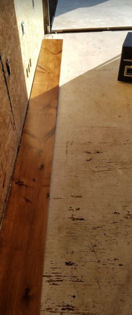

I've basically have done all the sanding and painting by hand. Preparing floors is very labor intensive, but I'm happy with my result of the first panel. It can only get better. A before/after pick
Inside the trailer
Considering I've never done this before, I'm very pleased with the results. 9 more panels to go!!
jr....the floors look great :D :D I did a restaurant in Houston about 30 years ago using this same material. About 5000 s.f. After we had it installed and 1 coat of
finish on it we went back and beat the He## out of it with some towing chains.......gave it a distressed ....older....look. We then put 2 more coats of
finish on for protection. Held up for 5 years in a commercial application. Owners were ecstatic with the appearance. Keep on keeping on!!!

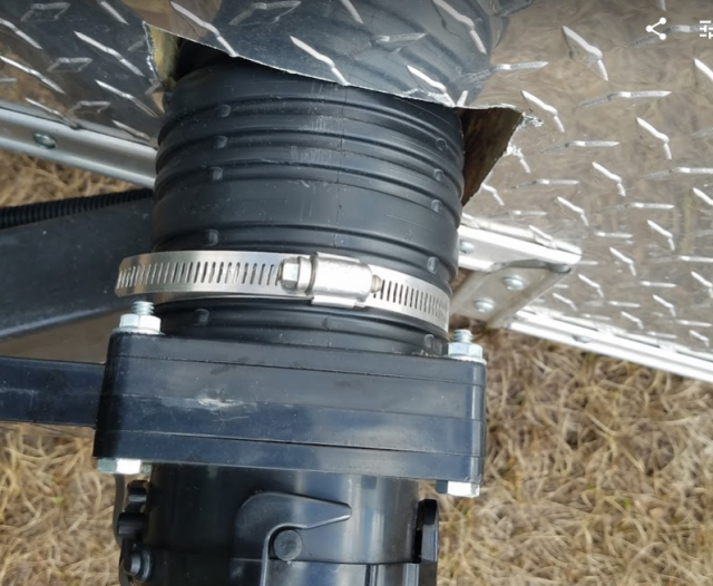

I had to replace the hose that connected my black tank to my black tank blade (It was leaking). Thankfully I went to an rv place that gave me the correct plumbing for free since it was less than a foot run.

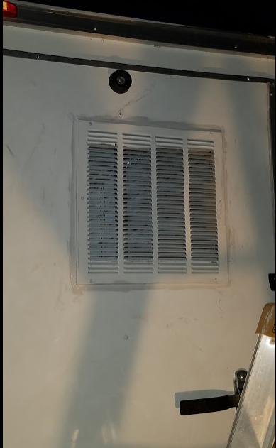

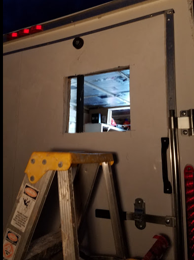

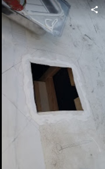

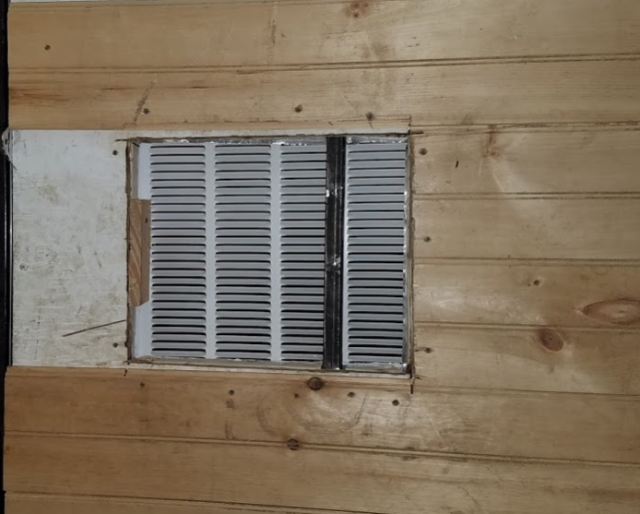

Since I'm in Florida, we needed to get the AC in (Been in the 85's lately) Hole for AC output vent
AC Output vent installed
Inside View of vent.

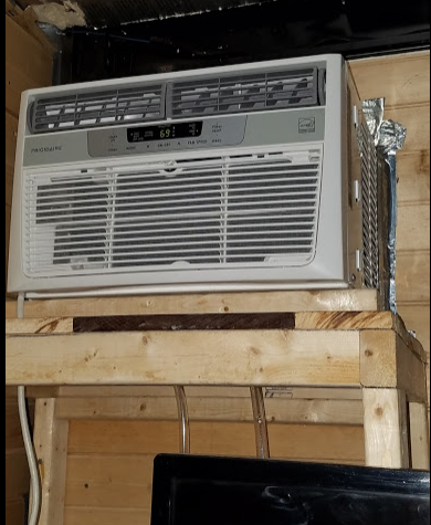

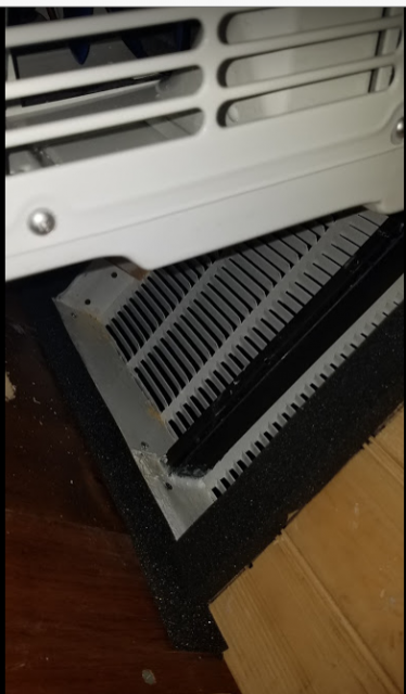

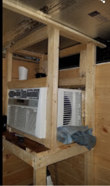

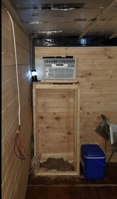

AC Base frame built and AC in place:

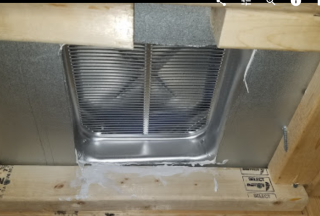

Hole on top for AC input air (My step dad debated on needing this vent. AC works fine without it. But I decided to put it in anyways)
AC Input vent installed:
AC input vent from the inside:
Top of AC built:

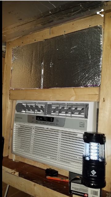

AC sealed in with insulation. I'll be cutting 1/8 inch underlayment to finish it off:

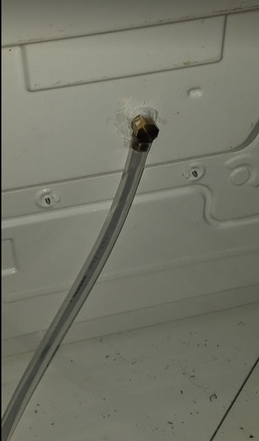

The ac clearly had a tray to collect water. So we cut a hole there and tied a tube to it for water output. We later changed it to a funnel which let the water drain better.

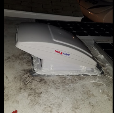

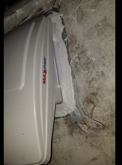

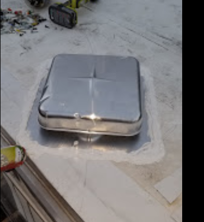

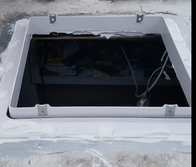

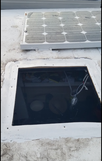

We also installed the Max Can Fan. Vent that came with the trailer off:
Max Can Fan base in place:
Fan Installed. We still have to add the bottom trim piece that goes inside the trailer. we'll do this once we finish the ceiling.

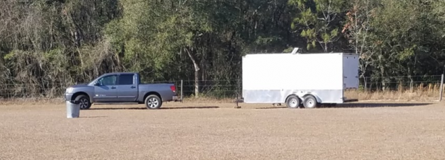

Some random pics of my boondocking:
My first ever fire in Ocala National Park. $8 per night with no hookups. My solar did me well.
Withlacooche River Park in Dade City. I stood here for 2 weeks completely off Grid. $10 per night. Nice park.

Assuming the top vent is to draw air in and is isolated from output vent with foam board or etc... I think your AC will work fine. Just make sure input and output air flow is isolated and that you are getting good airflow out through that back vent. Nice work!
Good to hear from you again. :-)

- Black tank was leaking. Had to completely take the toilet off and black tank out to fix.

The top vent is to draw in air in. We did a pretty good job of sealing the hot exhaust air. It comes out that vent at full force.

Nice job on that rear vent. I can see it better on my bigger PC screen at home and can see you left the steel stud in tact. I like the way you installed your AC. Kind of the same way I did mine except in the rear and you could still get a bike in from the ramp if you ever decide to do that. :thumbsup: :thumbsup:

Yup, my ac is pretty identical to yours. Your last rig/setup is pretty much my template when I'm looking for ideas. Since I was in a rush for the ac input vent, I just went with a cheap inlet from HD. You have a very nice and fancy Camco inlet.

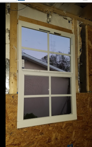

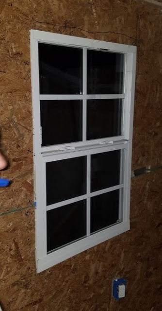

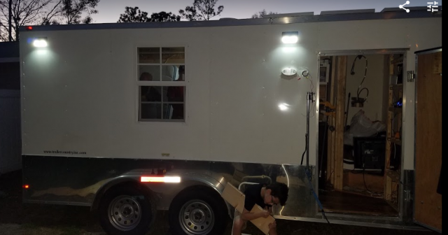

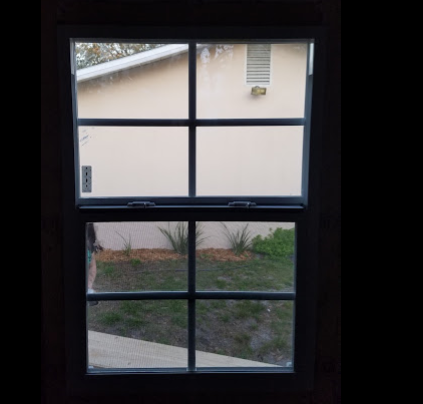

Well, we got our first window in today!!! It was pretty easy to install with all the help I had (Step-Dad, Nephews, NIeces....). Having a window really makes a world of difference! Starting to really feel like a tiny house.
Inside view before we sealed it all up:
Inside view with it sealed up:
Looking outside:
Outside view:
This week we'll put the pine sideing back in correctly and finally be done with the right side of the wall!!
As far as windows go, i'll add one more on the other side for a total of two. I was going to put one on the ramp, but I think two will be good for now.

The window looks really nice. It looks big enough as an emergency exit if the door was barricaded or etc.. Good to always have a second way out since the RV doors open out and it wouldn't take much.
I know that is for a house... so how did you seal that? The RV windows have a flange that pulls tight with Dicor tape to seal. I have never thought about a regular house window or how to seal it well ?
