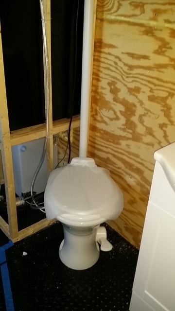

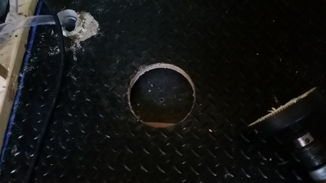

I got the toilet installed tonight. I wanted to get the hole cut in the floor and tank before I put up the walls. That will be a tight area to work when the walls are up. In any case, it installed easy and is very solid. It is at an angle so no knees are hitting the vanity. :thumbsup:
I did leave out a few pics like the 3" rubber grommet that mates with the tank and seals the 3" pipe into the tank. I got in a hurry and forgot to snap them. Oh well.

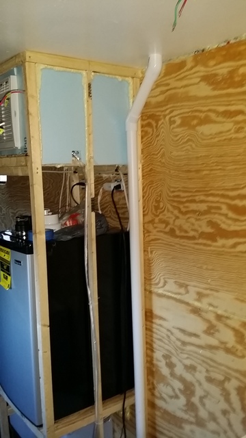

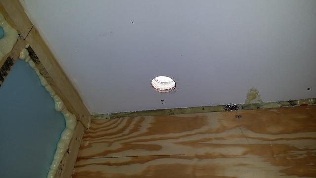

Gotta get done whatever I can in what little time I have after work each day. The nice thing about the build now is that there are a ton of "small jobs" that need to be done and I can save the bigger stuff for the weekends. I got the toilet/blackwater tank vent pipe installed tonight.
This should be the last hole I put in the roof! Really no way to get around this... you want that stuff way above your head. :-)
The Pipe cap on the roof. Lots of Dicor.... we want no leaking!
I had to put the hole where it is due to beams and etc. in the ceiling and the solar panel mount up top. I was able to get it back to the wall with 2 45deg. couplers.
Not sure if I will leave the pipe like this when I do the finish work, or whether I will encase it in the corner ... I haven't decided... We'll see. A decision for a later date. :thumbsup:

Man I wish I worked as quick as you. You get more done after work than I get done all day. Just curious, did you ever consider the siphon 360 or some kind of weather vain vent cap? If so, were they just too expensive for what they do?
Iconfabul8
Posts: 624
Images: 14
Joined: Sat Apr 30, 2016 6:15 am
Location: Southern Utah
Re: 7'*18' V-Nose Cargo Trailer Toy Hauler Conversion
Postby flboy » Thu Jul 07, 2016 8:12 pm
Iconfabul8 wrote:Man I wish I worked as quick as you. You get more done after work than I get done all day. Just curious, did you ever consider the siphon 360 or some kind of weather vain vent cap? If so, were they just too expensive for what they do?
Thanks.. I did look at some other caps but I decided to go with "simple". The other caps just seemed like overkill.. I think the main thing is not to have the exhaust fans (at least the Maxxair on high pulling 900 cfm) when flushing... it will pull a vacuum in the camper and draw air up when you flush.. Other than that, when the toilet is closed, the gas will rise and any air going over top the open vent will create a siphon. That's been my experience with campers so far anyhow.

Postby hankaye » Thu Jul 07, 2016 8:32 pm
flboy, Howdy;
looks like you've got it done like a pro. Question, ... did ya put a dab of sealant in the screw hole to
fill it up and keep it from corroding? Also same for the air "inlet" for the a/c?
hank
hankaye
Posts: 2567
Location: S.W. New Mexico
Postby flboy » Fri Jul 08, 2016 4:19 am
hankaye wrote:flboy, Howdy;
hank
No.. I didn't think of that. Is that bad?
Postby hankaye » Fri Jul 08, 2016 8:45 am
flboy, Howdy;
Those dollops of sealant keep water from pooling in the screw holes and
keeps the screws from rusting. That way, if you should ever need to get back
in there you just dig out the sealant and unscrew instead of facing a rusted
blob and frustration.
