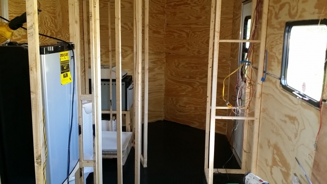

I got some framing done today. A lot more to do. I have a little time tomorrow and then I am out of town for a week, so progress will not happen. I'll just keep chipping away at it.
If you notice the wire bundle dangling about an inch and a half away from the wall... yes, they were suppose to be in the wall. They are for the bathroom lights and fan. I'll have to move them over. I did my best to measure where I thought the wall would be when putting in the ceiling and I missed. I hope I can fix the hole with some wood filler. I will get some backing up there and hopefully that will look okay when all painted. :cry:

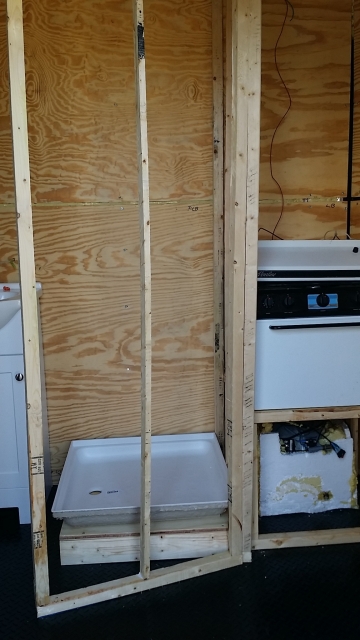

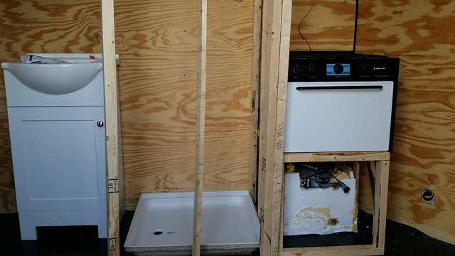

My shower pan is 24" * 24", but the way I am installing it, I will have another 11 inches of width in the front (35" wide) and taper down in the back to the 24" (my walls are at an angle). It is hard to explain, I'll take some picture when done. Also, I am using a shower curtain instead of a hard door.. that also is forgiving when you move around in the shower.
I am not wide, but about 6' tall... so it will work well for me. It is all a trade off on space.

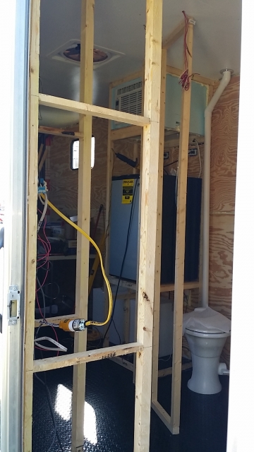

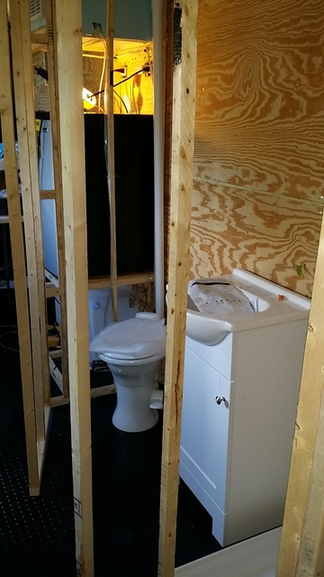

I got some more framing done today. The electrical closet is framed and I built the riser for the shower to set up on so the plumbing can run underneath. Still a lot more to do there.
I figured I'd get the closet in so I can start the electrical hookups. That job is something I can do for an hour there and an hour there in the evenings without a large setup... I like to save the larger project for the weekend.
