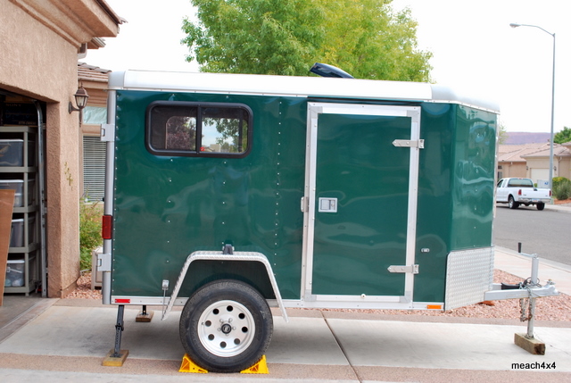

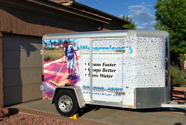

I did get a chance to take a picture of the exterior, now that the 4" lift and stabilizers are installed. First, here is a picture of what the trailer looked like when I picked it up:

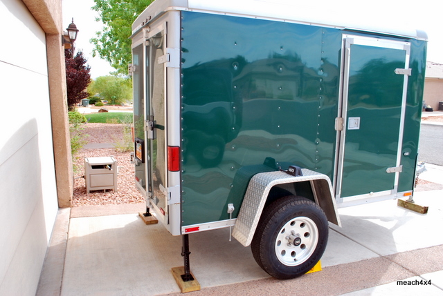

And here is what it looks like with the 4" lift and the stabilizers (and no vinyl wrap.)
I'll be installing larger tires and wheels soon, but first to the interior...

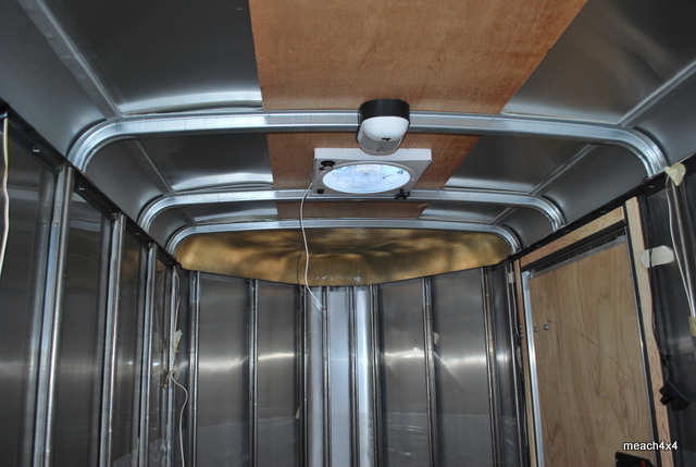

I put in the Fan-Tastic Vent/Fan this morning. It all went great. I started by drilling holes up through the ceiling to mark the four corners, then used the jig saw to cut the aluminum and luan liner out to a 14" square hole. I lined up the location so that the leading edge of the mounting flange lined up with one of the roof supports, so all the screws in the front caught the support. The side and back mounting screws went through the bracket, then the aluminum skin, then the 1/4" luan backing board. It all seems plenty sturdy, and will definatly gain more support after the insulation and finish mount are all sandwiched together after the insulation and roof liner are in place.
I put on a tube of silly-cone caulk to seal up the flange, mounting screws and roof. Then, I checked the inside finish plate to make sure it will work, and all is good.

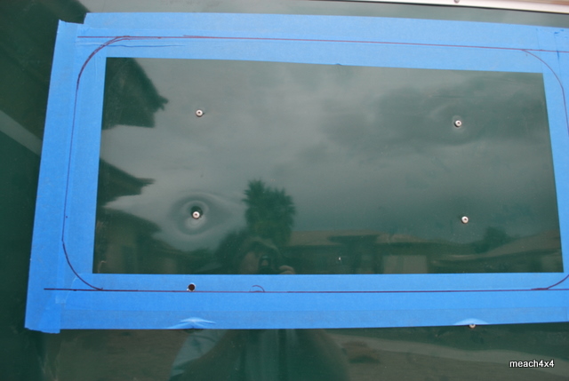

Progress was a little slower than I expected today. In my plan, I hoped to be able to use the window frame to stiffen the sides of the trailer where the vertical uprights are cut to accomodate the window. After thinking it over, I decided to follow the advice of the Wells Cargo factory, and to install some angle below the window frames to stiffen the side walls.
Yesterday, I installed the Fan-Tastic Vent Fan in the roof. I put it just ahead of the ceiling light, and positioned it to screw into the roof support beam on the leading edge.

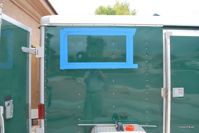

I followed Prem's advice on using wide tape on the exterior of the sidewall to mark the cut line for the window opening, and then cutting it with a jigsaw.
After marking the cut line on the tape, I drilled a locating hole next to the cut line and through the vertical support.
Using the hole to verify where the window support frame would be located, I marked the vertical supports where they would be cut out.

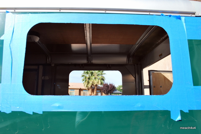

Then, after placing some wooden shims behind the supports to protect the side skin. I used a 4 1/2" grinder with a thin cutting wheel to cut off the vertical supports and removed them.
The next step will be to fit the 1/8" thick 1" angle above and below the frame, and weld it to the cut off vertical uprights. That will make the wall as stiff as it was before the side was cut out.

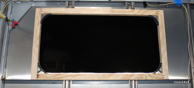

Postby meach4x4 » Thu Oct 22, 2009 10:53 pm

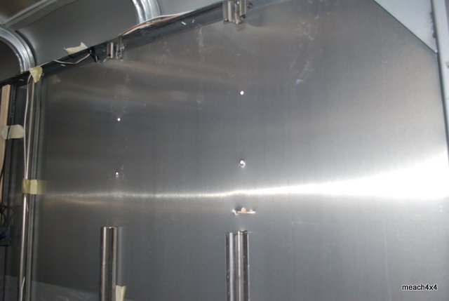

Well, I was too busy out playing with the Jeep on the rocks last night to post the results from yesterday, but I did get the angle braces welded. Here is a belated picture of the angle brackets (ignore the wood frame and hole cut, as they were put in today, and I'll get to that later in this post.)

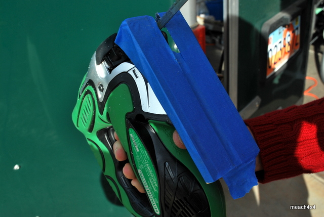

Today, now that the angle brace was welded to the vertical posts, the wall was nice and stiff. I drilled 3 holes in the top of the angle brace, and then cut out the exterior wall. I noticed that the base of the saw was quite sharp, and it was scraping off my masking tape, causing some marring of the exterior paint. I put a layer of tape on the base of the saw, and that eliminated the scratching problem.
Here are the results of sawing out the exterior panel with the tape on the jigsaw base and the exterior of the panel.

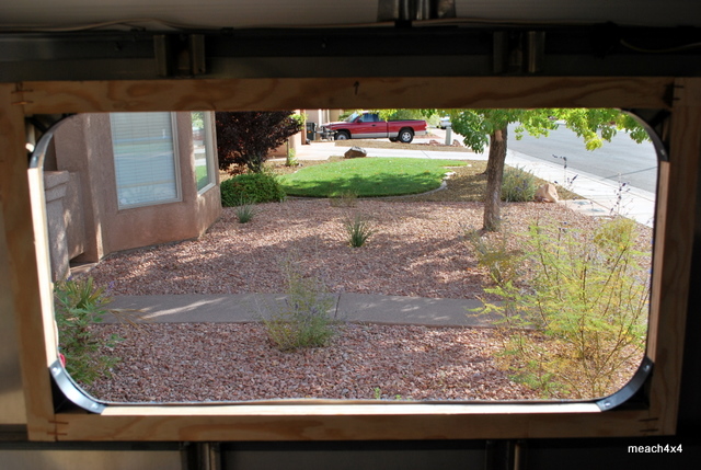

After cutting out the window hole, I attached the wood frame to the angle brace with wood screws through the 3 holes I drilled in the top of the angle brace, running the screws up into the wood frame.
Once the wood frame was in place, I temporarily mounted the window in place. I will be pulling it back out to re-install the luan on the insides after wiring and insulation are done. It was nice to see the window in the hole, even if it isn't the final install of it.
