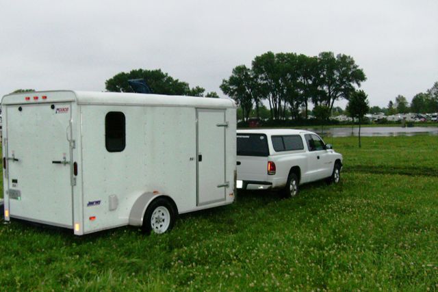

Postby LShrew » Sun Mar 13, 2011 10:44 pm
A 6'x12' is plenty for the misses and me plus the 2 small dogs. We have a queen size bed inside with a few shelves, 110v refrig and porta potty. We do not spend a lot of time inside anyway. Better than a tent and cheaper than a RV. We use the campsite shower and potty during the day and the porta potty for nights. I have an EZ-Up awning and cook all the meals outside.
The 6'x12'pulls real good with my 4.0L Nissan Frontier whether on a straight or up a mountain. I like the fact that I can see behind me with out having extended mirrors.
We went the normal route to get to this point with the CT. Over the last 30 years we went from tent-> tent camper-> 25' bunkhouse trailer-> 27' motorhome-> CT. I think that we enjoy the CT the most. :thumbsup:
