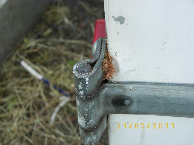

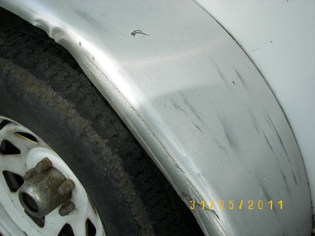

Here are a couple of pictures of the minor damage from the accident. As you can see, I fared fairly well. Unfortunately, the guy who hit me did not. He has lots of damage to repair. A testimate to just how rugged these cargo trailer really are. The wood wedged in the hinge on the first picture is part of the wall of his trailer. The scuffs and minor bending on the fender does not interfer with the tires at all. I did bend it back up some, but I am not going to worry about a few scuffs.

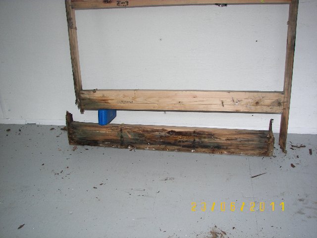

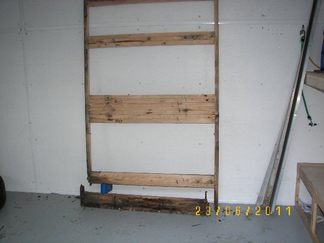

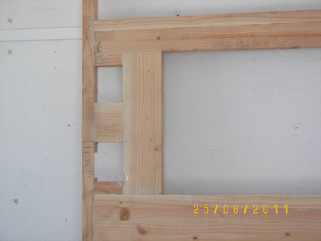

Bummer day today. I removed the man door on my CT to insulate and install the RV type door latch. Evrything went well until I started to remove the aluminum trim. Thats when I noticed the rot. I finished removing the aluminum and plywood skin and the pictures show the rest of the story. Looks like I get to rip and plane some special thickness pieces of wood to build a new frame. Fortunately, its not that big of a job and should not take that long. Anyway, here are the pictures.

Well, I spent most of the last two days building a new man door for the CT. I ended up duplicating the original structural design, but used polyurethane and wood glue between the laminates as well as bugle headed construction screws. I ended up using a sheet of 1/8 mahogany plywood left over from another project for the door skin. I was going to varnish the mahogany, but decided for consistancy, to paint it white like the walls. Tomorrow, I'll take pictures of the door with the skin on. The foam insulation is already cut and waiting to be installed. I will be reusing the original outer aluminum door skin. It's not perfect, but it is serviceable. I did notice, that with the laminates glued together, the frame is much less flexible that the original. Anyway, here are the pictures.

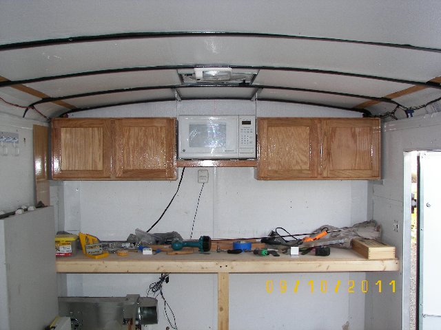

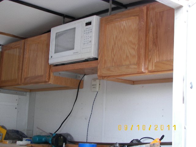

I have been working on installing the cabinets and microwave. I finally decided on how I would install them. They turned out pretty good if I must say so myself. I finished them in gloss Polyurethane in a natural wood color. The mounting was a bit of a challenge since the steel supports in the front wall run horizontally instead of vertically. I ended up making a couple of hangers that are attached to the ceiling bows. That was the only way I could ensure the cabinets would not sag in the middle. Heres a couple of pics.

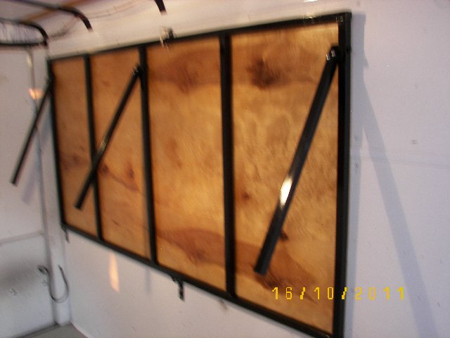

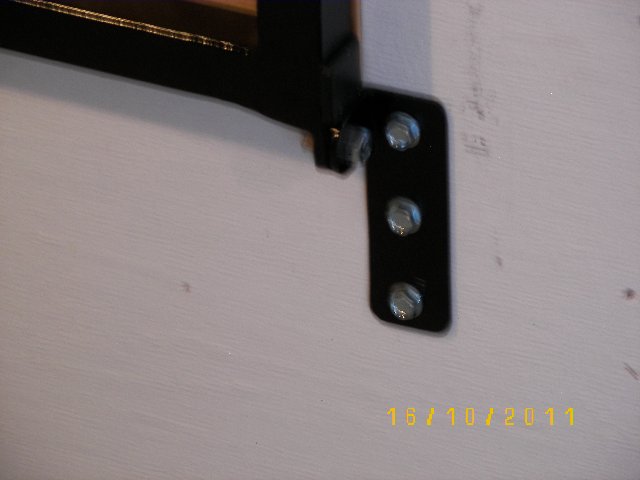

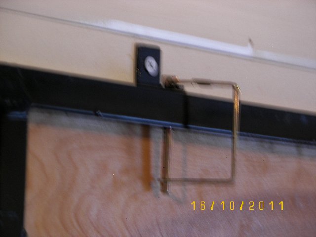

Today, I completed the sleeping platforms. I ended up making them higher than originally planned. They are made out of 1" steel tubing with 1/16 wall. Each platform has three hinges that are screwed into the steel wall studs with #14 self tapping screws. The top of the platforms are at 25". This height gives me lots of storage space under the platforms and it also allows the grandkids to sleep under the platforms when we are camping. The legs fold out when the platforms are lowered and back in when they are stowed. The platforms are held up for transport by a simple clevis pin and angle bracket. There is 2.5" between the platforms to avoid a hand pinch point. The deck is 1/4 birch ply. I will be replacing it with 3/8 in the near future. The 1/4 plywood feels like it wants to break when I was testing it. I will have to shim out the hinges and latch when I do replace the deck. Sorry for the picture quality. I just could not get the camera to cooperate.

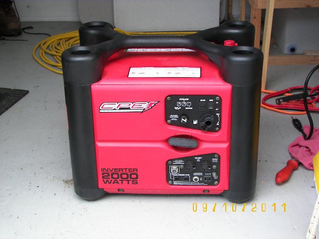

Heres the new generator I picked up. It is a CPE inverter tech generator. This thing is amazingly quiet when in econ mode. It is rated at 1600 watts continuous and 2000 watts surge. More than enough power for my limited needs. About the only thing that uses AC is the microwave and power converter. I got an awsome deal on the gen. It was a store return that would not run properly. I got it for less than 1/2 price at a store whose business is selling store returned items. The pilot jet on mine was completely plugged. Once I got that cleaned out, it runs great. It only weighs about 50lbs. Nice and portable, and quiet too!
