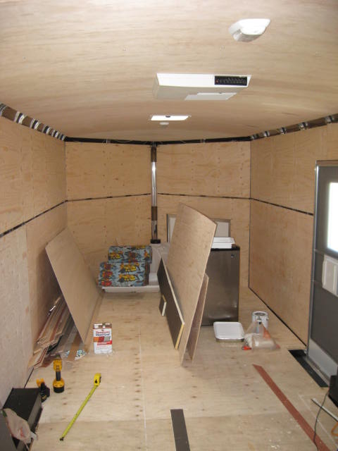

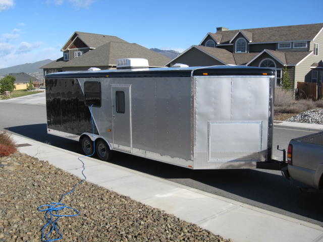

Well, we picked up our trailer Friday, and towed it home with us. Nothing like jumping off the deep end. I've never towed anything bigger than a 10 foot flatbed with a lawnmower on it, so I was a little nervous about dragging this thing home over 2 mountain passes. No problems, other than watching the gas gauge drop like a rock! I did notice that every incompetent driver in the state of Washington was on the road, and doing their level worst to make my life exciting. I'm sure you folks are familiar with the feeling "Oh, please (insert God of your choice, rock, sun, spirits, etc.), just let the idiot brigade stay away from me and my new toy until I get it home". One of the downsides of "diversity" is the fact that I need to learn new and different hand gestures, and obscenities in many new languages. I hate yelling my best out the window, while giving the all-American finger salute, only to be greeted by a confused look. Very demoralizing and unsatisfying. On with the show.
outside
starting to add 1" iso insulation
interior
I ordered this trailer with a finished ceiling, but no trim. This was to avoid wrecking the ceiling luan when removing it to insulate. The factory had to use staples anyway, to support the luan ceiling, but they did leave the trim off as requested. If the interior looks rough, it's not the factory's fault. When fully trimmed out, they make a nice product. They were nice enough to include all of the trim in a pile of pre-cut lengths for me. If you are thinking of ordering this way, I recommend doing the ceiling yourself, as I already managed to break one of the panels trying to get it down....I will post more pics when I have something to show for my efforts. The insulation is going up just like everybody elses, so nothing too exciting there. I am filling the ribs of the framing with spray foam, and sealing all seams with HVAC tape. More to follow, as soon as I start running wires and plumbing. Regards, Kyle

CaptD, I understand the desire for a narrower trailer. This thing is wide, and leaves little room for lane-centering error. I've always tended to drive a little to the right on the highway. I just like the .5 second cushoin it might give me if somebody crosses the center line. Not with this behind me. It's gotta be centered pretty well. The baggage door will be for storage, and it also houses the 35 gallon water tank. I may put the batteries inside, but most likely I will weld up a bracket on the tiny bit of tongue I have left, and put them there. I know the water tank sounds like a ton of weight, but I can't imagine filling it before a road trip anyway. Not too many places I couldn't stop somewhere and fill it up 20 miles from where I will camp. If it doesn't work out, I will have to install a tank underneath. As for propane, there won't be any. At least not for now. I may wind up adding a propane furnace at some later date, but for now, a 1500w King wall heater, with remote t-stat will do the trick. It's been about 35 degrees here in the mornings, and with the insulation only 10% done, it heats up the trailer in about 1/2 hour to 70. All other appliances are 120 as well.
Lonerider, Yeah, it's big, but we are a family of four, and I wanted "Toy hauler" capacity as well, just without the toy hauler price, and lousy build quality. I don't need a goofy outdoor shower, or 100 gallon "Fueling station" (Does anyone see a problem filling a red hot bike or 4-wheeler with fuel, just 5 feet from your rv, and 100 gallons of gas in it's tank??) I have a mental picture of me using an outside shower, and the tarp falling down. Somehow I know there would be a flock of college girls standing there, and amid the chuckles one of them would mutter over her shoulder "Looks like the water is cold, lil' fella!" Progress has gotten off to a slow start, but will be picking up soon. Framing and electrical begin this weekend. Thanks for looking! Kyle

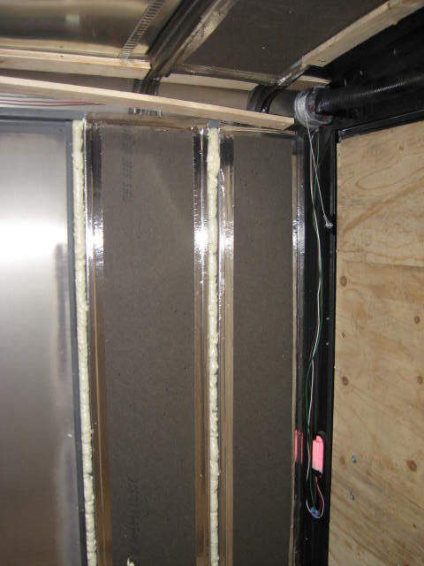

Well, one week of part time work in, and the trailer is almost back to looking like the day we brought it home...Not a lot of visual progress to show, just been installing the 1" iso insulation, and adding vapor barrier over it, before putting the 3/8" plywood back up. I "saved" a few bucks by getting fiberglass faced iso board. Hindsight being 20/20 as always, I'd never do that again. The $5 extra for foil faced is a no-brainer now. This stuff is itchier than batting, and needs a vapor barrier. It will work just as well, but takes much more work, and is much less pleasant! Hopefully I will have some walls up this week, and some picture-worthy progress to share. Installing wiring, plumbing, and building walls is like building a ship in a bottle....Unless you use 6"cedar fence boards for the ceiling furring strips. This will allow me to frame 3" walls, and still have enough room on the furring strips to staple up the luan ceiling. Duhhh! It seems obvious now, but I was puzzling over the sequence. Wiring, plumbing, ceiling, framing. Hmmm, hope I don't forget anything. With the wider strips, I can remove ceiling panels later, in the bedroom, bath, and kitchen, without a complete luan-shredding nightmare. Regards, Kyle
