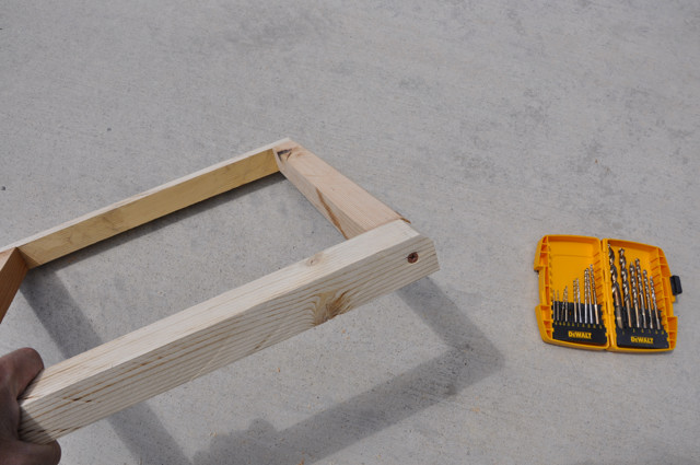

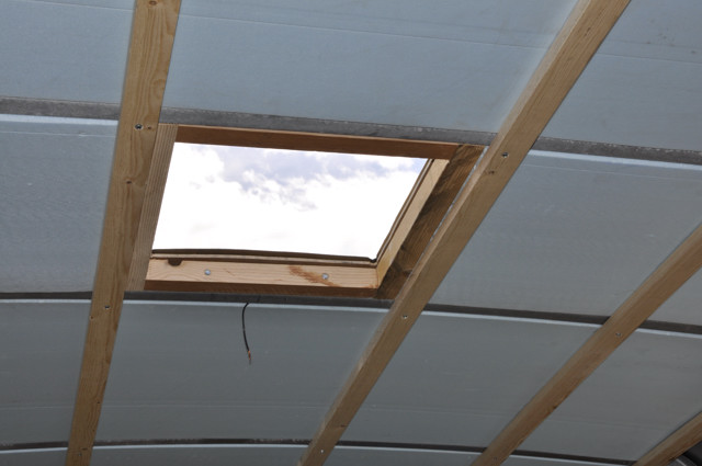

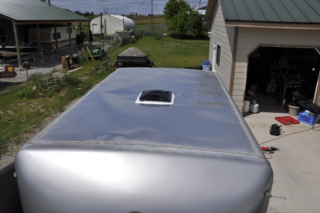

Anyway, I finally had a little time to get the vent in. Had to be one of the hardest jobs I've ever done, not because it was technically challenging but because I had to cut a hole in the roof! :worship:
So as promised here's the whole thing...

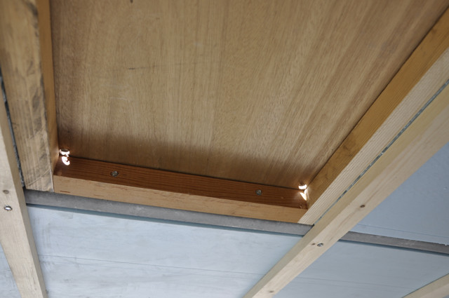

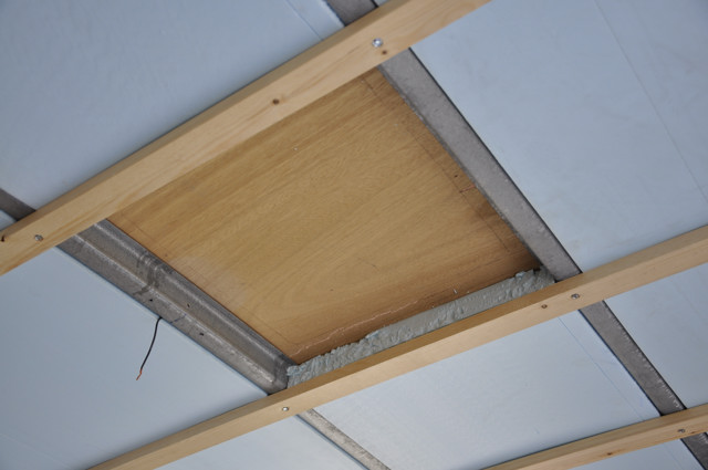

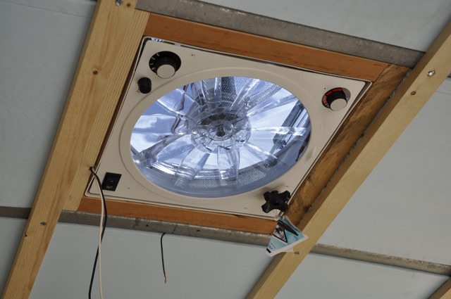

Cut out the foam board and prepared for the frame:
I built a frame with a 45 degree bevel to help it fit up against the roof rib flange:
Frame installed and those holes drilled that created so much anxiety:
Hole cut out with sawzsall and ready for fan/vent:
Installed!
From inside:
Job's done - now on to the windows and ceiling! :thumbsup:

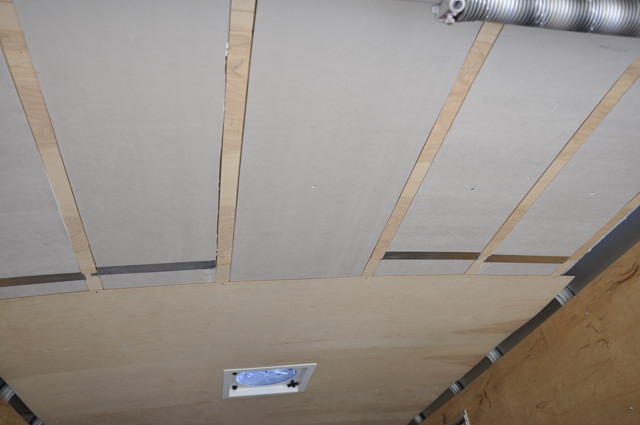

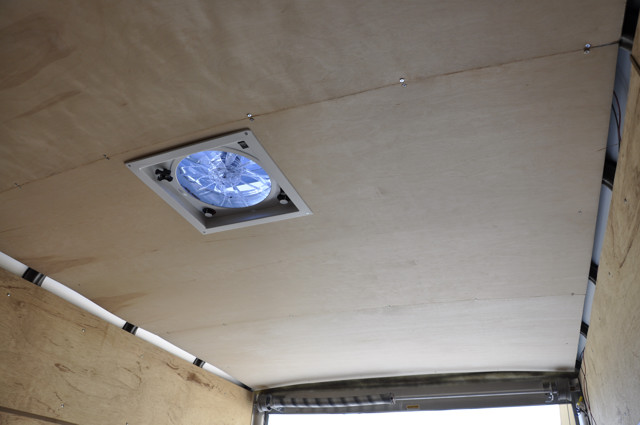

OK, ceiling installed. Here's the photos...
Just before the last ceiling panel was installed:
Finished except for the trim. That will come after all the walls and cabinets are installed.
Now on to the next thing. I'm waiting for the trim rings to arrive but I have bought the square tubing and hope to have that welded in place sometime this week. Then the windows go in and more building from there. :thumbsup:

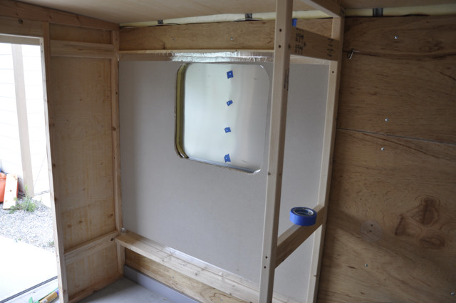

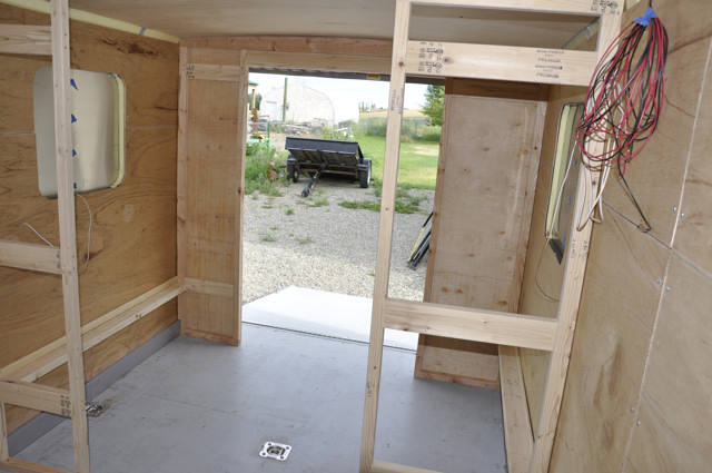

Postby pilgrim » Wed Jul 27, 2011 8:23 pm
Have had some good progress since my last post and we even got to take a camping trip this week! So all is good even though there's a lot left to do. At least the bed area worked - actually even better than I thought it would.
So here's the photos from the build progress. I'll post some interior later and a few from the trip if anyone would like me to.

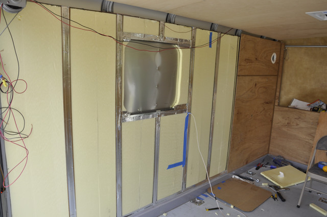

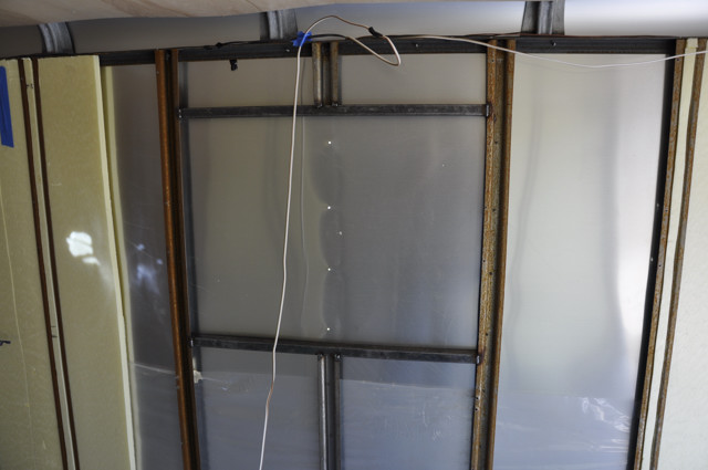

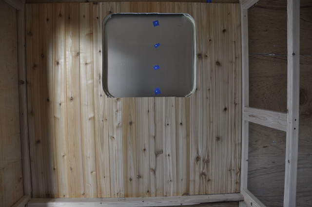

Here's the frame work for the windows installed:
Insulation back in and the tape over the wall studs:
Paneling back up and the framework started:
Additional 1/2" insulation for good measure:
Final cedar paneling up ready for window install:

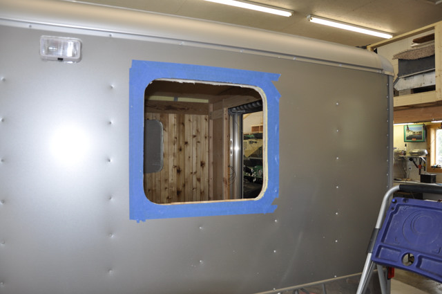

Siding cut out:

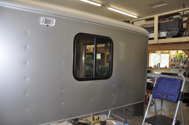

And Window installed:
The whole process went well and I did both sides. They look great and worked like a charm on the trip. The build is progressing well and if I have time this week I'll get the booth/bed area finished as much as is possible and the get started on the closed and pantry/utensil area.
