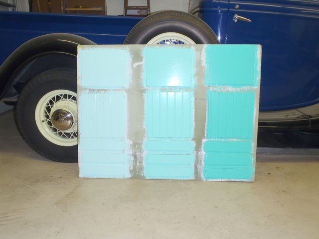

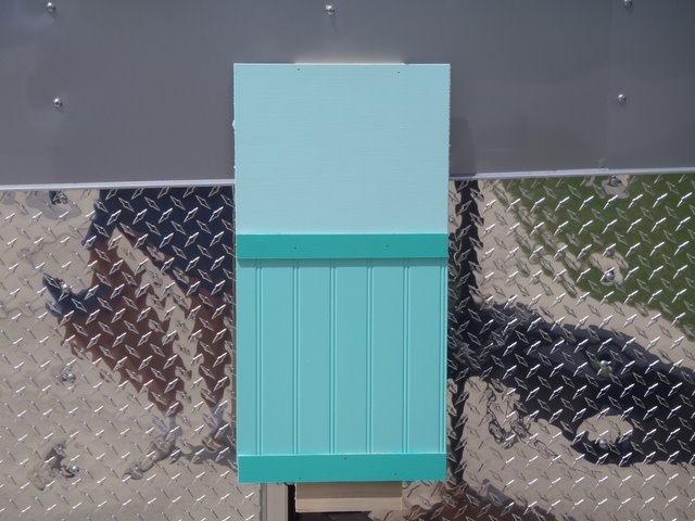

here are the samples of the 3 colors I plan to chose from. I did multiple samples so I can mix and match to see the various combinations.
I will be using the middle color for the bead board. The color on the left for the smooth paneling above the bead board. The color on the right will most likely be used for the chair rail, front window and door molding and base board molding.
The ceiling will most likely be white with white cove molding, but there is an even lighter shade of this color group that might work on the ceiling too.

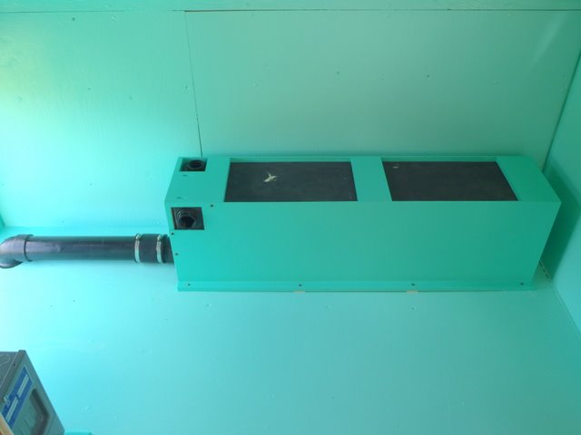

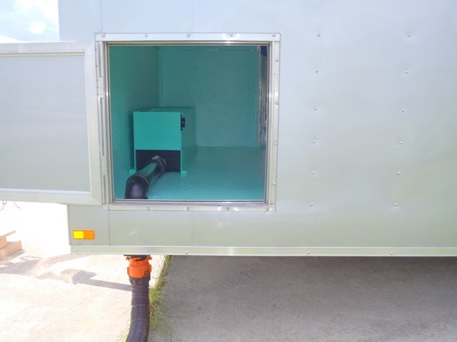

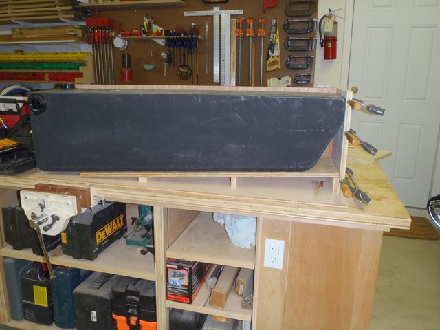

Holding tank and sewer line installed
Postby pmspirito » Sat Sep 17, 2011 9:00 pm
The 20 gallon gray water tank is now installed. I used a "Fernco" rubber coupling at the tank to pipe connection. I am able to remove the entire tank without having to cut anything. The tank sits behind the refrigerator. With the fridge removed I can remove the tank.

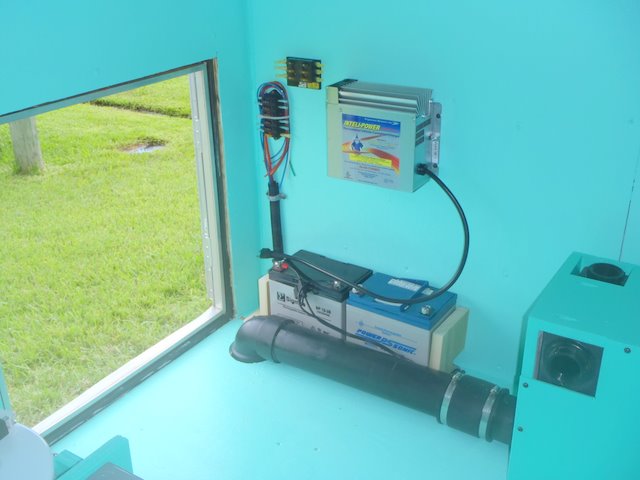

Batteries, power supply
Postby pmspirito » Sat Sep 17, 2011 9:12 pm
The batteries are two 35ah wheelchair batteries. The power converter and battery charger is a Progressive Dynamics Series 9200 60amp.
The batteries will be wired individually to the charger and will have plug in connectors. I have an electric trolling motor and will unplug and remove one of the batteries at a time and use it in the boat.

final color selection
Postby pmspirito » Sat Sep 17, 2011 9:17 pm
Here is the final color sample. I will be using Benjamin Moore Regal brand paint. The paneling will be removed from the trailer and spray painted using a HVLP gravity feed gun.

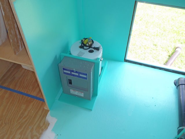

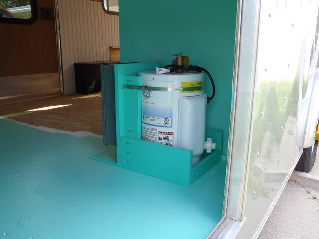

hot water heater and electrical panel in place
Postby pmspirito » Sat Sep 17, 2011 9:22 pm
The 2 1/2 gallon hot water heater sits on a little "skid" that also supports the electrical panel. The electrical panel circuit breakers are accessible from inside of the trailer directly behind a cabinet door. The hot water heater is easily accessible from the 24 x 24 cargo door.

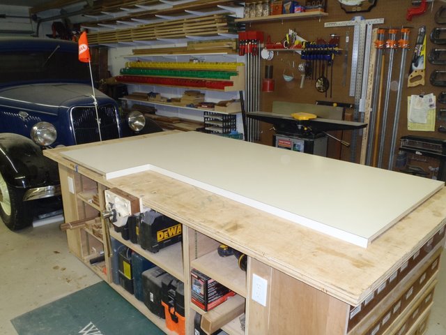

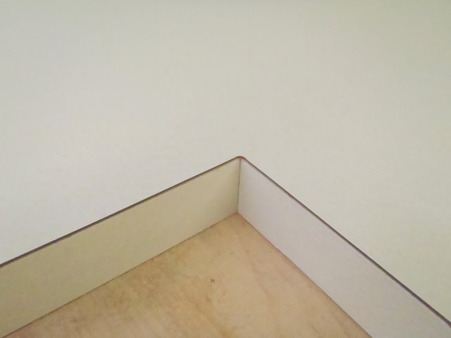

Countertop is finished
Postby pmspirito » Sat Sep 17, 2011 9:55 pm
The Formica counter has been finished. I do not use the regular brush/roller applied contact cement that is commonly used. I used 3M Hi-Strength 90 Spray Adhesive. Not cheap. About $14.00 per can. I used almost two cans on this counter top. I applied two coats to the plywood and two coats on the Formica. This spray adhesive goes on thin and evenly. It also becomes tacky within two to three minutes. And it sticks like crazy.
see my cargo trailer build at viewtopic.php?t=45197
Peter Spirito
www.peterspirito.com
pmspirito
Posts: 123
Images: 112
Joined: Sat Jul 17, 2010 9:44 pm
Location: Port St Lucie Florida

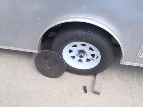

moving the trailer into the garage

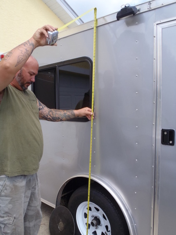

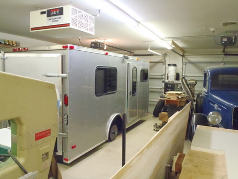

Postby pmspirito » Mon Sep 19, 2011 7:20 pm

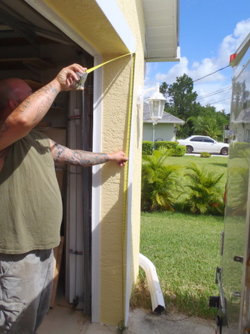

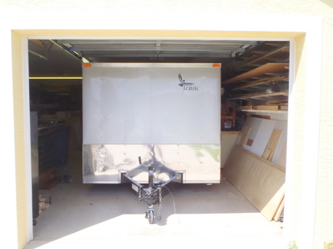

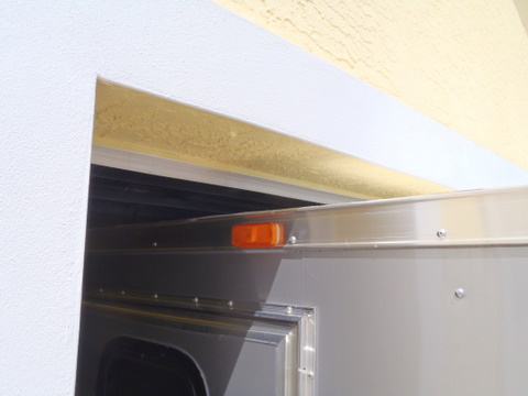

A key element in this project has been the ability to store the trailer in the garage. With all of our collaboration and finagling I knew the trailer would still be about 3-inches TOO TALL to fit into the garage.
My solution was to make two steel wheel disks to replace the tires and wheels. The disks, being smaller in diameter than the tires and wheels would lower the the trailer and allow the trailer to fit into the garage.
I jacked up the trailer with a floor jack and removed the wheels and installed the disks.
The trailer rolled into the garage effortlessly. But it is a close fit.
That is my son in the photos.
