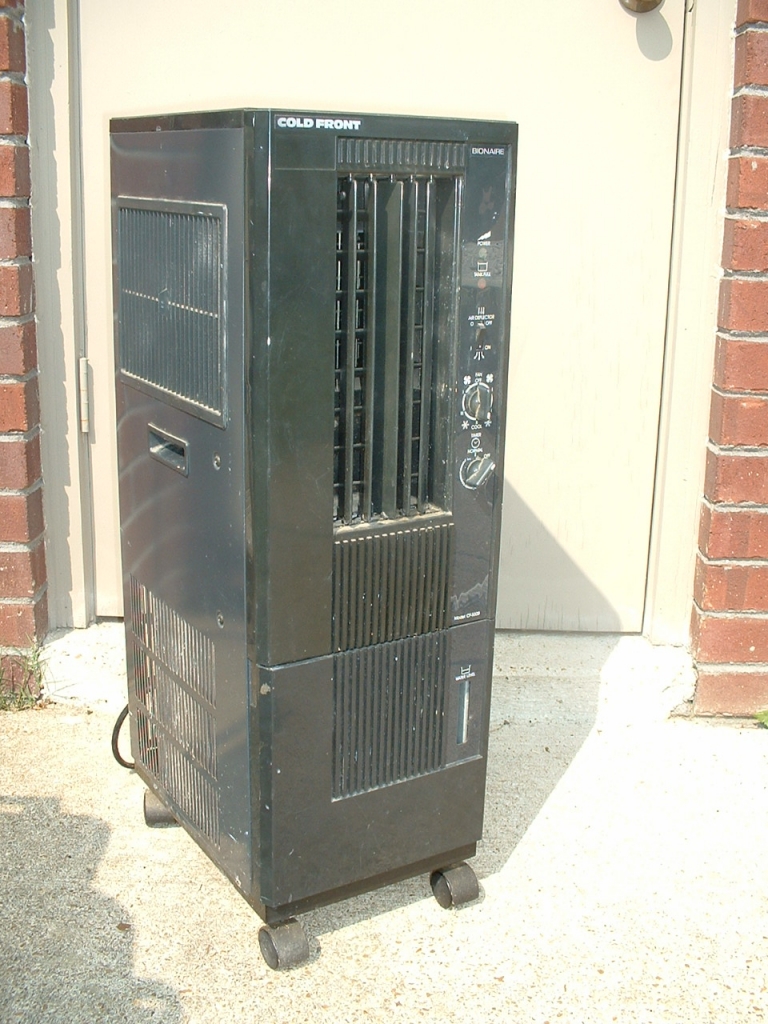

As the thread title says..... A Never Ending Debate. Everybody has to decide for themselves which method works best.
If I want to camp in the summer time in Mississippi, I need to keep "she who camps with me" comfortable. Trying to figure out what method I was going to use without cutting holes in the '47 was paramount. It may be redneck; but I was recently given this unit for FREE. I'm thinking I will just set this up on milk crates or something similar against the fully open window on the non-door side and let it crank. Probably maake some kind of waterproof shround to cover the open window and the top half of the unit. It has 2 automatic shut offs. One is a 6 hour timer and the other is a catch jug for condensation that switches the unit off when it becomes full. If it works, it will be a PITA transporting and setting up; but the benefits will be worth it.

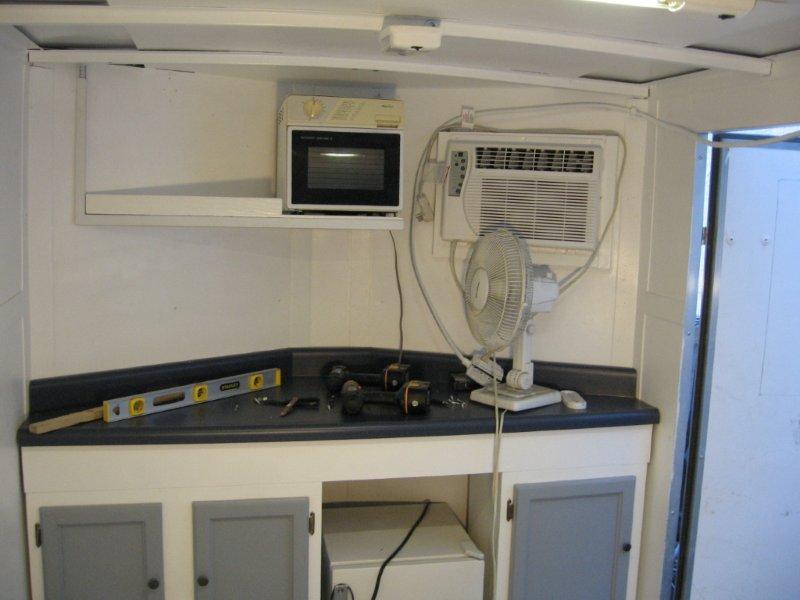

Postby thejonescompany1 » Sun Jun 03, 2012 9:19 pm
I love my 5000 btu window AC. Installed in the right side of the V-nose it keeps my 12X6 very cool (68F) even on a hot day (100F) in the summer. It takes almost no space, is nice and high for good cooling, and runs great on my small generator. I’m really happy my AC has digital temp control!!!!! It ensures the unit cools enough but not too cold. I set it and forget it is even on.
Disclaimer: my roof is insulated with 1 in pink foam, it made a big difference.
roof not insulated in this pic.
Check out my build.
http://www.tnttt.com/viewtopic.php?f=42&t=50577
