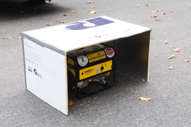

Going camping and riding off the grid this weekend so I got a little larger generator so I can run everything without overloading the generator. Didn't have $2K for one of the 3000W quiet inverter Honda's which would be the best... so I bought a cheap Generator ($279.00 at Harbor Freight) that will last a while. Just using it a few times a year... wasn't worth the expensive generator for me. The issue with these cheap generators are they are louder than the 70dB advertised. I don't want to be obnoxious to others, so I built a sound box for the generator. To make it light and manageable to lift, I ripped some 2x4 into 1/4 width and built a light frame. I covered the frame with some plastic panel I had, used R30 Insulation I had along with some acoustic ceiling tiles and some dense cardboard to hold it all together. I left a 3" gap at the bottom side where the air and exhaust come off and put a 6" vent directly in front of where the engine draws air from the flywheel fan. I will use some 7/8 flex copper tubing to extend the exhaust outside the box by the 3" gap.
If I see the generator getting too hot... I may get a 7" electric radiator fan and force some air, I saw some cheap fans on eBay for $29.00 and the Generator has a 12VDC 8A outlet to run it directly from. We'll see if it is needed. I think the generator will draw enough air and with the exhaust outside the box... should be no issue.
I have a UPS to use inside the trailer for the LCD TV and other sensitive electronics... or I could run the TV directly from the 12VDC 2000W inverter I have already installed. Either way.. covered for the dirty power if the generator runs out of gas or etc..
The added benefit is that this sound box is weather proof... so I can run in the rain. :-)
I tried it out tonight.... the generator stayed cool and cut the noise by 10dB at least. I can barely hear it from 20 ft away. Just a low purr now. Also runs the Air Conditioner, Fridge, Lights, etc.. all together without hesitation. Now I will be able to use the microwave and AC at the same time. :-)
I am going to field test it this weekend. Going out for three days. I'll let you know how it goes.

I copied your idea re: the sound damping box around my Champion 1400 today. It made a difference but the real test will be in the woods at the camp site. I am spraying it now to be a little less visible from the road.
I will aim the opening away from the camp. This should give me the cooling I need and this is November and the temps should already be low.
I will give a report on it during Thanksgiving week when I return.

I ran the generator today camping. It got too hot. I will have to get a fan to force air. The box built too much heat. Going to try a 7 inch electric radiator fan. They have them for 29 bucks on EBay and the the generator has a 8 amp 12vdc plug. The sound was great... Just need to keep it cooler.

I wondered about the heat also. But I thought I could get away with it here in the National Forest in VA starting in a week given that the nights will be in the 40's down to 30's this year. It will only be run at night when the day hunt is over. But I will take your implied warning and watch my unit very carefully.
I will add some holes in the side for more air flow now and be prepared to move it back if things get to hot. I could just move it behind a close tree and just let it run as there will no other trailers close enough to be bothered by it. For now, this is just a low cost solution for this fall until my budget allows the Honda unit.
