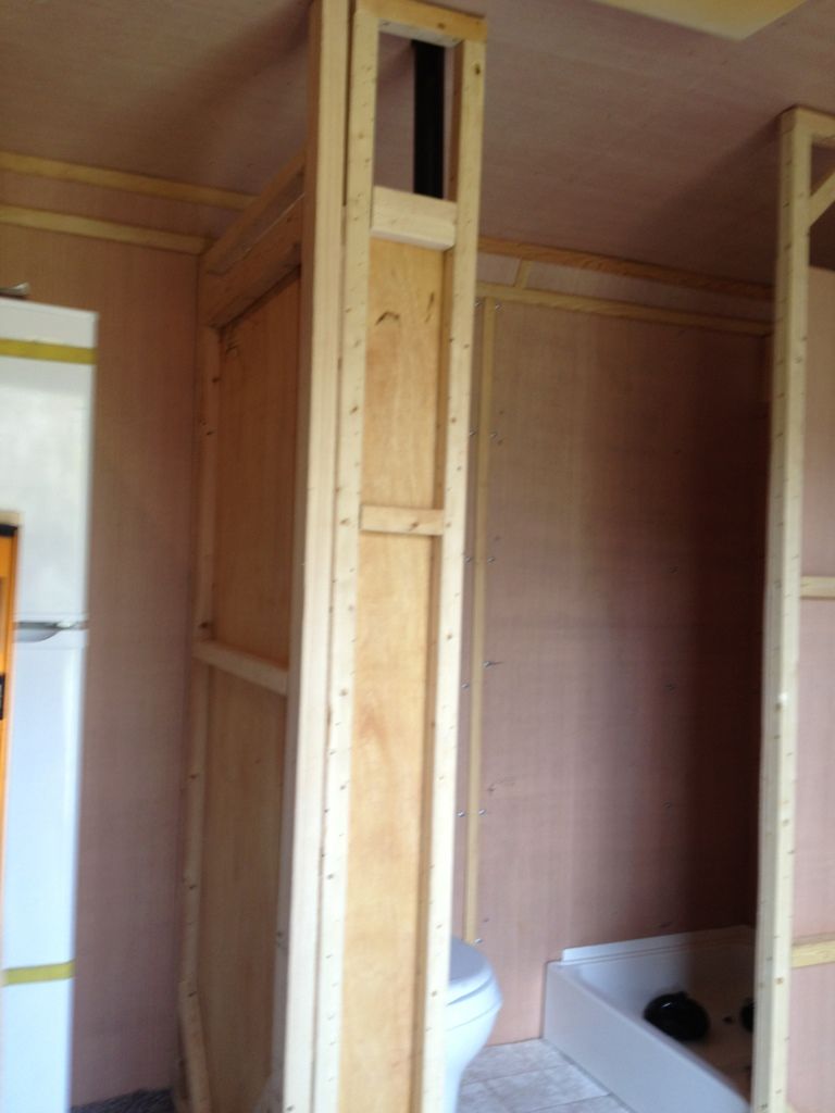

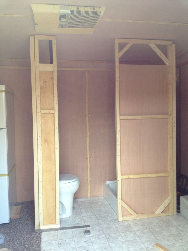

Worked on the bathroom this weekend some.. Framing it up. I've got FRP to glue to the shower walls, then going to stain the plywood on the other walls.. Lots more to do, but definitely making progress.
I like the 2x2 lumber. But one thing to watch for is twisting and bowing. It makes the wall building a little more challenging, but with working it correctly, and good bracing, it appears to be workable.
the back wall is a bit bowed at the top on one corner. But once I get the other plywood into place, I believe I can pull the top corner forward with a couple of screws into the side bathroom wall.

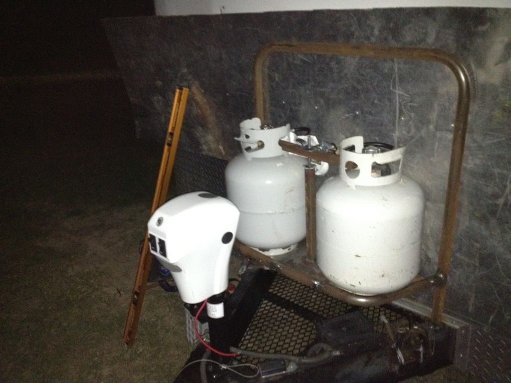

Postby DTCOOPER » Mon Nov 19, 2012 11:15 am

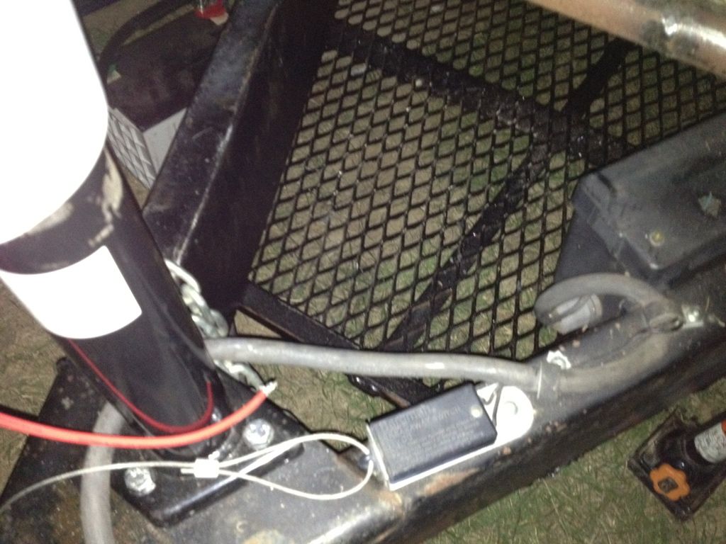

Also mounted the electric tongue jack.. (ebay is my friend LOL)

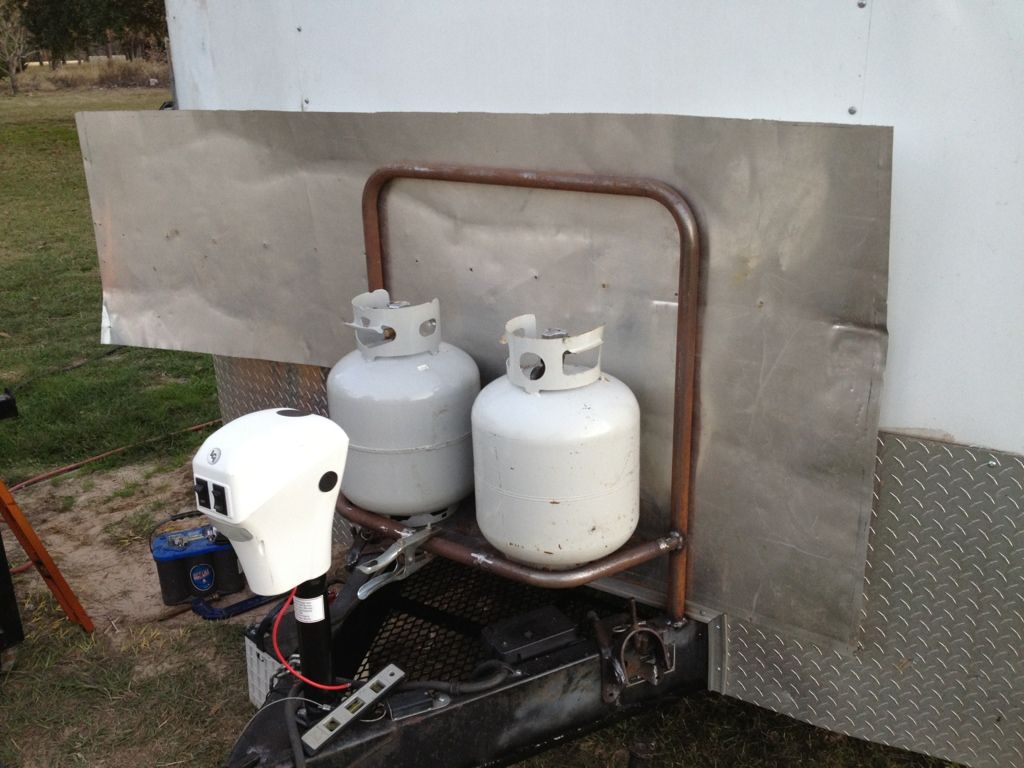

Started bending some tubing, to make a propane tank rack, and a place for fuel jugs.

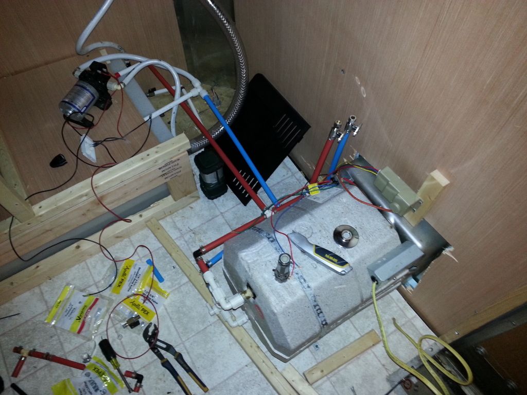

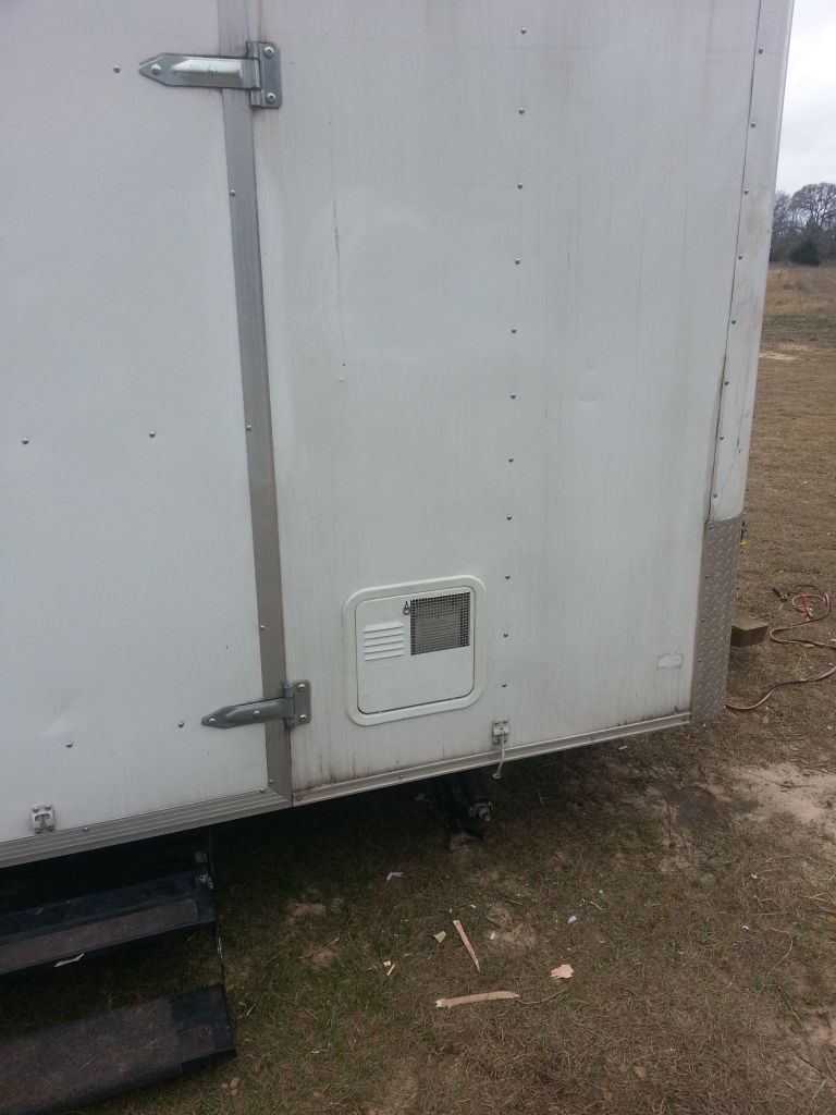

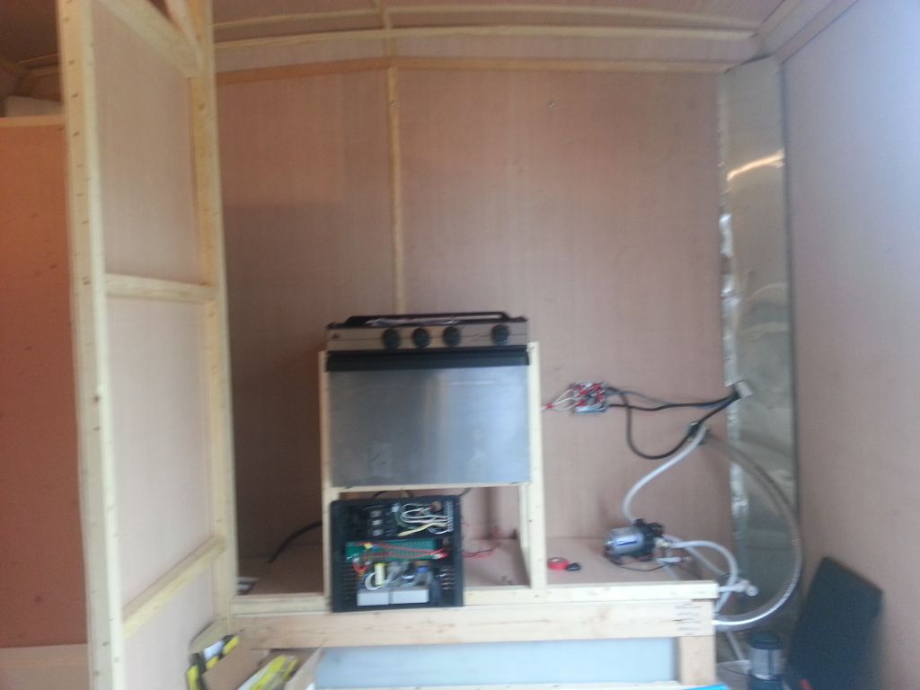

I got the cabinet framed up where the oven is going, and you can see the panel mounted below it.
Got the water heater installed, and hole cut in wall for installation. No matter how many times I do it, cutting holes is still a blood pressure increasing event..

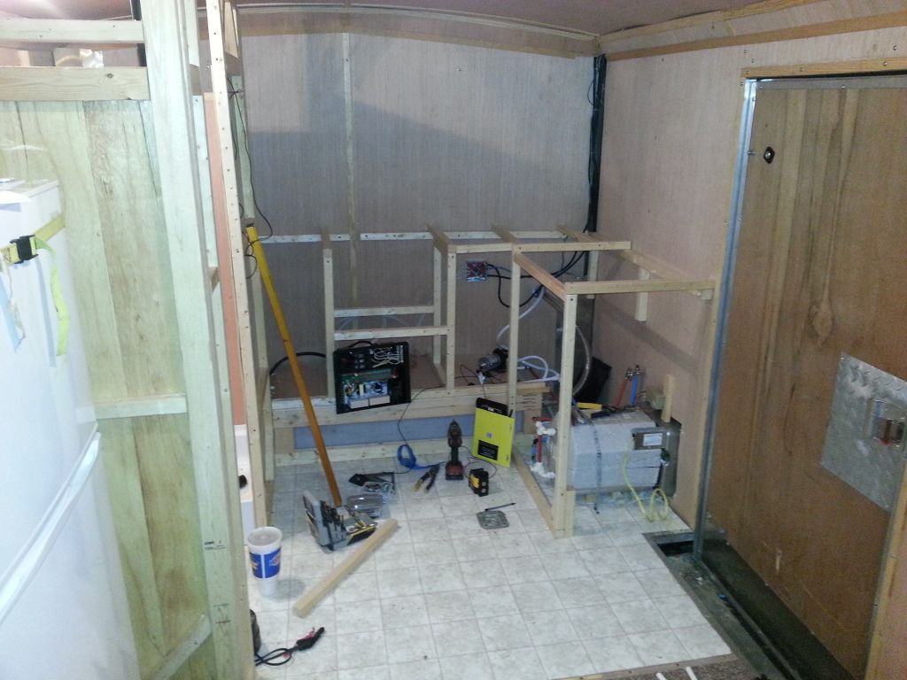

A little more progress over the last week.... :beer:
got some framing done for the front cabinets and counter

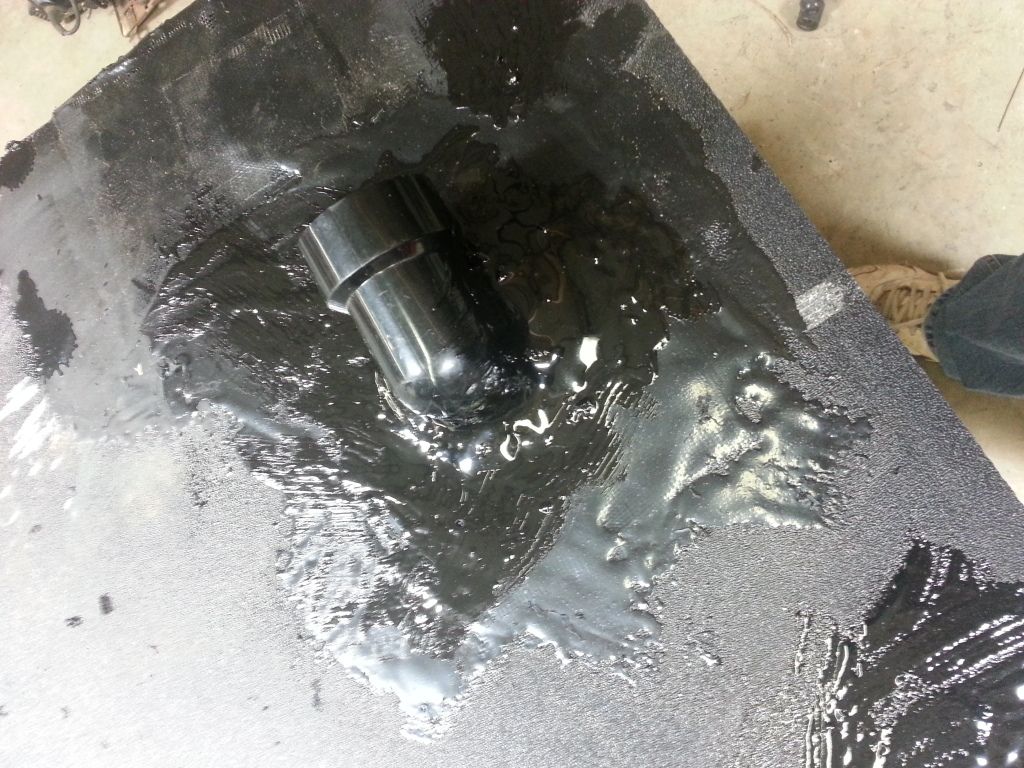

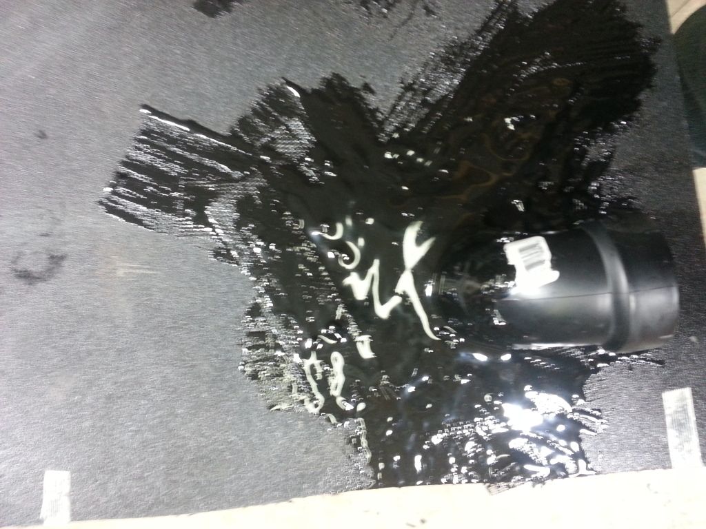

Also had to do some more mods on the grey water tank, to add my inlet fittings and vent line.. When I did the black water tank, I had purchased plasti-mend (neat stuff) for "welding" ABS items..
Well I had used the quart of that stuff (70 dollars) :shock:
So I was searching for a less expensive alternative. Then I found a few different "recipes" for ACETONE and ABS Shavings, legos, bits and pieces of ABS plastic.. So I figured what the heck, I'll try it..
Here's the results

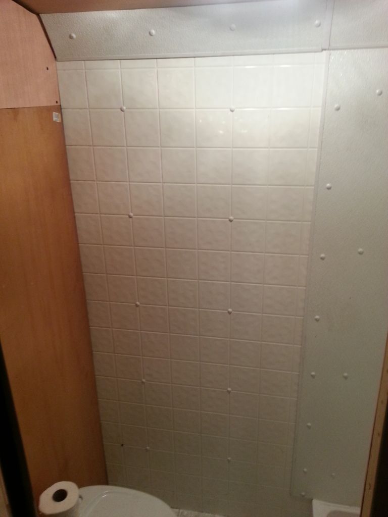

Got some more work done on the shower-bathroom
Still have to install the tileboard on the other small walls, and get the FRP on the ceiling.. A combination of adhesive and the drive rivets seemed to work well..
