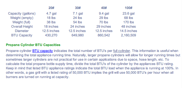

Postby OverTheTopCargoTrailer » Thu Mar 21, 2013 5:41 pm
Hank - Now I finally got it 8) 8)
a BTU guide.png (42.91 KiB) Viewed 2677 times
I see what your saying, since my Heater uses 180,000 Btu & a 5 gal bottle only holds total of 430,000 Btu ....
therefore I need a trailer full of gas to haul around for my heater
Good point...... I see your conclusion..... :lol: :lol: :lol:
as you can see (2) - 5 gallon Bottles are 860,000 Btu &
my heater at 180,000 per hour usage would produce 7.5 gallons per minute times 4.77 hours
that would give me about 2,431 gallons of hot water.....
but I estimate actual only 1800 gallons
So I really need a trailer to haul all the cold water around :D :D
BUT you made a really good point, thanks :beer: :beer:
