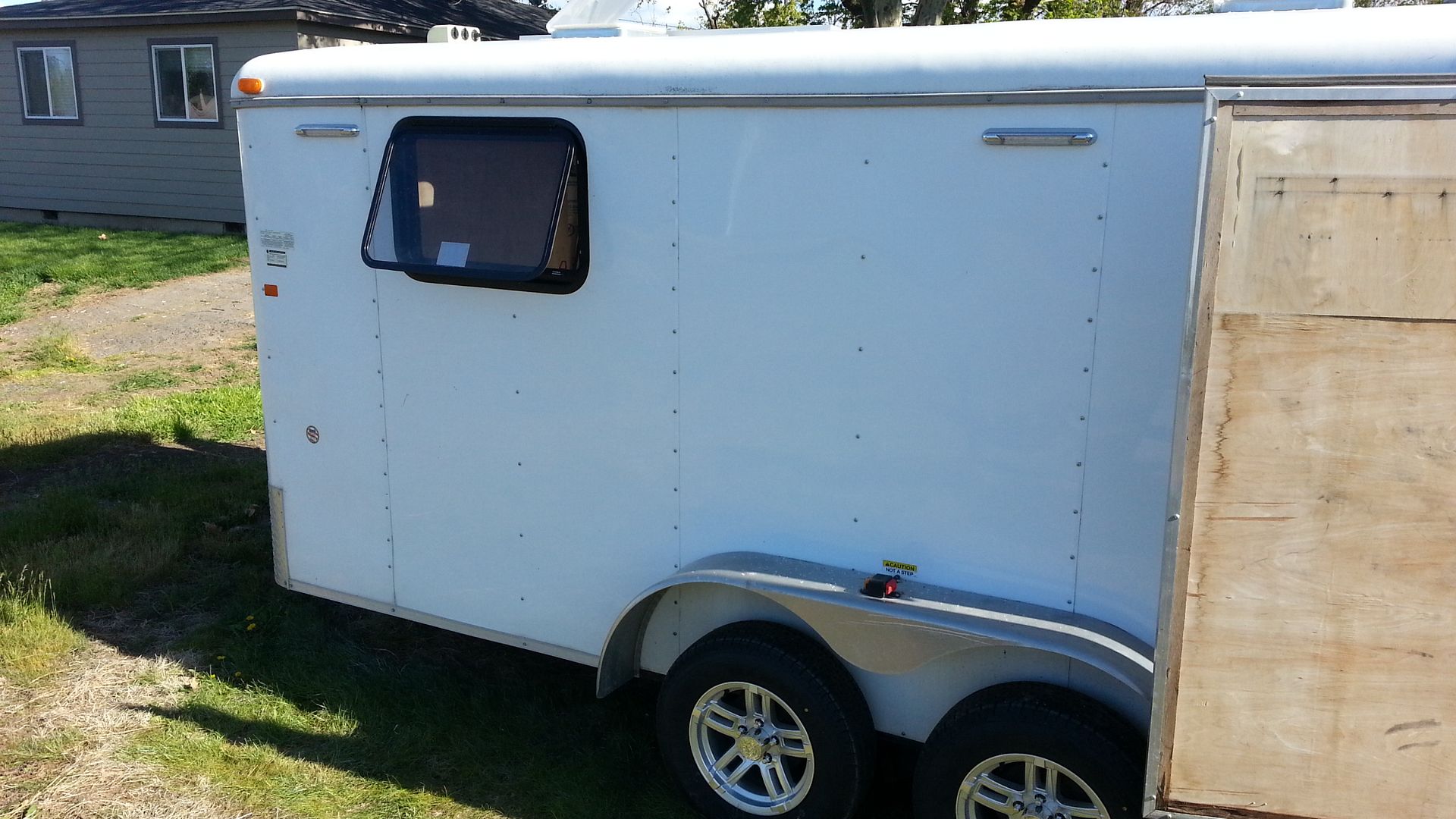

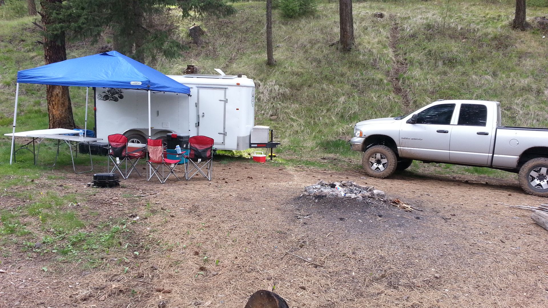

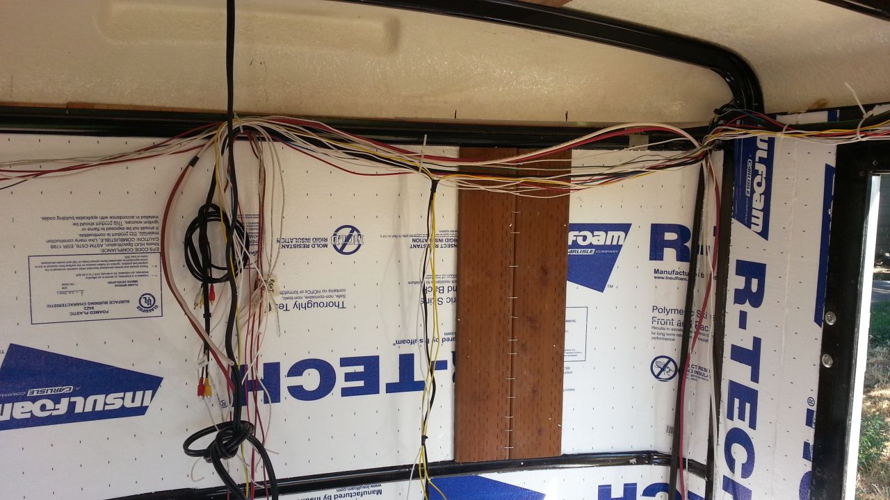

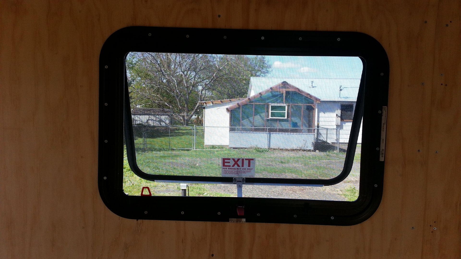

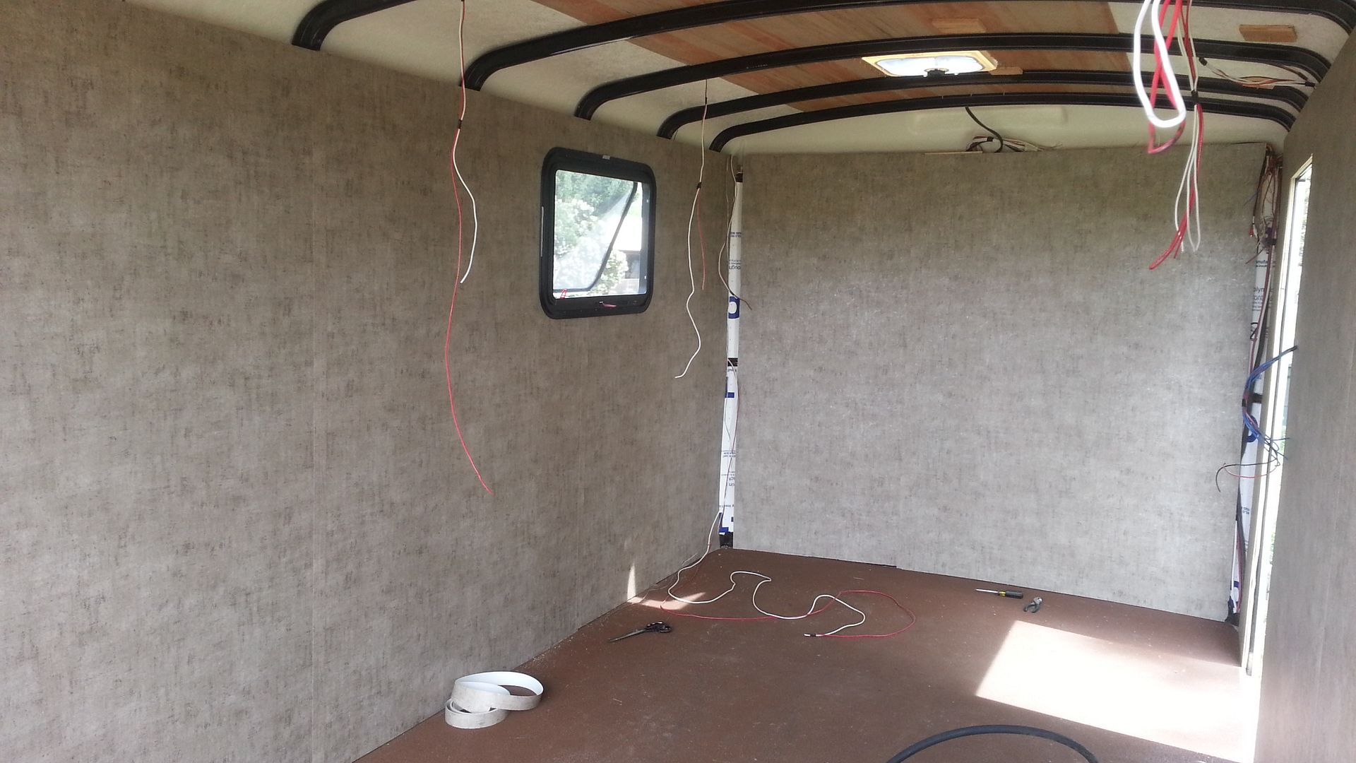

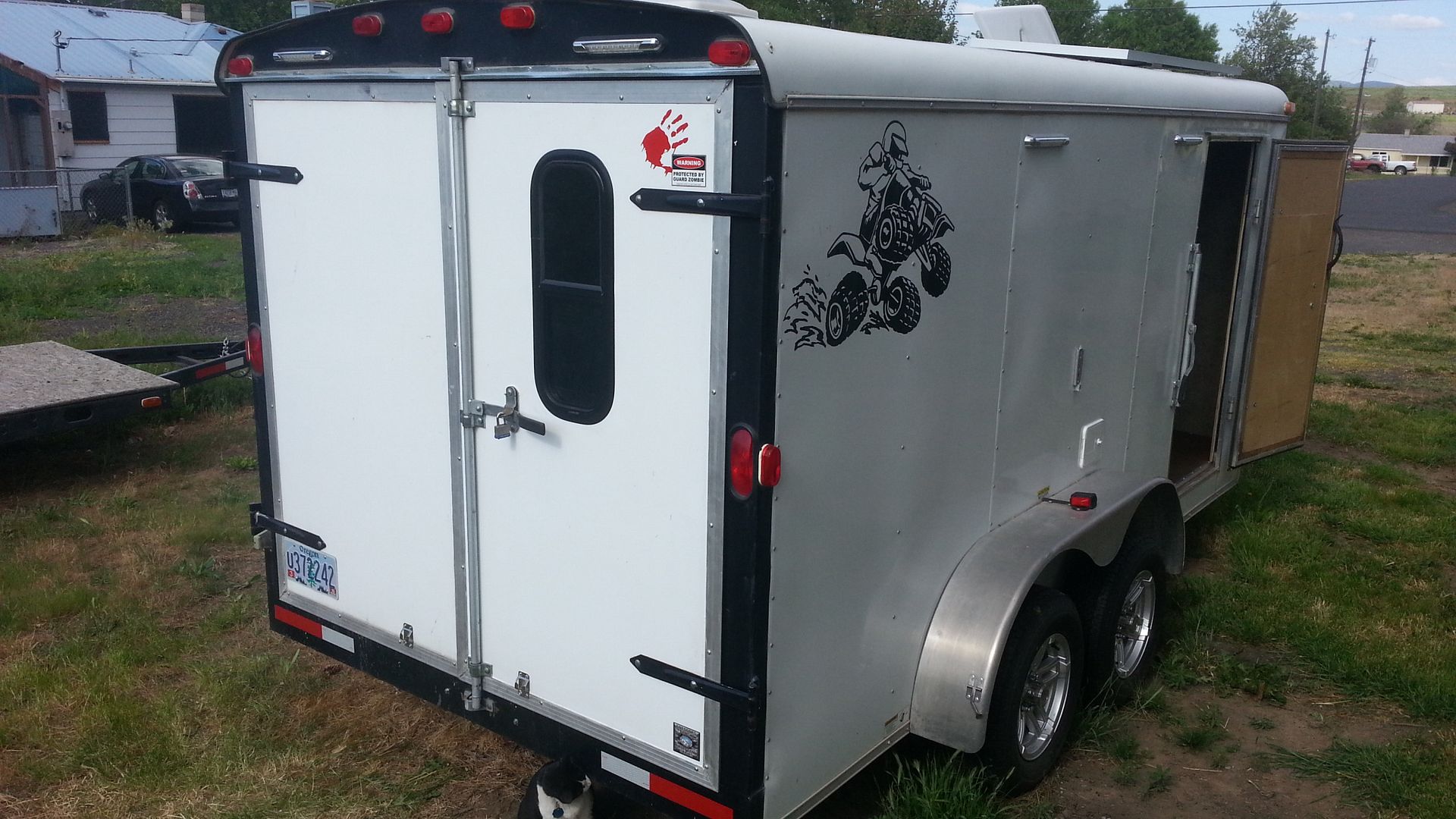

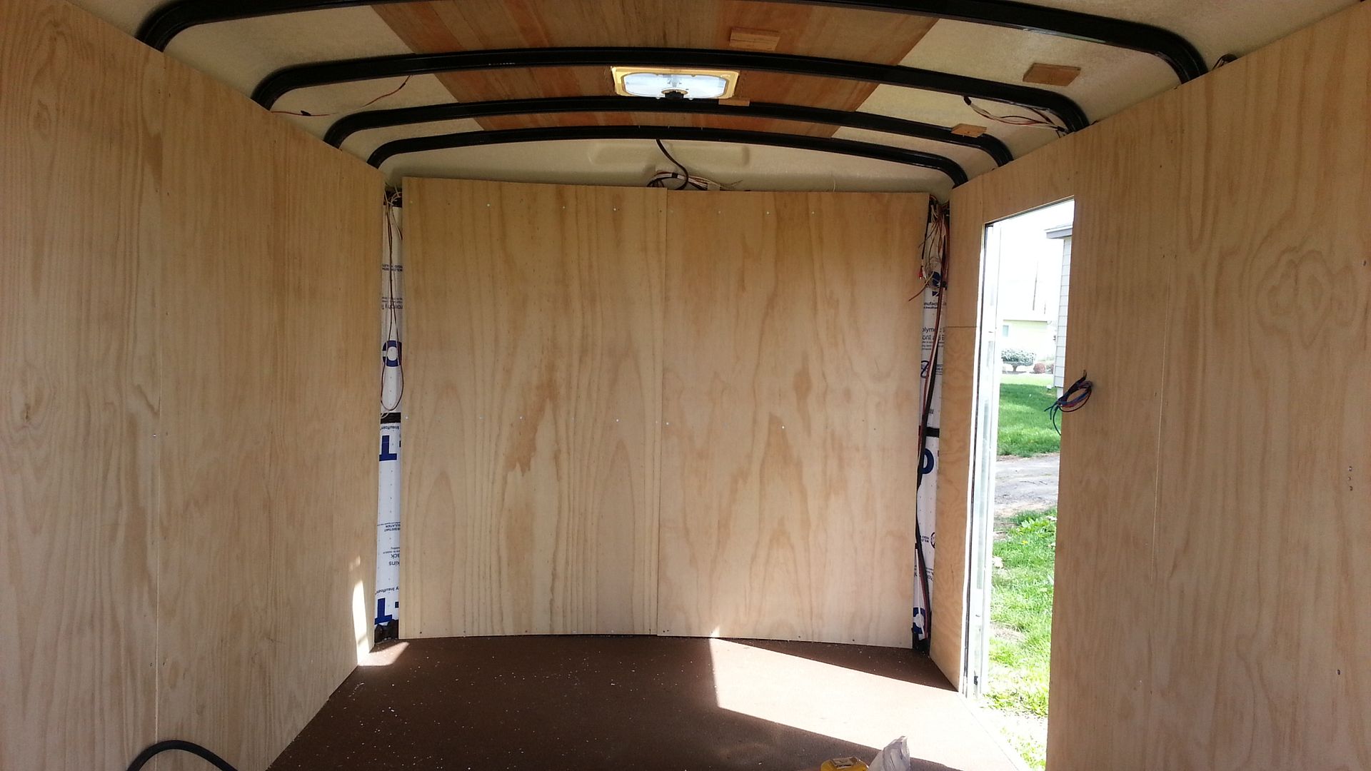

Well the weather has finally turned nice. Time to break out the tools and get back to it.
Finished insulating the walls. Added blocking in the front wall for swing-out tv mounting. Got the underlayment panel up and one window installed just in time for an early season camp-out with the new tow rig. Next will be the decor paneling and storage cabinet and bed.

Postby Rainier70 » Wed May 14, 2014 11:57 am
Looking good. I like your window, do you mind if I ask where you got it?
Rainier70
Posts: 1083
Images: 244
Location: Southeast Idaho
Re: Quadriderdad's 7x14 toyhauler
Postby Quadriderdad » Thu May 15, 2014 6:28 am
Rainier70 wrote:Looking good. I like your window, do you mind if I ask where you got it?
Hi Cindy!
Lucky for me I work at an RV Manufacturer (Outdoors RV Mfg. in La Grande, OR) so I can get all my stuff for cost. It is a window that we use on our low end product.

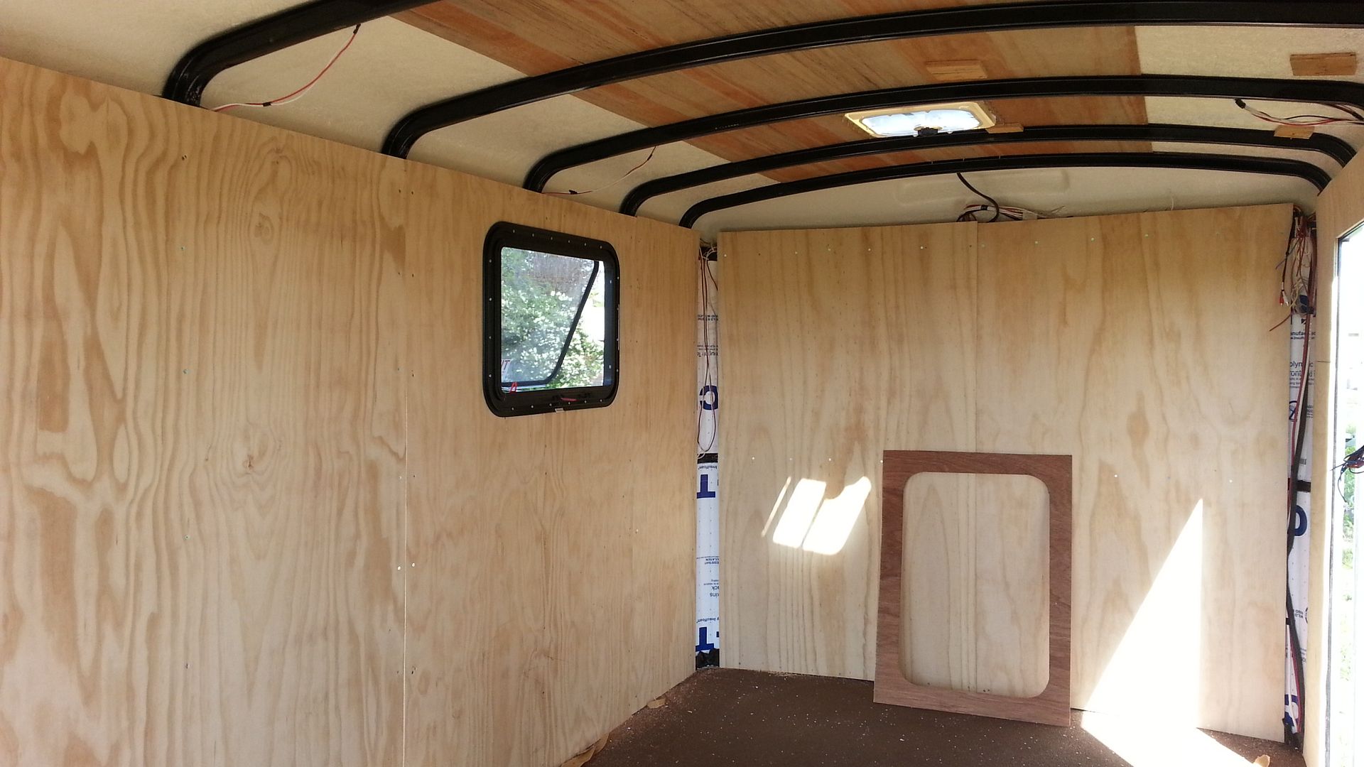

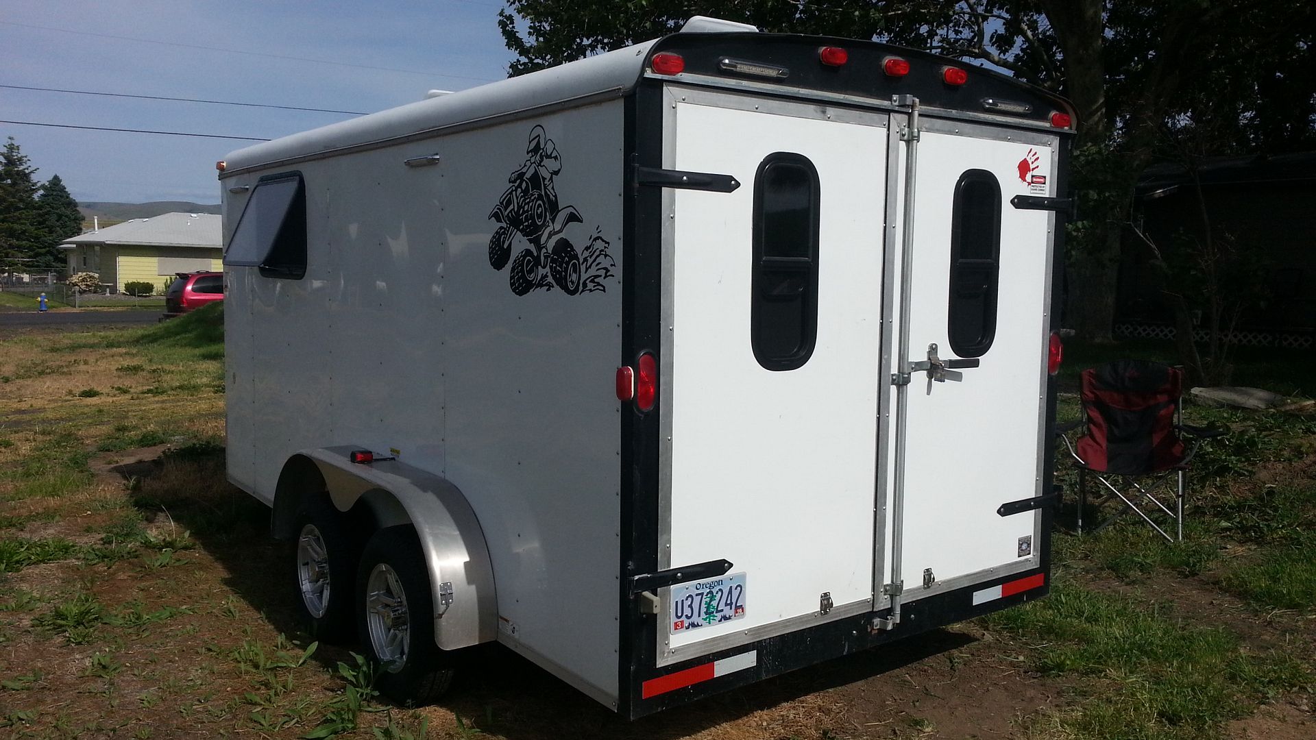

Postby Quadriderdad » Sat May 17, 2014 8:33 pm

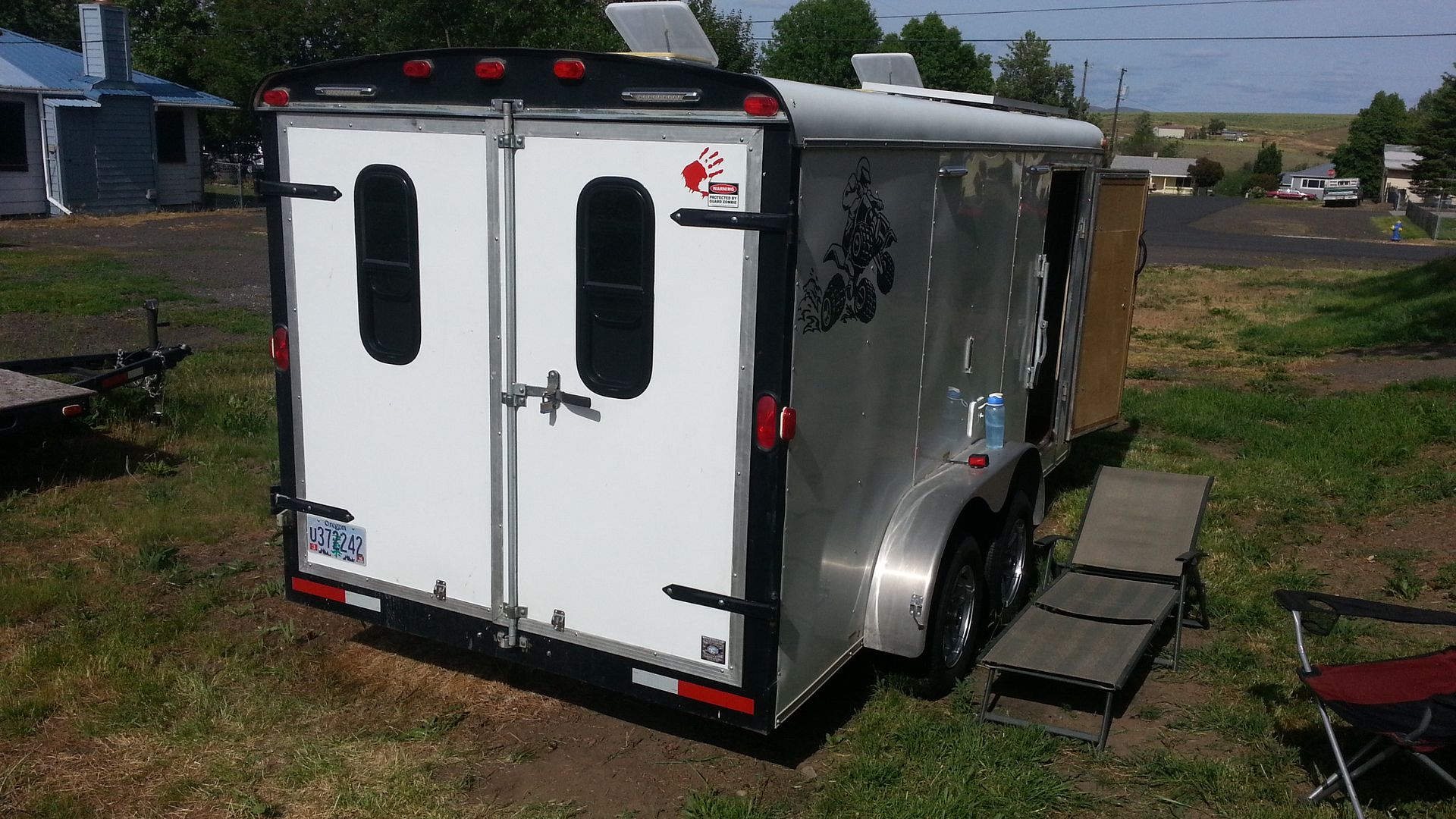

Paneling installed and put in one of the rear windows today. Still have two more of these to install on the doors...

flboy wrote:Looks good! You never get done with the conversions. Always something more to do. :-) How is your solar panel working for you?
At the moment it is just sitting there doing nothing. I don't have all the electrical complete and no batteries as of yet. I'm going to add two more solar panels before I close up the ceiling...another 150W and a 5W that I have had sitting around for years.

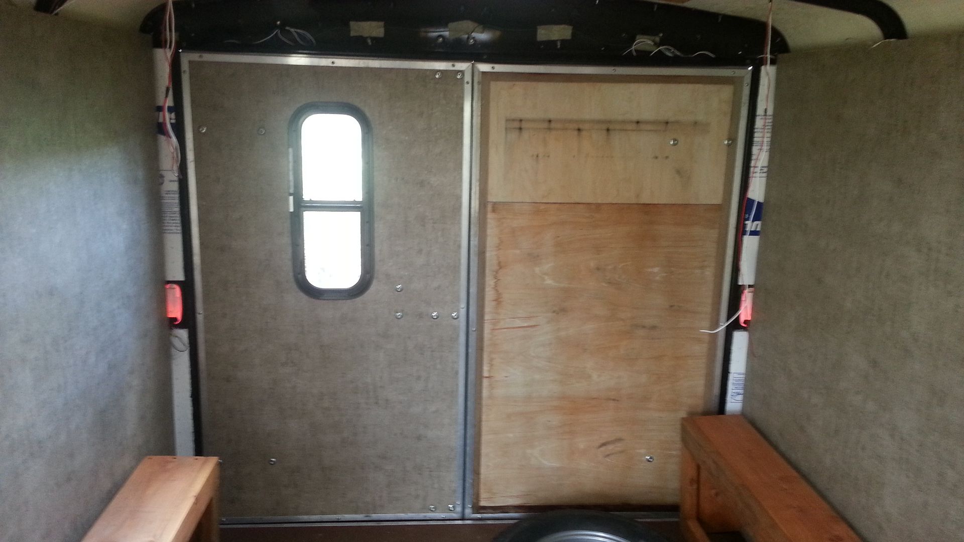

Postby Quadriderdad » Sun May 18, 2014 11:10 am
hankaye wrote:Quadriderdad, Howdy;
Truly enjoying watching your build come together. I forgot to ask
earlier, what have you been using to cut the holes for the windows?
hank
Hi Hank

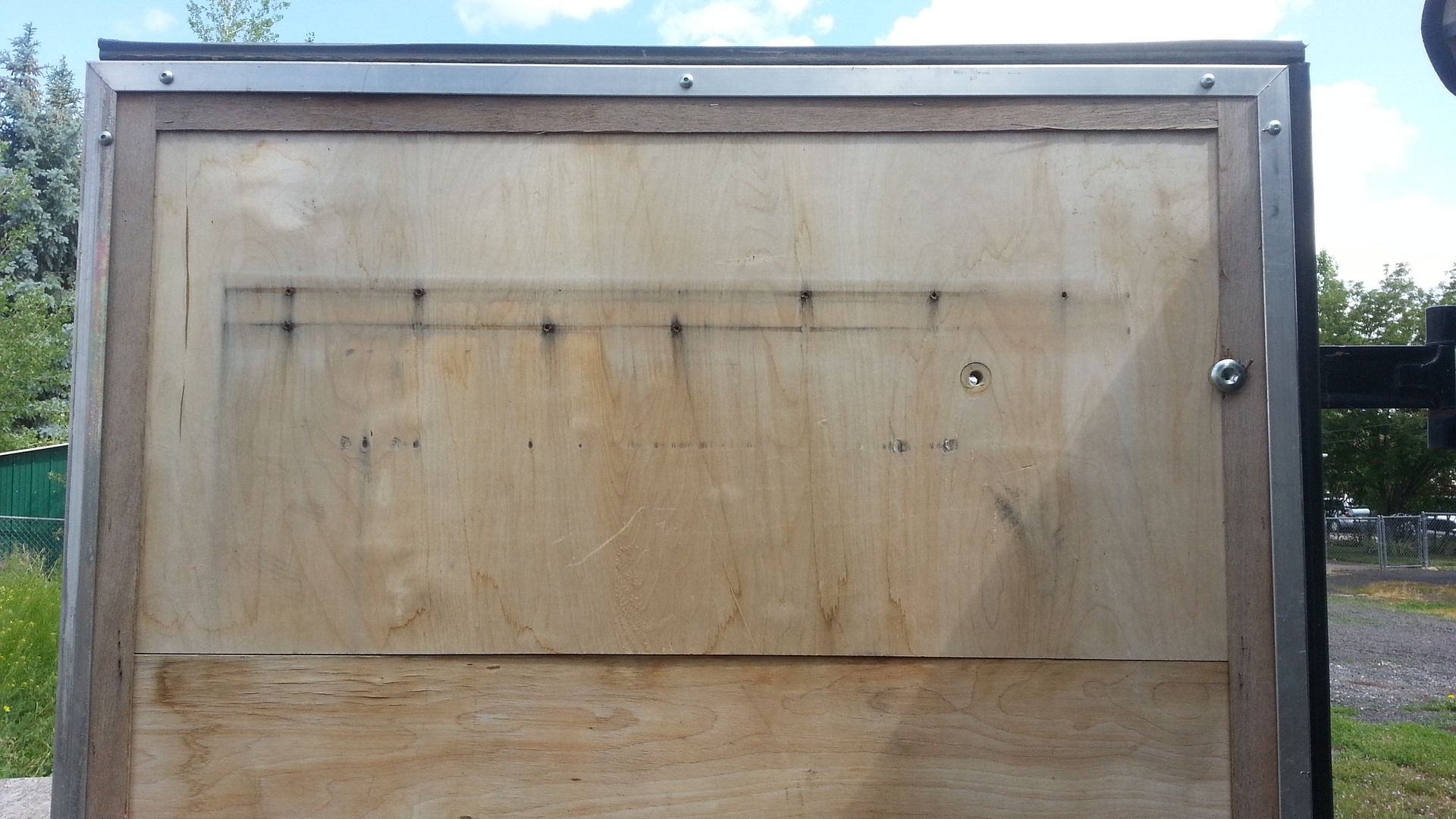

Well the window on the wall I used a router which is very slick and makes a clean cut hole. This was do-able since the window is framed in. On the door I used a jig saw 'cause the door is solid plywood. I forgot to take pictures of the door rebuild/window install. I'll get some on the next door I do. I decided to rebuild the doors. They were kinda flimsy and after taking one apart I can see why...They cheaped out and made the door from two pieces of ply instead of one solid piece and none of it was glued or anything. Just held together with the side extrusions. So I beefed it up, added my interior panel to match and cut the hole for the window while I was at it.

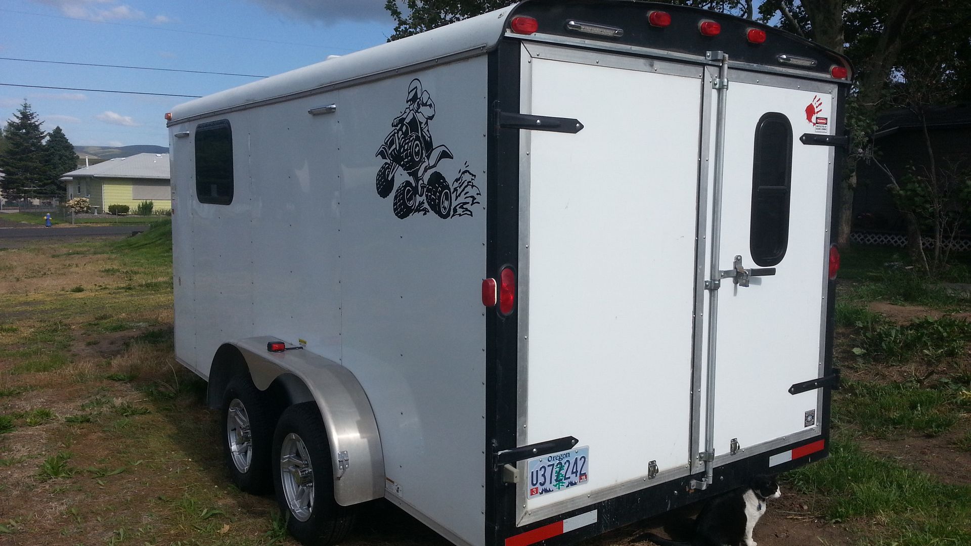

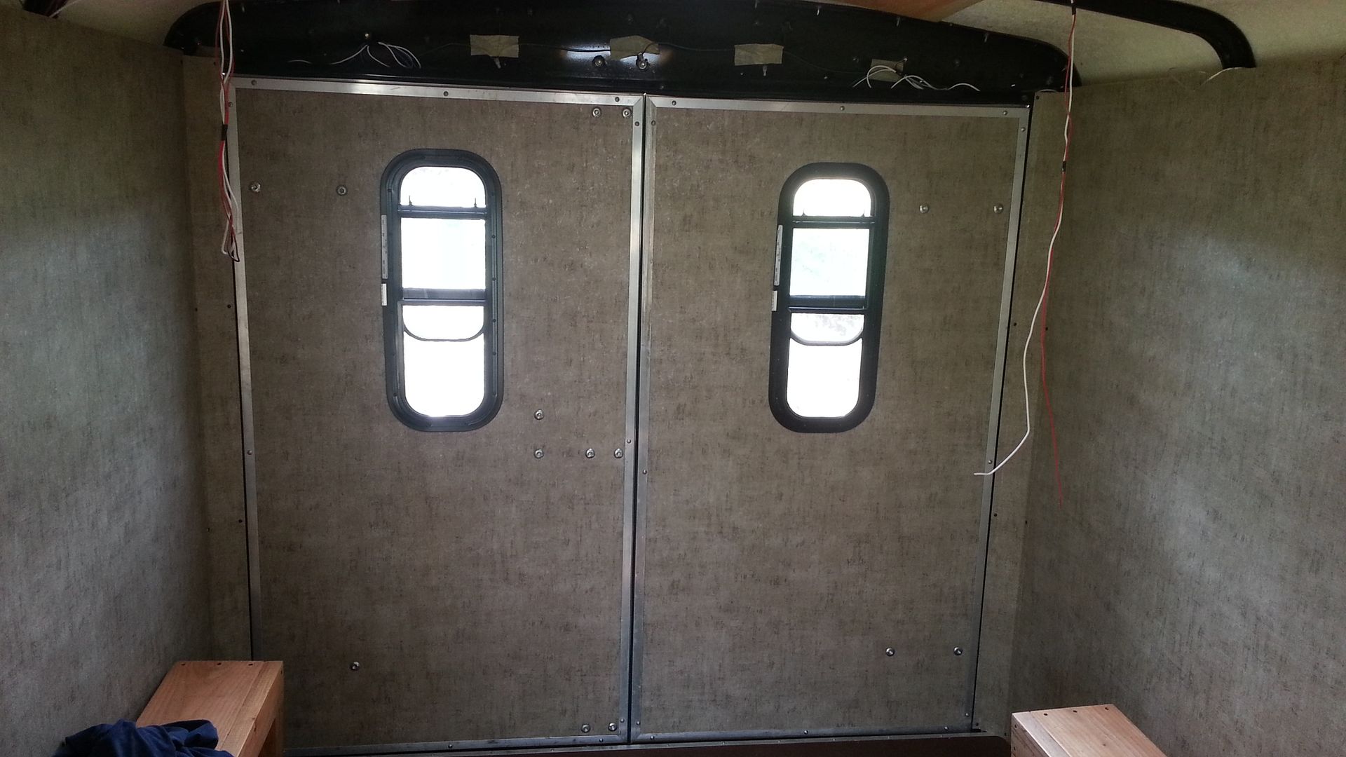

Postby Quadriderdad » Mon May 26, 2014 8:39 pm
Got some more work done over the three day Memorial weekend...
Starting to feel like my efforts are finally coming together.
Got another window in the rear doors...
Pretty cheap that they spliced plywood for the doors!! In the beginning I thought the doors were gonna be foam insulated and that it was just the inside skin that was spliced but nope.
Door apart with window cut out...
And done...

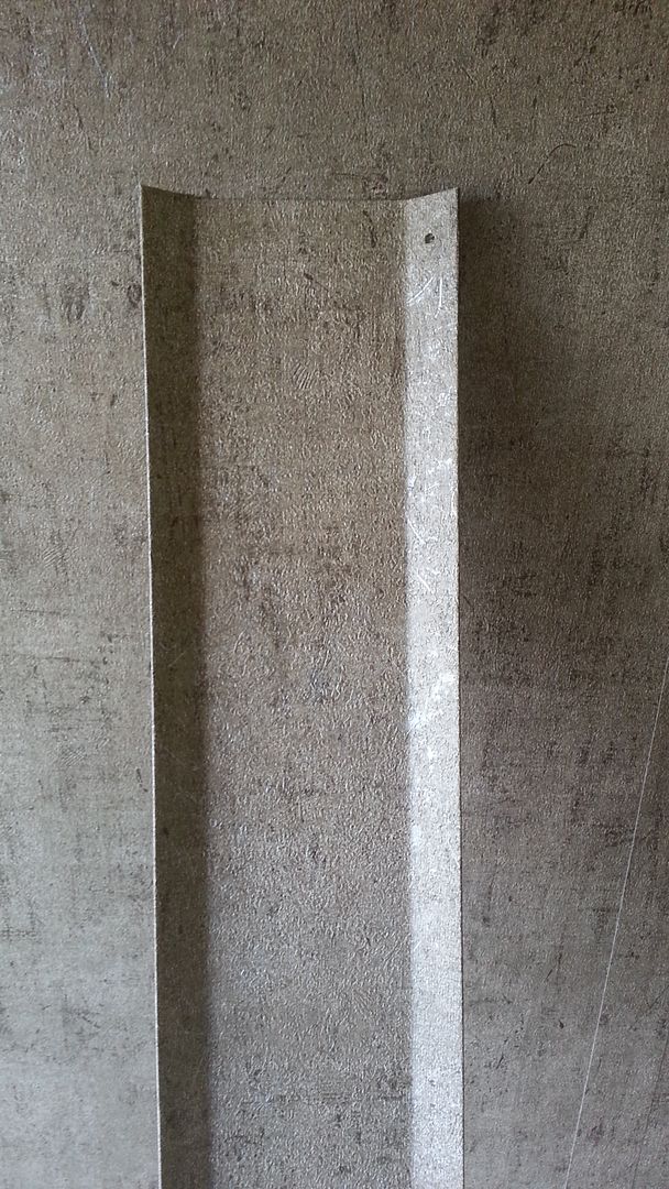

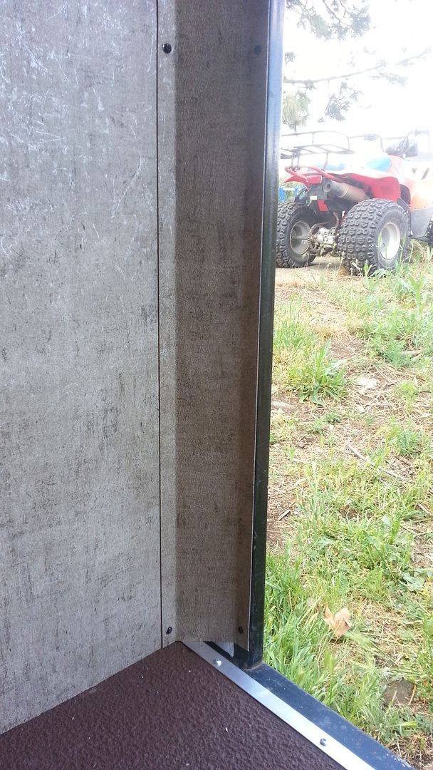

Postby Quadriderdad » Mon May 26, 2014 8:44 pm

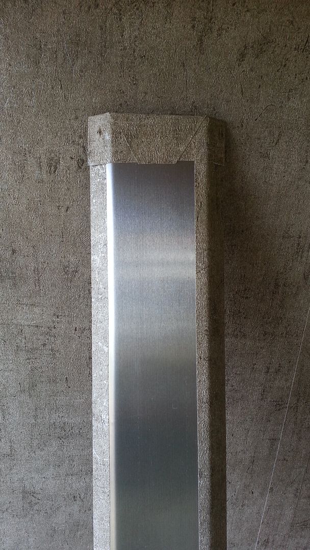

Finished corners...
I wrapped the metal corners with an adhesive paper that matches the interior paneling...
The front corners I am leaving loose until I know that I have all the wiring from the batteries and solar array complete.
Postby Rainier70 » Mon May 26, 2014 10:52 pm
Very nice.
I have thought about opening up my doors to insulate them and brace for a door lock. Were they hard to get apart? Did you open up the inside or the outside? Any does or don'ts that you ran into? Difficult to get rehung and aligned?
