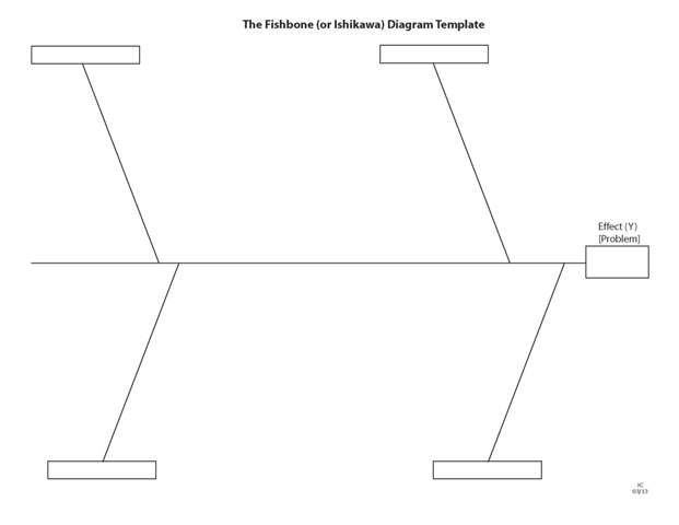

The great part about this type of analysis is that you can continue with the questions and you decide, add, change, and decide again on where you want to go... so, as you can see below, I added a couple thoughts that you have already been looking into... Anyway, you have the idea and just need to work out the details :thinking:
I used to teach and work a lot with problem solving issues and have a Fishbone chart that I will add (maybe you and others would like to look at it); this is not my idea, but redrawn for clarity. If you have not used these before, modify the model to suit your needs. For example, change "Problem", at the right, to Trailer and then insert additional (NEEDS) as needed. There are currently 4 NEEDS; take the NEED box at the upper left and call it "BEDs", and then insert on the line below the BED box INPUTS, e.g., bed for self (how large do you need?), bed for kid 1 (probably single), bed for kid 2 (probably single), bed for other adult (probably a single), etc. and a short note of the details like SELF - SINGLE, KID 1 - UPPER BUNK, KID 2 - LOWER BUNK, and so forth. This works out as a pictorial that helps you add the NEEDS and the INPUTS or details regarding the needs. You can look these charts up online and see different ideas on how they can be used to solve problems (In this case, your trailer size and accommodations). Anyway, hope this helps and you are welcome to IM if needed... 8)
zroadhouse wrote:I think this is actually very helpful.
1) The ability to haul my motorcycles to the track, have a place to escape the heat, and be able to camp out there. Additionally, I would like to be able to take some short trips to nearby camping areas for downtime. Great, as I read this, it sounds like you are probably going to use the trailer for two uses ... (A) Track trips which are short stays (I am guessing)at 1 - 3 days and nights (Thursday night through Sunday evening) and (B) camping with friend/family member and maybe your kids.
2) I want to be able to haul 3 motorcycles (2 sport bikes and 1 pit bike). I'm sure I could do this in something as small as 6x12. (A) Hmmm, can you load the bikes 3 abreast or will you have to park 2 abreast and one in front/behind the others? (B) Will you need to load the bikes back in the trailer at night [this could really affect the sleeping, galley, wash, and eating areas.
3) I usually make it to the track 2 weekends a month Yep, see 1) above.
4) I'd rather have an awning - I don't anticipate spending too much time in the trailer other then to rest, hang out (when too hot or wet out)
5) Highway use mainly - I don't anticipate going "offroad" other than in grassy/gravel fields they have near the tracks - or dirt roads for camp grounds
6) I usually bring a friend/family member with me and may want to bring my kids. (Kinda argues for multiple sleeping locations) I have seen some CT on the T&TT site that talks of bunk beds for the kids and there are a couple of sites that sell bunks for RV's (a bit spendy for my taste, but they offer an option and ideas)
7) I'd rather not have to drive to a storage facility to pick up the trailer - being able to store it in my driveway and not have it take over my house would be a plus. This, of course, depends on where you live and if there are association rules that you need to comply with ...
Hmmm, I'll keep thinking.
Fishbone Basic Template.jpg (12.14 KiB) Viewed 2587 times

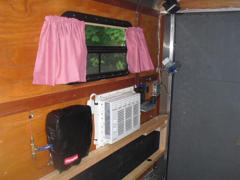

Postby Glenlivet » Sun May 11, 2014 6:28 pm
One thing occurs to me, if you have an idea to use a 5500 BTU window shaker A/C that runs on a carriable 2000 watt genny then you can side mount it in a six footer and it's still less far out a side than the wheel fender. Mine sticks out 7 inches with all the condenser vents out in the air while the wheel well is out 11 inches. With a seven foot wide the A/C will stick out further than the wheel fender.
Not a deal killer mind you, it's still just 7 inches. The canopy sticks out four. :)
