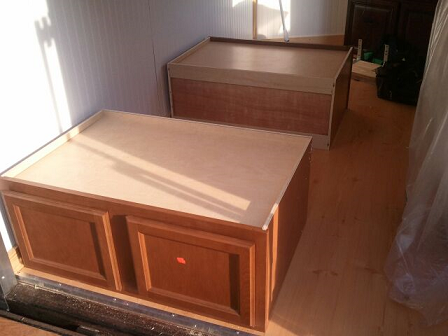

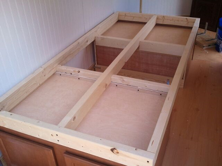

Did the bed today. Bought two cabinets on sale for $20 each (normally $200 ea) to use as risers for the bed. The cabinets are 36"w x 24"d x 15"h. I cut a piece of 3/4 ply to the size of twin bed and it will span the two cabinets. The cabinets will be screwed to the floor and wall. The rear cabinet will be accessible from rear and will hold coleman stove n other kitchen stuff as well as tie downs and other road stuff. Plan to have a head board of sorts that will have a folding/dedtachable table to the rear to function as kitchen counter. Front cabinet will probably hold clothes, etc and there will be room for 4 tubs under the bed between the 2 cabinets.
twin bed
pace 6x10 bed 1.png (225.51 KiB) Viewed 1213 times
Local building supply store had these two cabinets on closeout.
pace 6x10 cabinets for bed.png (227.05 KiB) Viewed 1213 times

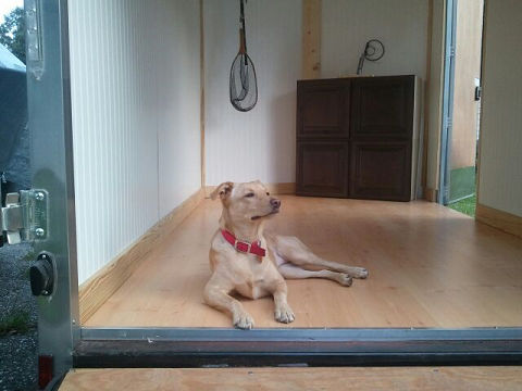

Felony....my new dog...chillin n waiting on the bed
pace 6x1o interior felony.png (255.17 KiB) Viewed 1213 times

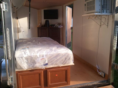

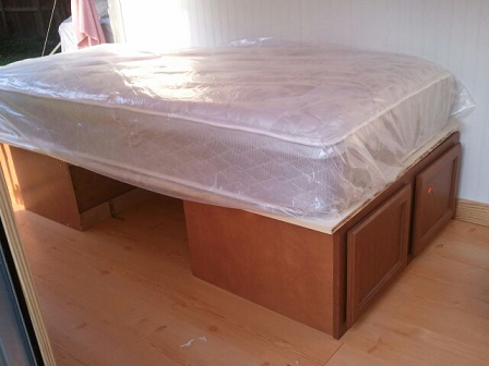

Postby willfish4fud » Mon Jul 28, 2014 8:45 pm
More bed pics. Plan to make some changes tomorrow. Going to raise it a few inches for more room underneath and to provide some "hidden" storage

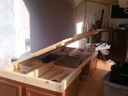

Postby willfish4fud » Tue Jul 29, 2014 4:36 pm
Added a frame of 2x4's to raise bed height a few inches. I needed clearance for tubs underneath and it provides for some hidden storage of sorts
pace 6x10 bed frame.png (232.43 KiB) Viewed 1153 times

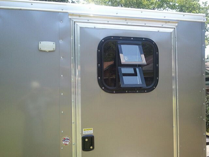

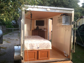

Postby willfish4fud » Thu Jul 31, 2014 3:08 pm
Scored this window for $25 and installed today
pace 6x10 window installed.png (198.39 KiB) Viewed 1109 times

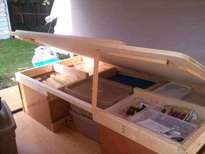

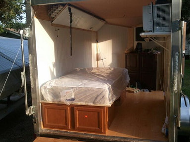

Postby willfish4fud » Thu Jul 31, 2014 8:44 pm
under bed storage
pace 6x10 bed storage.png (214 KiB) Viewed 1083 times
pace 6x10 bed storage 2.png (219.49 KiB) Viewed 1083 times

Postby lrrowe » Fri Aug 01, 2014 12:49 am
Nice compartments for storage. I plan on making every nook and cranny work as storage of one sort or another.

Postby hankaye » Fri Aug 01, 2014 9:54 am
willfish4fud, Howdy;
When I was in the Navy, we called our beds (racks), that had under storage like that
"Coffin Racks", they were about 6 or 7 inches deep and that's where we were able to store
all of our 'stuff'', that and a shirt sized hanging storage that was about 6" wide. Memmmmorieeeeees :frightened: , :lol:

Postby Rocky5000100 » Fri Aug 01, 2014 10:30 am
I like the "hidden" storage under the bed. Good use of space.

Postby bc toys » Sat Aug 02, 2014 7:00 am
Liking you build but got to ask where did you score the cabinets and window I started my build the other day and I want under the bed storage and like yours
bc toys
Posts: 2217
Images: 42
Location: LAS VEGAS NV
Re: New member and new build in MS
Postby willfish4fud » Sat Aug 02, 2014 7:24 am
bc toys wrote:Liking you build but got to ask where did you score the cabinets and window I started my build the other day and I want under the bed storage and like yours
The cabinets came from a local building supply store (Hoods). they are real plywood and not particle board so they have the strength to support the bed. I got 5 cabinets for $20 each. the normal retail price was over $100 each. They are all wall cabinets. The ones in the front of trailer are 12" deep and are 18" tall by 36" wide. The ones under the bed are, I think, normally used for over refrigerator. They are also wall cabinets but are 24" deep and 15" tall by 36" wide.

Postby willfish4fud » Sat Aug 02, 2014 7:26 am
hankaye wrote:willfish4fud, Howdy;
hank
I have seen that before. Wish mine was a little deeper. I ended up with about 5 inches and one or two more would've been nice

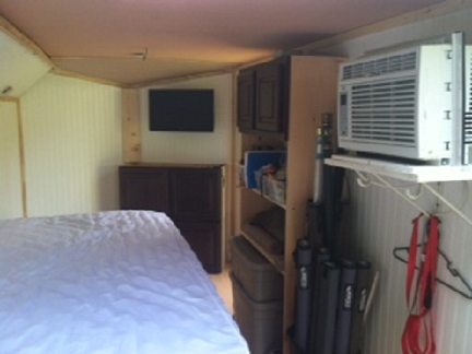

Postby willfish4fud » Thu Aug 07, 2014 10:52 am
Used another of the wall cabinets and installed it with some shelves yesterday.
