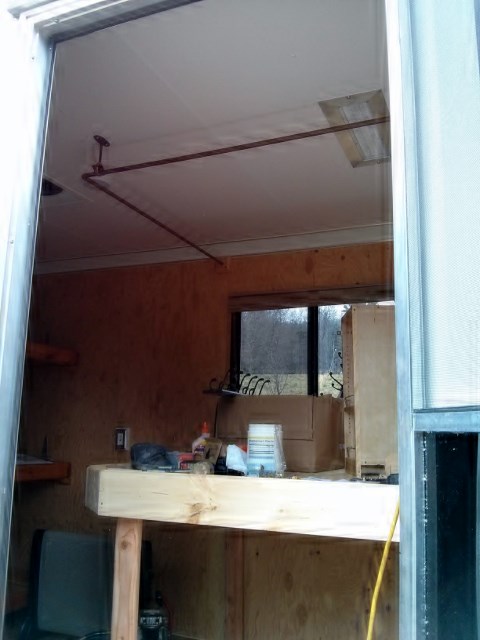

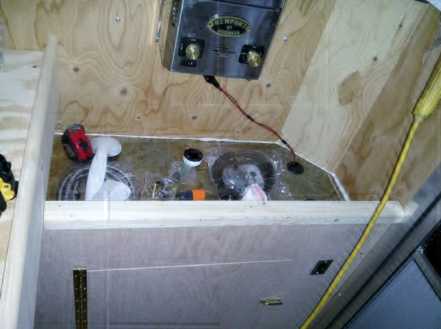

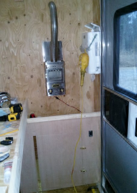

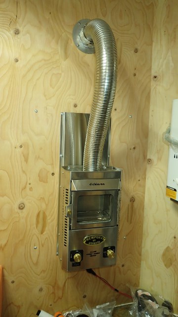

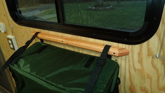

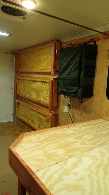

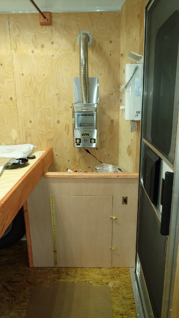

Made some progress Saturday with mounting the Heater and Water Heater, wiring them in, building a cabinet, and fitting the curtain rod for the curtains that go around the master bed:
Rod (480x640).jpg (75.19 KiB) Viewed 3238 times
Heater (455x640).jpg (80.04 KiB) Viewed 3238 times
Cabinet (640x478).jpg (86.93 KiB) Viewed 3238 times

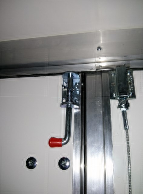

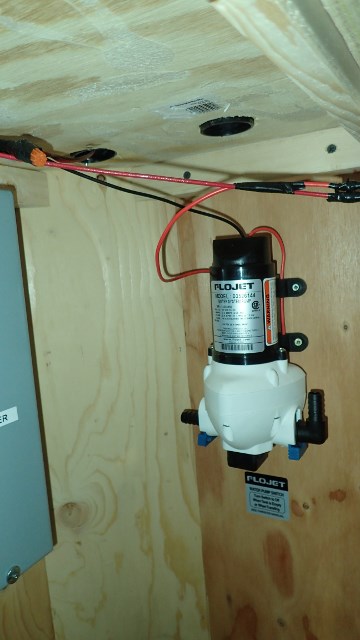

Postby outsidezion » Sun Dec 21, 2014 12:18 pm
Rod Heater Water (640x468).jpg (87.15 KiB) Viewed 3237 times

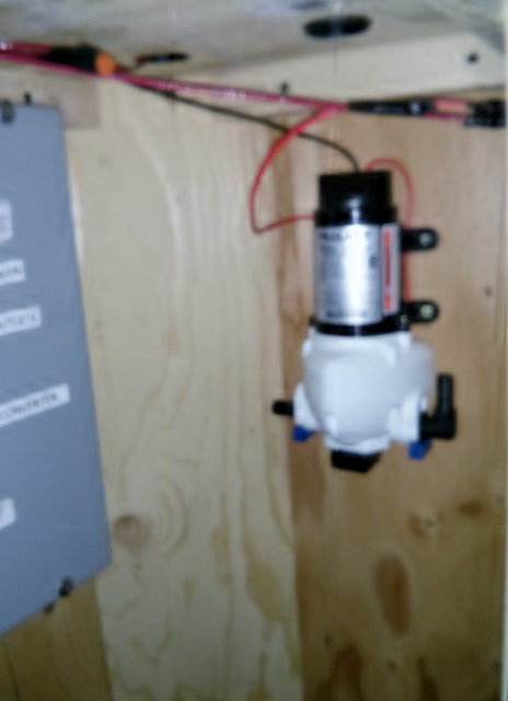

Water pump (464x640).jpg (55.92 KiB) Viewed 3237 times
Door latch (472x640).jpg (64.72 KiB) Viewed 3237 times

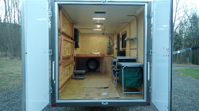

Postby outsidezion » Fri Dec 26, 2014 5:27 pm

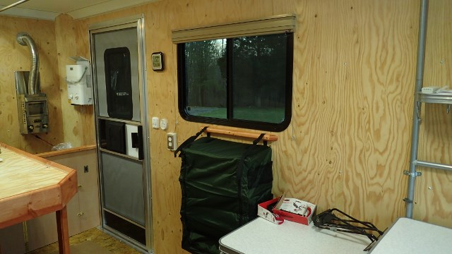

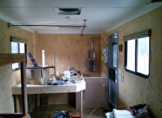

Well, Round 1 is just about done but for a coat of Poly here and there. I have a number of little accoutrements to be added and sorted out but we could go camping in the snow if we wanted.
Rear full.jpg (101.32 KiB) Viewed 3157 times
Fear Front.jpg (80.92 KiB) Viewed 3157 times

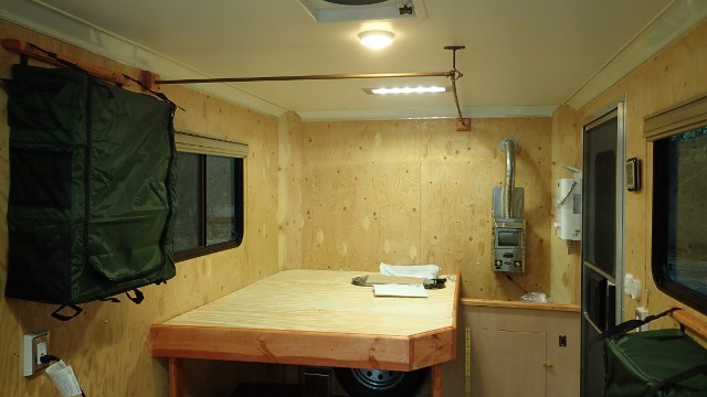

Postby outsidezion » Fri Dec 26, 2014 5:30 pm
Facing rear.jpg (77.63 KiB) Viewed 3157 times
Facing rear 2.jpg (81.21 KiB) Viewed 3157 times
Hanging shelf mount.jpg (86.97 KiB) Viewed 3157 times

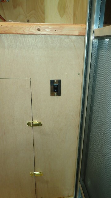

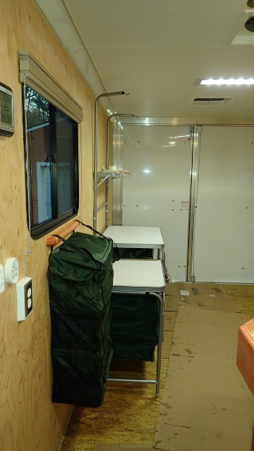

Postby outsidezion » Fri Dec 26, 2014 5:37 pm

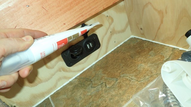

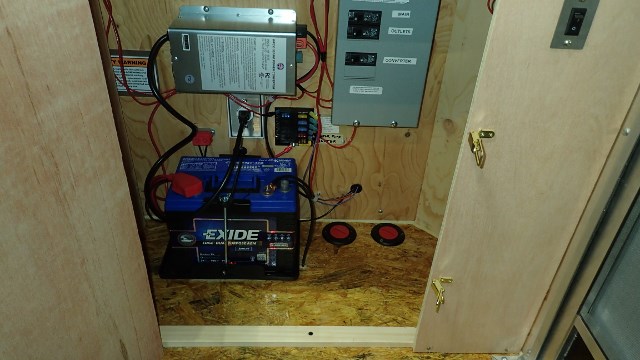

Electronics and the 2 propane fill ports (Thanks, Cindy!) for the propane hose:
USB Ports
USB Ports.jpg (90.04 KiB) Viewed 3155 times
Water Pump Switch
Pump switch.jpg (78.7 KiB) Viewed 3155 times
PA Wilds Bug out Trailer 16 x 7 x 7 Aluminum: http://www.tnttt.com/viewtopic.php?f=42&t=61833

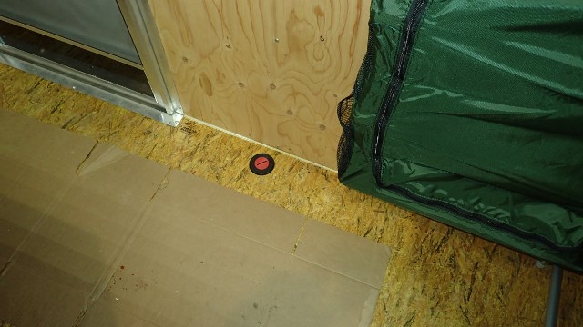

Fuel fill port (Thanks again, Cindy!) for the propane stove at the kitchen:
Curbside propane port.jpg (87.8 KiB) Viewed 3155 times

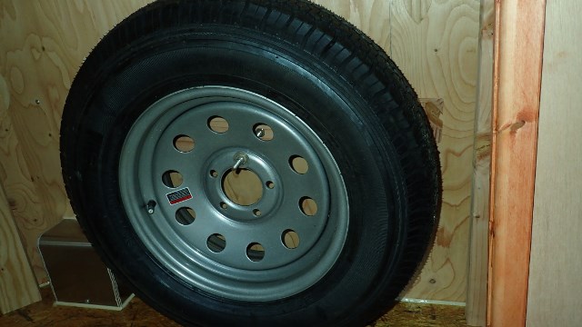

Spare tire mount, front wall under the main bed:
Spare Tire Mount.jpg (85.45 KiB) Viewed 3155 times
Water Pump for the prone water heater and any other use we might need it for:
Pump Water.jpg (77.19 KiB) Viewed 3155 times

Postby outsidezion » Fri Dec 26, 2014 6:37 pm
Spotman wrote:where did you find the green storage bags? Fits what I may need.
Bob: http://www.cabelas.com/product/Creek-Company-Hanging-Camp-Cupboard/746707.uts Rather salty but heavy duty. You get the strength of real shelves with the light weight of fabric.

Postby outsidezion » Fri Jan 02, 2015 6:46 am
Rainier70 wrote:
I didn't see the waterheater mount before. Is that a "transport" location? Where do you hang it to run?
Cindy, I will post pics of the finished water heater. Its permanent but it easy to move I'd needed. The L5 works with a garden hose (existing pressure source) or my own pump and a bucket of water.

Postby Rainier70 » Fri Jan 02, 2015 9:37 am
Just a word of caution on the water heater. Be careful of the exhaust. That is a lot of carbon monoxide to be putting into a small living area. If it was me and I wanted to permanently mount it there, I would do a sheet metal duct on top of the heater so that it vents outside.
A CO monitor is always a good idea too.
Love your build!
